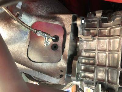

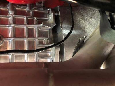

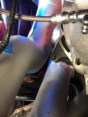

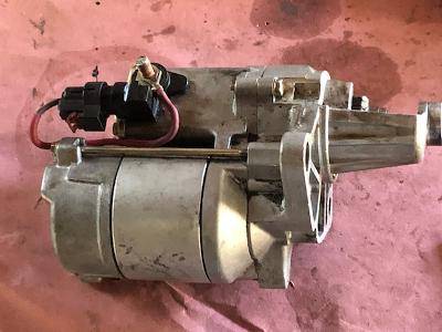

It is hard to see your starter, but it looks like a full size starter. If it is, you should go with a mini starter, say one from a Dakota truck, etc. I think TTI states they are needed on their web site. With the limited clearance you have, I would be concerned about heat and the starter.
Good luck!
