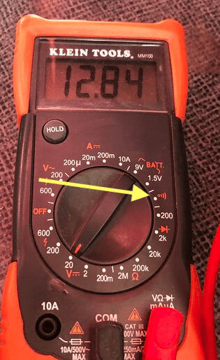

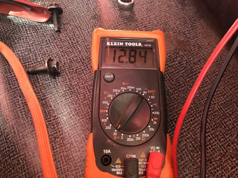

I have this. I have mainly used it to test battery voltage.
I have fumbled through many things with cars but never had a knack for electrical stuff.
If you use the setting with the arrow pointing to it, connect the leads the meter should beeeep, connect the leads to the wires coming from the switch when the contacts are closed the meter will beep..
