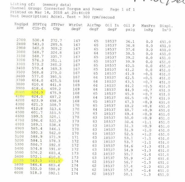

Did my 451 with TF240 worked over the heads so they work really nice I specked a nice SFT that I had Howards cut it Eddy RPM intake QFT and got great results, Pushed my 4200# 79 Magnum into solid 11:60's and fun to drive with power brakes as well
Did my 451 with TF240 worked over the heads so they work really nice I specked a nice SFT that I had Howards cut it Eddy RPM intake QFT and got great results, Pushed my 4200# 79 Magnum into solid 11:60's and fun to drive with power brakes as well View attachment 1361175
Very nice output.

Nice job. Everything in that motor must be jelling together. Those are crazy #'s for a 451.
