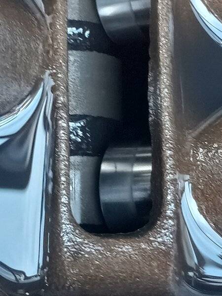

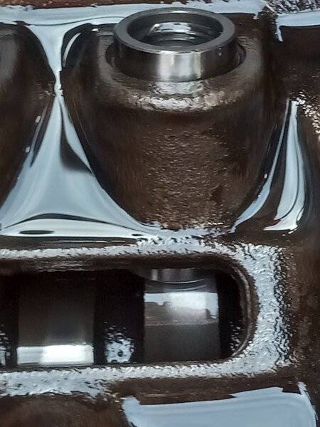

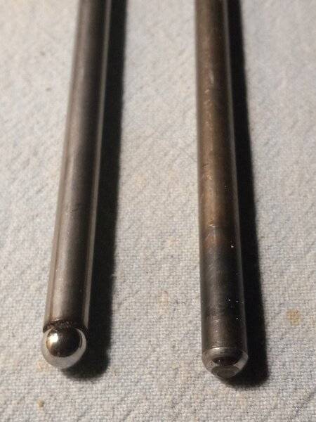

You might want to get an adjustable pushrod and check the length that you should have with your set-up.
Keep the lifters in order so they go back where they were if you pull them.
