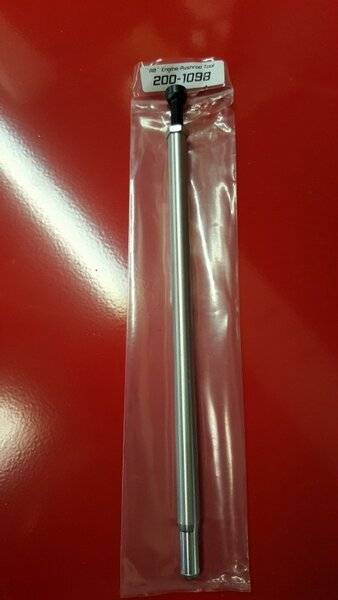

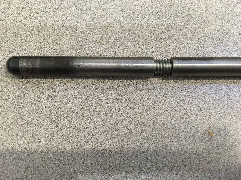

Thanks. Any info on how to do this?Check the amount of lifter preload with the current pushrods...... buy new pushrods in a length that will improve that situation if deemed necessary.
One of the old hollow pushrods can be sacrificed to make it an adjustable checking tool.

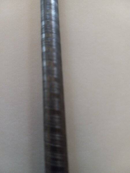

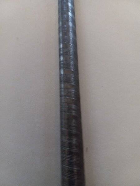

Can't tell from the pic, but it's bent about 1/8".The valves will just open a bit until the spring load collapses the lifter.
After that point, with the lifter on the base circle of the cam....... the pushrod will spin pretty freely.
How about a pic of the most bent pushrod?
