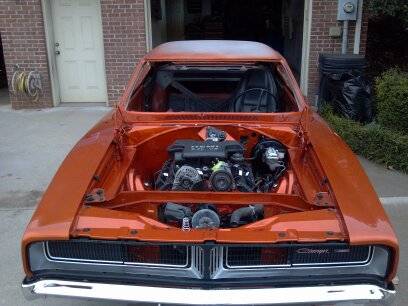

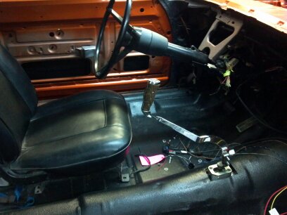

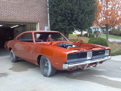

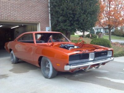

Its taken the better part of two years,but it is in. I was surprised at how well it went in, it fit better than the big block in my 73 Charger. Got a long way to go put a fuel pump and radiator and it will be running around the neighborhood. Just wanted to show how its going.

Very nice!!! I love the car ****, so could ya post more pics?
Looking good!!! What transmission are you using? some other questions. what did you do for clutch pedal and clutch setup?
Thanks
I put one of Keislers RS500, 5 speeds, the pedals are stock 69 b-body with Keislers hydraulic clutch set-up. I wanted to use the factory 6 speed out of a new Challenger but with the starter on the right side the headers would not fit. Plus all the other problems with the tunnel and speed o. So far the trans has been the most expensive part including the price of the car.
Looks great. How complicated is the wiring on a swap like that?
So far not to bad but, I have not got it started yet. I got the engine harness an computer can from Hotwire. I plan on wiring it into the factory harness.
