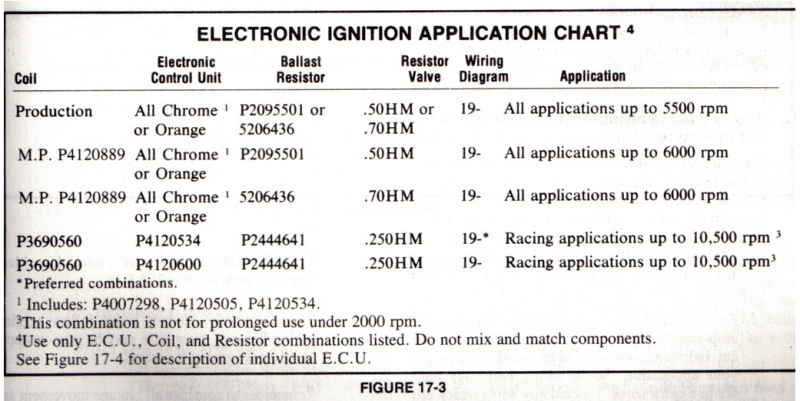

It is extremely important that the coil and chrome box be compatible. Arbitrarily mix matching the coil and ECU or Electronic Control Unit, aka chrome box, will lead to a failure of the ECU, coil or both. The same is true of the ballast resistor....every component must be compatible. See the chart in #7's posting. Electronics can be fickle....they function today but not tomorrow and usually will fail at the most inopportune time. I'm sure others will have their own preferences and opinions and say all this doesn't matter. Electronics are wonderful....except when they don't work...... Just my opinion of course.....

Daves69 - thanks for posting the application chart.
I wanted to by-pass the ballast so the coil would get a full 12 volts.
I'll have to go with the proper ballast if I can find one.
