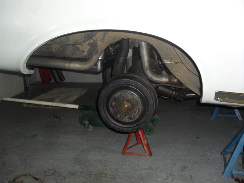

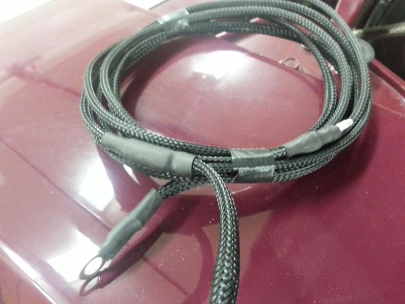

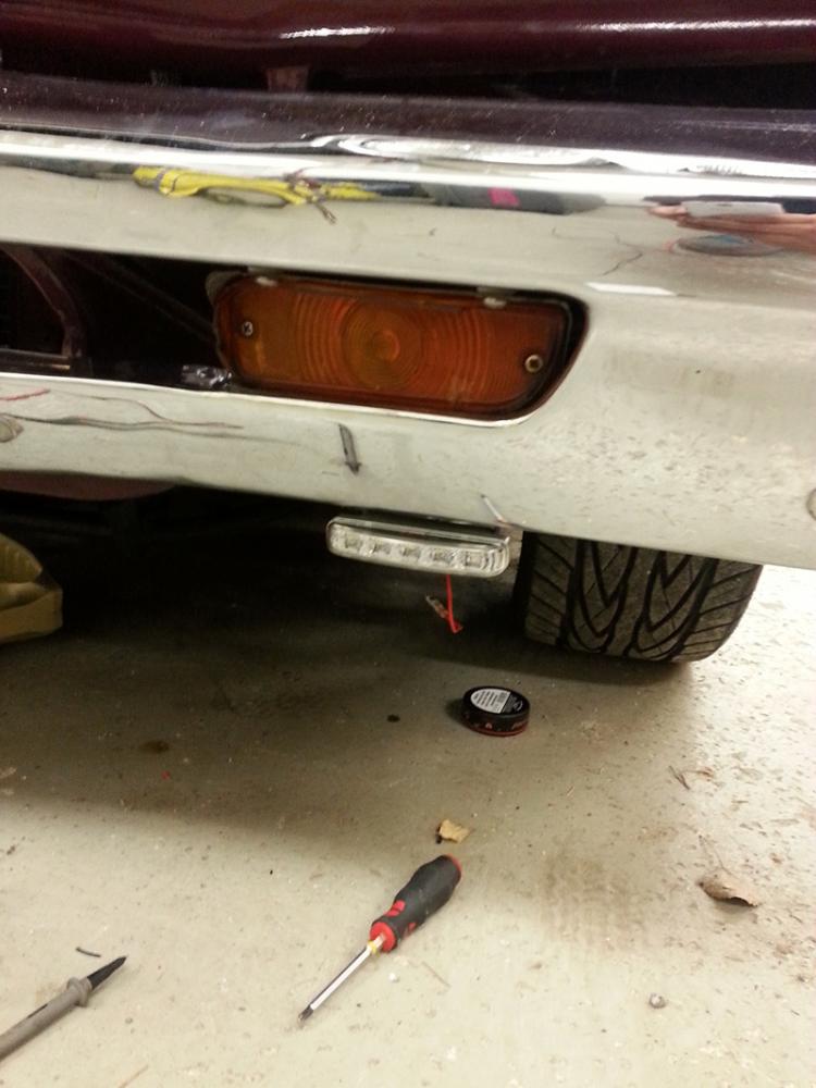

I had to make a new harness for the parking lights so it passes swedish inspection
Inspection mode ON. And yes - I'll remove them and NO I didn't drill any holes or cut any cables up :)

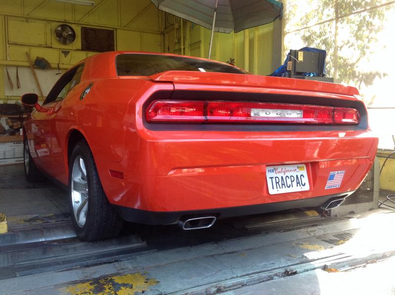

Getting exhaust put on it. When I dropped it off. I found oil pooling under an intake bolt so that will get fixed to. A year and a half ago I had someone put the intake on and do some other stuff to it. Well I so far I had to FIX everything the place touched. Well this was the last item that I hoped would not have to get touched. I was WRONG.

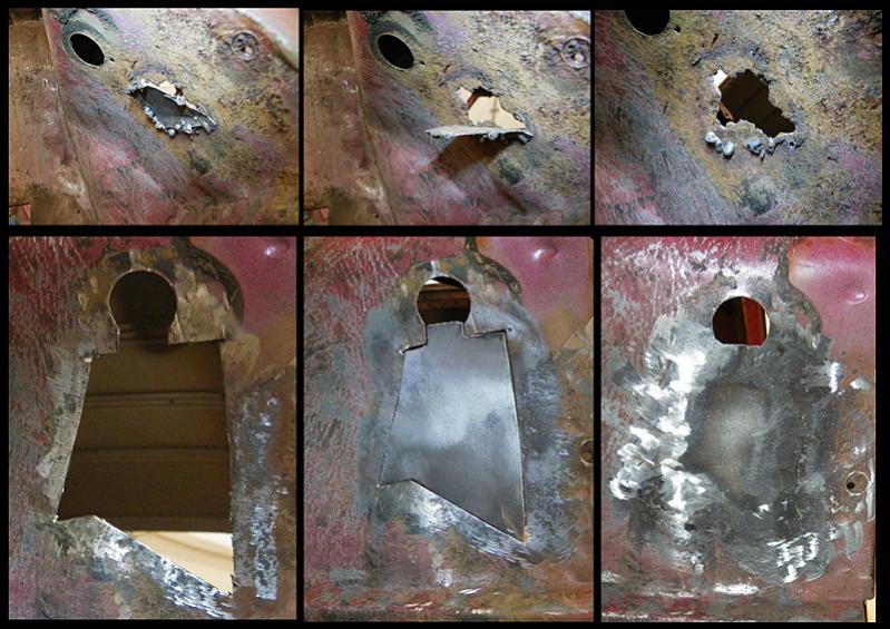

I fixed an old scab on the firewall this morning... I didn't even need a grinder to remove the old scab of a patch, it just peeled off by hand. It was only 17 degrees (F) out this morning when I fixed this, so it was a bit of a rush job... I clean it up later in a nice warm shop.

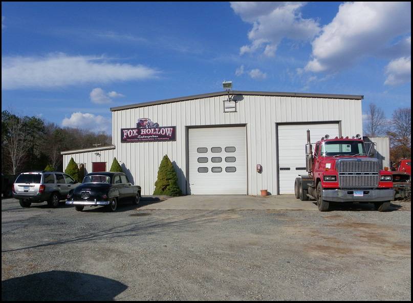

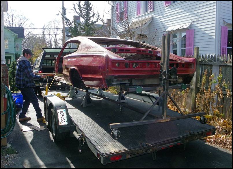

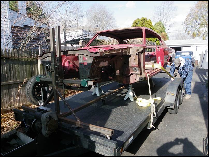

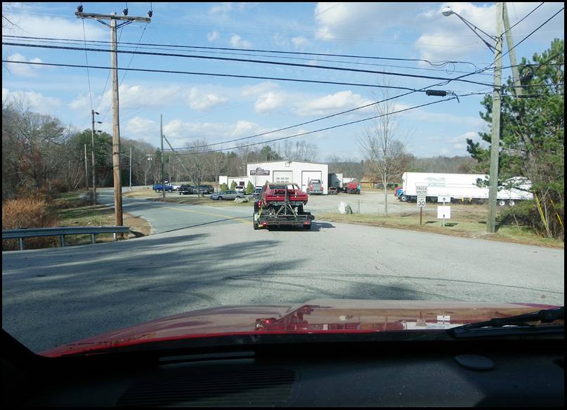

I pulled it out of the Twinkie and sent it to the shop.

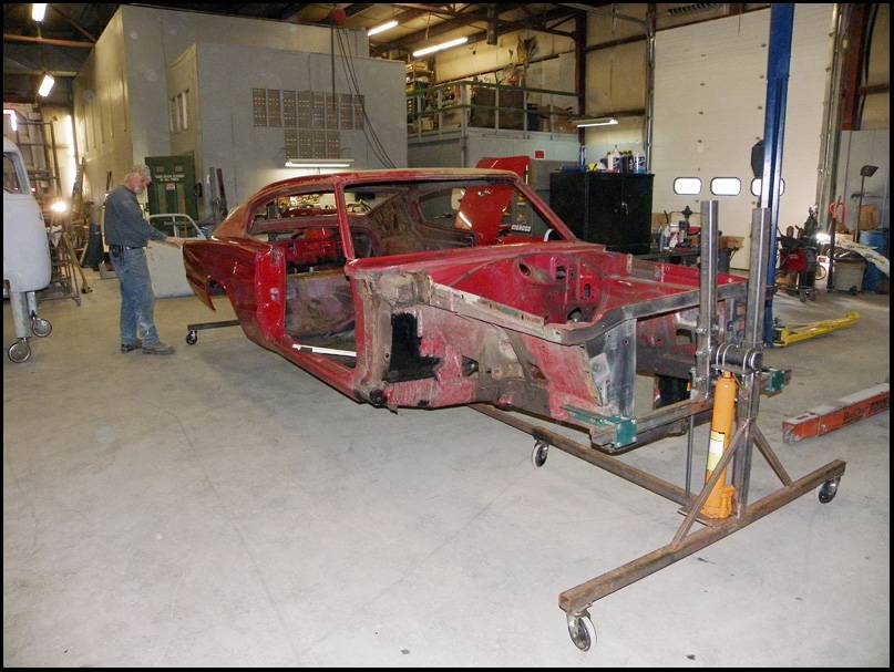

They came and took the Charger this morning! That's one big step forward!
Exciting ^^^

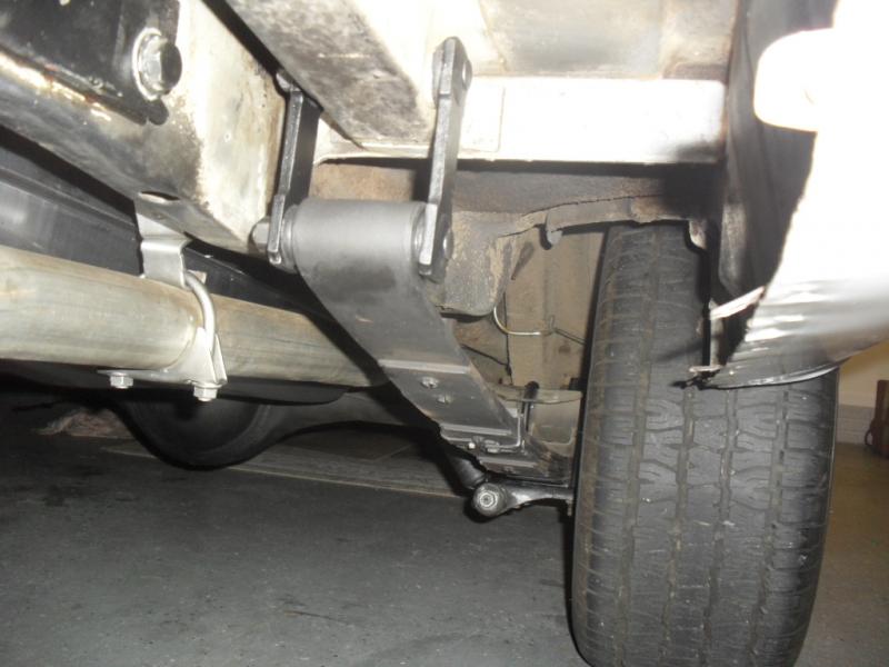

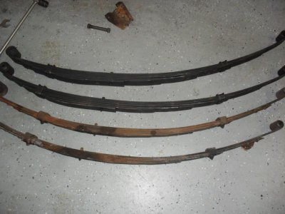

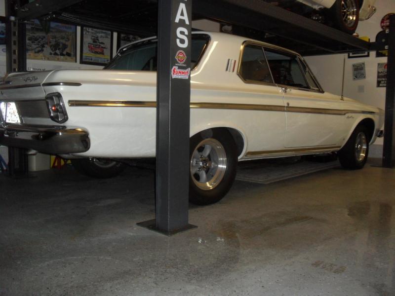

Installed a new 6 leaf set of ESPO springs. The 63 Sport Fury came with 5 leaf springs but Laura at ESPO talked me into 6 leaf springs and I'm real happy with the results. It raised the rear of the car 2.5 inches no more air shocks needed.SAM_3411.jpgSAM_3412.jpgSAM_3414.jpgSAM_3415.jpg

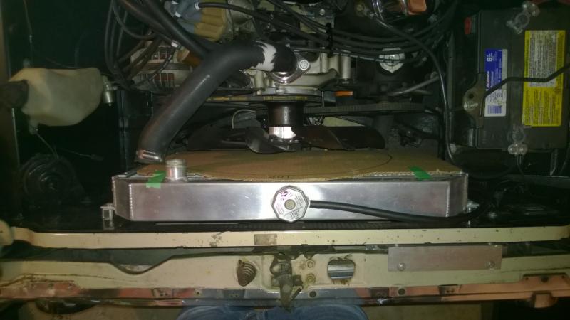

Installed new heater hoses and ran them to the fender instead of right over the distributor and valve cover like the previous owner had done. Also mocked up the template for my fan shroud mounts out of cereal boxes. Now my neighbor is bending the aluminum for them this week, and should be able to get the shroud installed.rad_mount.jpg

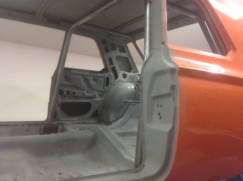

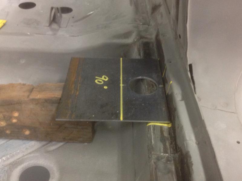

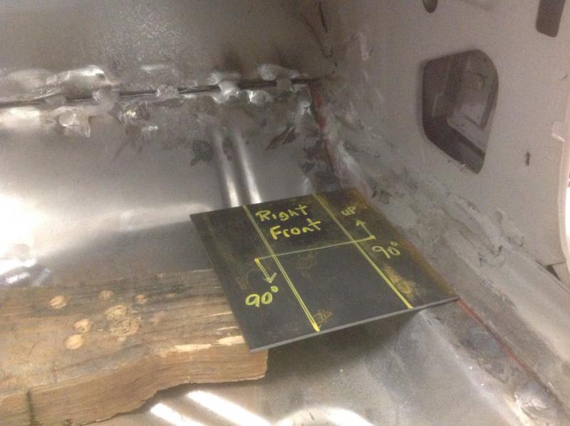

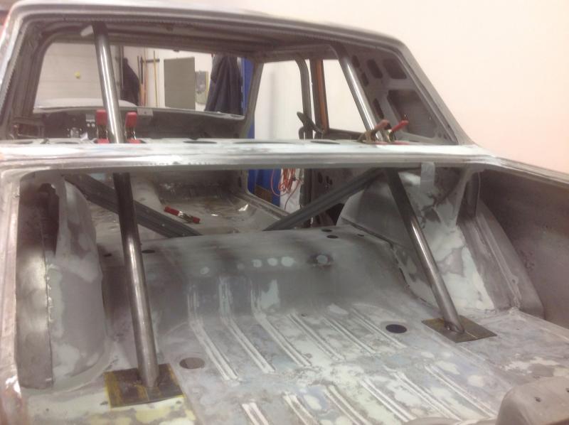

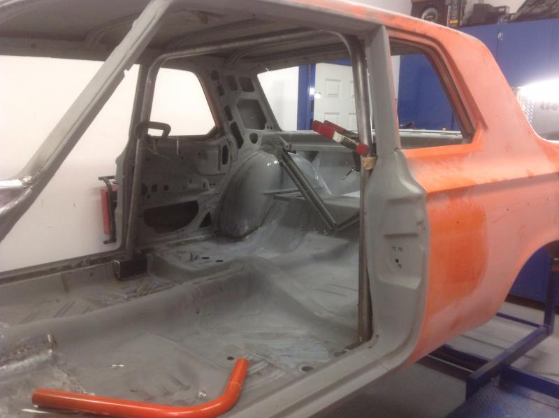

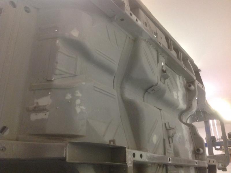

Finished up the underside, ready for primer now. Measured out the roll bar and started on the base plates.

This week I got to work and made my main roll bar hoop, rear bars and welded into place. Next comes the cross bar and then door bars. Still deciding on what sort of swing out door bar ends to go with so that is a delay. I see the latching type is only for 1 5/8 OD and I'm using 1 3/4 DOM by .120. Any ideas???

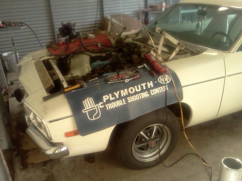

Removed rad and blocked off lines
Removed p/s pump
Removed starter, inspection cover and torque converter bolts
Removed all electrical connections and ground strap
Installed ratchet strap to act as trans support (hope it works)
Only thing left is four top engine to trans bolts, engine mounts and fuel line.

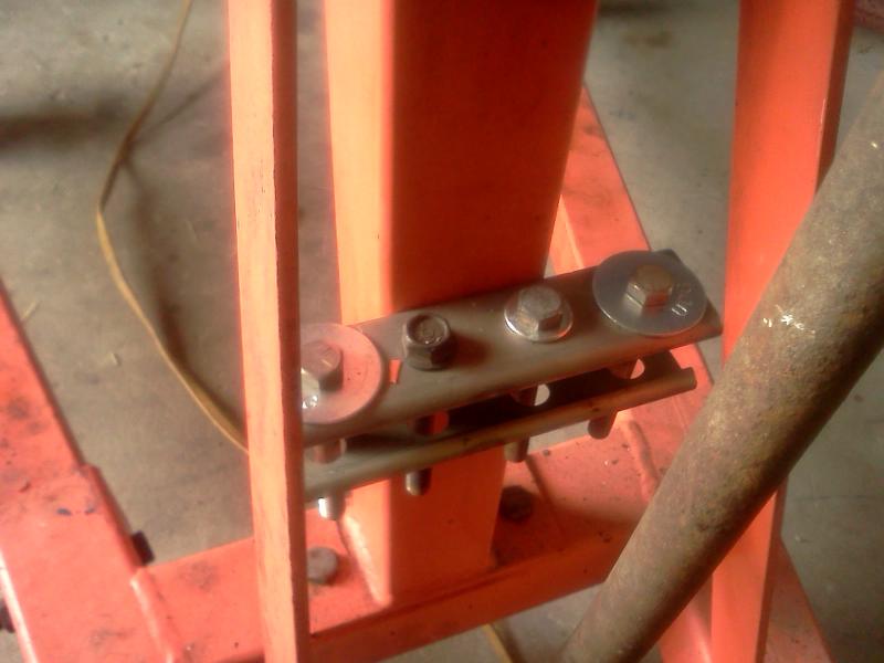

Also made a bolt holder for the engine stand because you can NEVER find bolts long enough or the right size when you need them.
Next weekend it should come out.

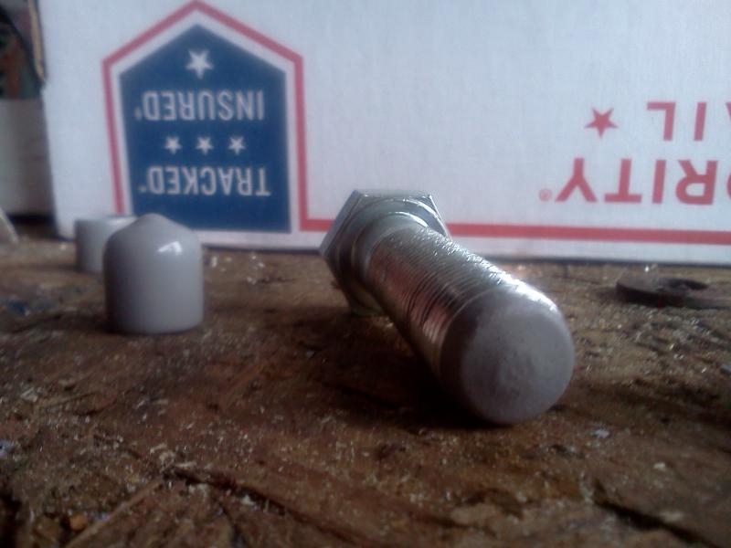

I used 1/2" bolt protective caps to cap the compression fittings on the radiator, and used those same caps to mold a silicone end on some 1/2" bolts to plug the line end of the connector.

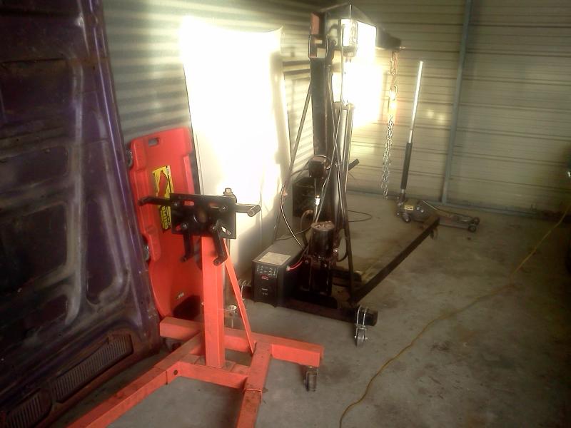

My engine hoist has a 24 volt pallet jack hydraulic pump and ram on it, installed by the previous owner.
I added the computer battery backup (which was already 24v), so now it is cordless and rechargeable!
That and the engine stand were a package deal CL score- $50 for both of them!
