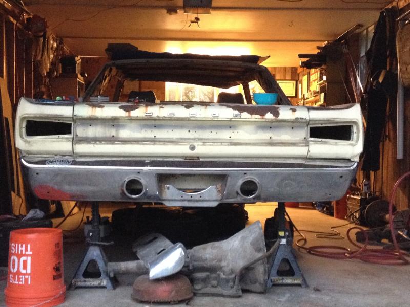

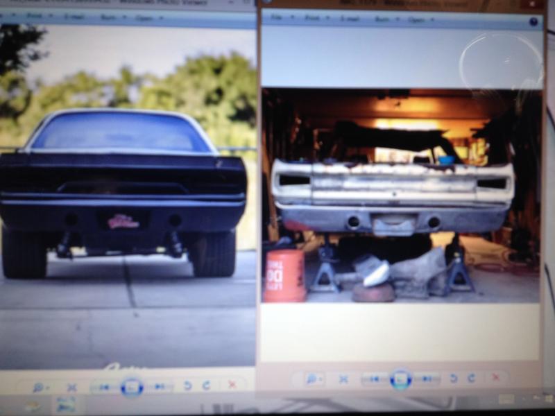

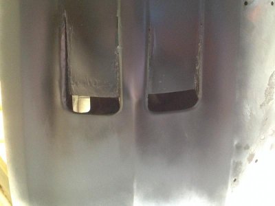

IMG_1180.jpgIMG_1182.jpgMoved all my gear and tools to the other side of the car and got busy modifying the driver side quarter panel scoops. I also hung the 70 Road Runner bumper on the rear of the car and it looks bada**!! I am going to have to add one inch to the middle of the bumper to get it hugged up tight to the body and allow it to come up a little higher so the body contour lines match up with the bumper lines. It will look good and I can run the dual exhaust out through the back up light holes. See the picture of my Coronet next to the twin turbo Texas car called ROADKILL, this is the look and stance I am going for.
View attachment 275185View attachment 275186Moved all my gear and tools to the other side of the car and got busy modifying the driver side quarter panel scoops. I also hung the 70 Road Runner bumper on the rear of the car and it looks bada**!! I am going to have to add one inch to the middle of the bumper to get it hugged up tight to the body and allow it to come up a little higher so the body contour lines match up with the bumper lines. It will look good and I can run the dual exhaust out through the back up light holes. See the picture of my Coronet next to the twin turbo Texas car called ROADKILL, this is the look and stance I am going for.
Wow love the 70 rear bumper on it
plans
Thanks! I have been massaging the corners of the tail ends of the quarters today to get the curve of the vertical edge to curve in a bit more at the bottom to match up with the upward curve of the bumper corners. I will sand down the bumper and build out with filler on the outside faces of the bumper to bring the contour lines of the bumper up to meet up with the quarter panel body line. It will look like it came from the factory that way. lol. I wanted this 70 bumper on here so I could run the exhaust pipes out through those back up light holes. I am going to run a 67 Charger tail light set up that goes all the way across. I'm going to cut them in two spots near the center and plastic weld two inch and a half wide white lenses in between the red and they will be the back up lights. Kind off a one off thing. The bumper will be painted the same black as the car.
I also am going to have to slice the trunk lid finish panel at the bottom of the upper curve and redo the latch to move it up higher to catch the lid. The lights buckets will go where the finish panel used to reside. It will be welded in stationary so the trunk will have its back edge at the point above the tail lights chrome trim.
I was worried about the 70 bumper being wide enough but it's all good. It could be about 1/2 inch wider but I'm not cutting it and adding 1/2 inch. I just recurved the tail pieces lower edge to meet the bumper.
