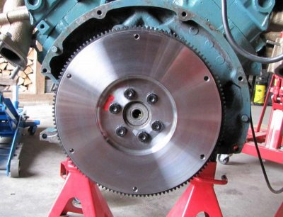

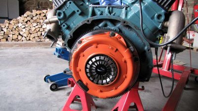

it was about Time to get a new Clutch!
So i pulled the Motor with the 4Speed and installed a Centerforce Dual Friction Clutch.
New Flywheel, new Z Bar with new bearings, new throwout bearing and a new Bellhousing ballstud/bracket

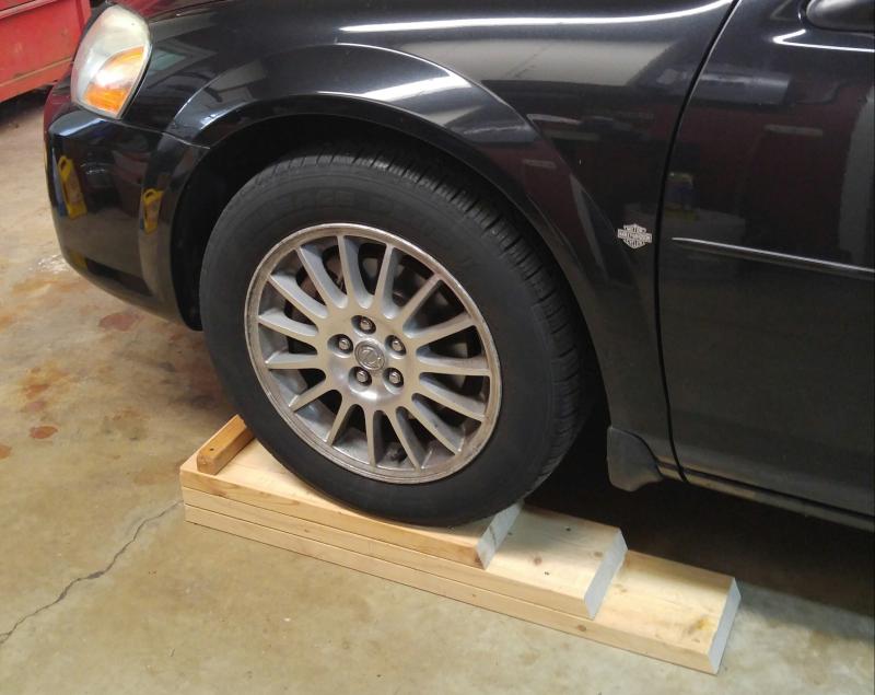

Got tired of trying to get my floor jack under these low slung cars like my 05 Sebring so I made a set of these.

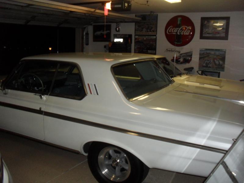

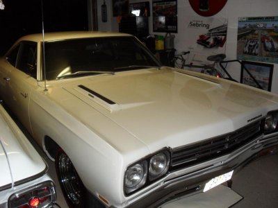

Got both cars cleaned up today for car shows every day this week. With the weather cooled down and rain chances low looks like we'll be out every night this week.SAM_1821.jpgSAM_1822.jpg

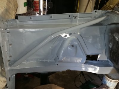

Got another piece of the car into Epoxy Primer . . .
Work continues on the build, and my progress of getting the car into epoxy primer . . .
Tonight . . . this was the results . . .
One step closer . . . feels good to see it in primer ( should have done it a long time ago . . .

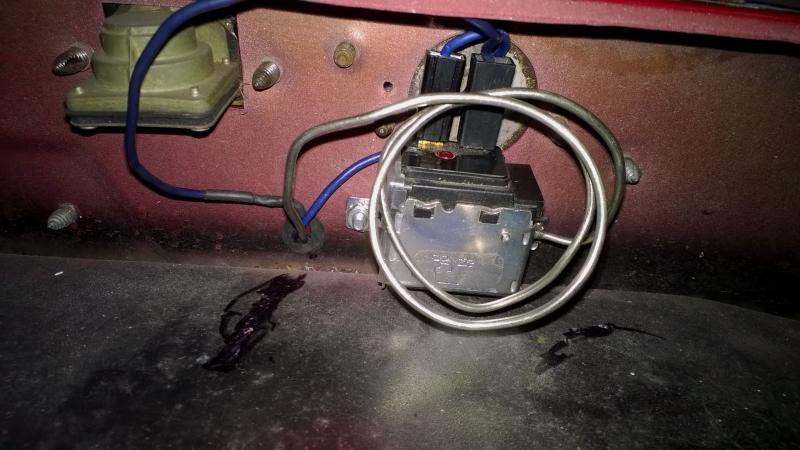

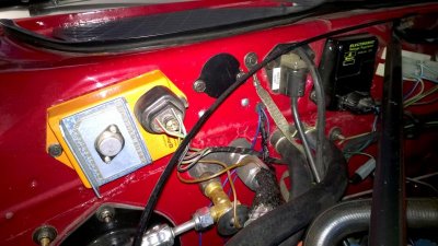

Well, at the suggestion of IDriveMopar here, I spent the better part of the day reinstalling the thermostat for my CCA A/C. For those that did not follow, CCA supplies an aftermarket thermostat that really should be installed in the heater box on the evaporator. If they'd have told me that I would have, since the box was out of the car. But they suggest you wrap a sensor around the line on the opposite side of the firewall and when it starts to freeze, the t/stat (in theory) will kick off the compressor thus keeping the system from slowing down. But it doesn't work because the lines are basically above the exhaust manifold. so their solution is to wrap them with this black goo. But the thermostat is still in the engine compartment and still won't kick off. So IDriveMopar moved his per this thread:
http://www.forbbodiesonly.com/mopar...etup-or-go-classic&highlight=Classic+Auto+Air
and now that the car season is over, I did the same. It's now in the cowl/vent on the opposite side of the firewall.
It is tough working in these areas because it seems as no matter how hard you try, you always move or touch something that you shouldn't. But with patience, I got it done today and worst case, the A/C works the same and I killed an afternoon. I'll let everyone know in the spring I guess.

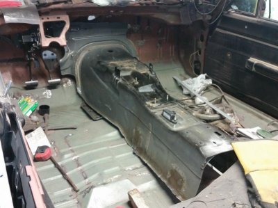

Pressure washed the 70 rr and stripped every bit of interior out of it. Vacuumed all the crap out of her, and made my markings for the 4 speed tunnel hump and where I'm going to cut the front floors out for the new pans. Very productive day

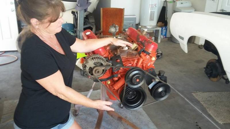

I pieced together the front of the small block
So I am putting together a small block for the DIRTBIRD.
Of course I want a gen III Hemi or a big block but I don't have funds for that right now so I got 2 318s and a 727 for $300 from a local guy who assured me they both ran when he pulled them. (fingers crossed)
The engine I decided to run had a freeze plug leak so I replaced all of them and cleaned out the block of all of the dried up stop leak debris in the water jackets.
I also cleaned up the block and painted it.
Today; my GF helped me to clean and paint all of the alternator and p/s parts and we bolted it together.
