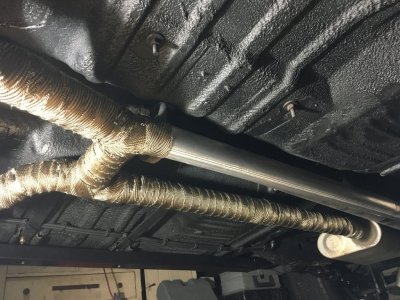

Looks pretty nice. Should keep things a bit cooler in the cabin.wrapped the exhaust with some DEI Titanium wrap. just did from base of exhaust manifolds back.
was just lookin for something to do

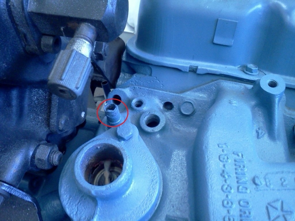

I know the threaded hole is for the heater hose nipple.
What's the other one for?View attachment 374382

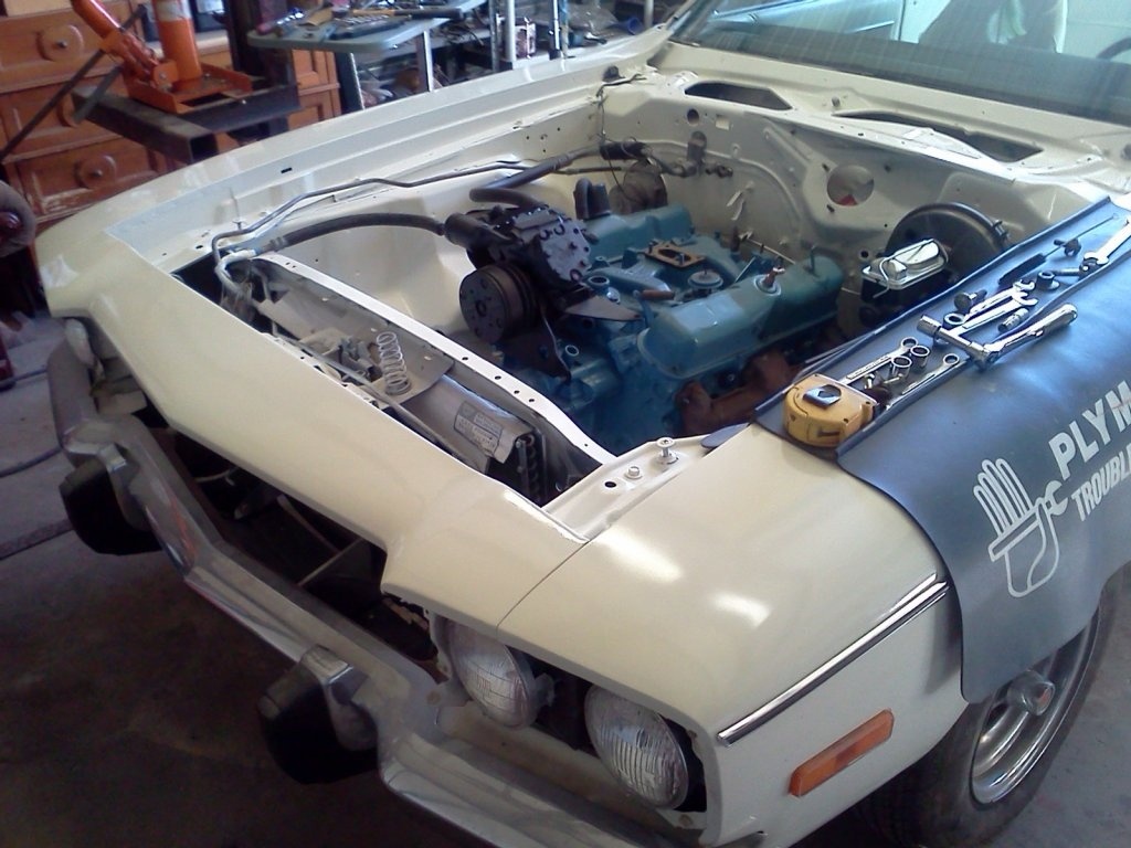

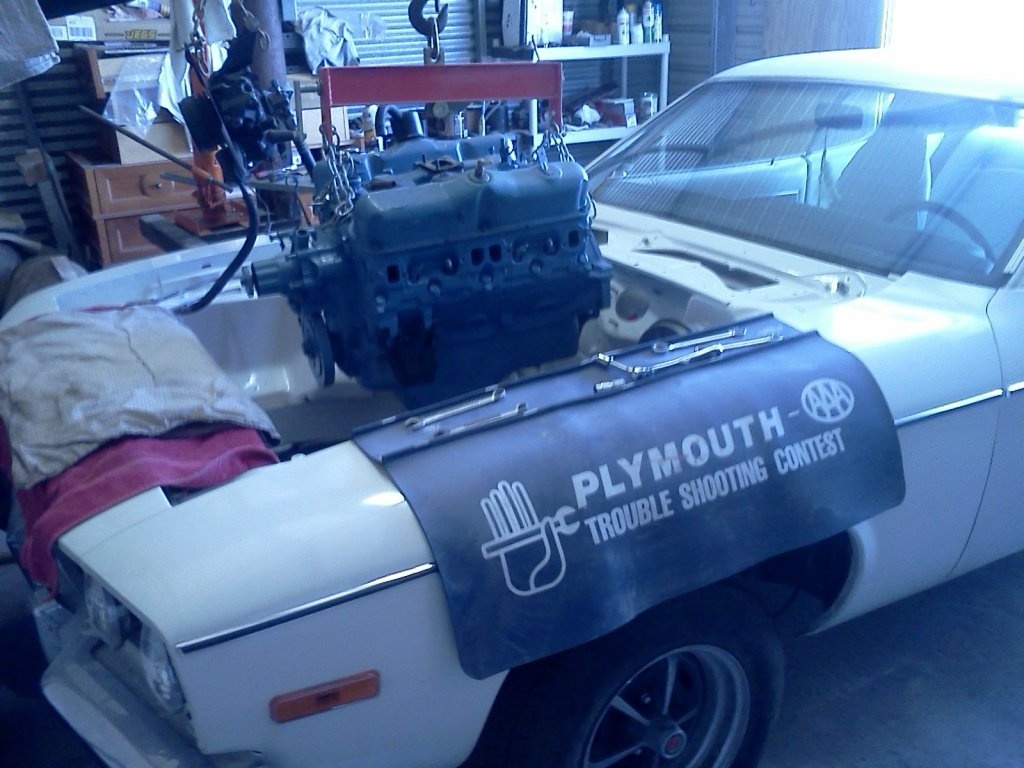

discovered I had a rotted fuel line and have at least 1 welsh plug on the way out and a leaking oil pan gasket so guess what is now happening to the SE before it will pass regoyep motors coming out to replace pan gasket and welsh plug. still it now has Australian compliant retractable 3 point seat belts fitted
getting there but its going slower than expected .
on a side note the automotive engineer that's doing all this has fallen head over heals with this car ( he's a ford guy ) and wants it bad , found a 71 charger is now his screen saver and he's offered to do a full resto on the rt + offered a quit substantial discount on the road runner resto as a swap for the SE about 50K Australianhe said he'll even wait while I drive it this summer while waiting for the roadrunner to be finished should I do the deal![]()
drove it for 2 hours straight, "flying high " at the moment
Pretty sure the existing nipple is for the heater hose, and the large threaded hole is for a thermovalve. Small thread hole is for the temp gauge sending unit (obviously lol).
Thermally activated vacuum valve, usually for the heat stove flap, or the smog pump valve, or sometimes both. Also depending on year I think it also could have went to the vacuum advance on the distributor. When the coolant reaches a certain temp it would open (or close, depending on application).OK, you might have something there.....what's that, and why would I have removed it?
