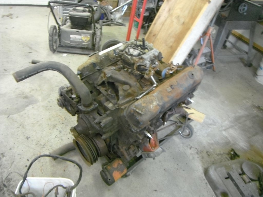

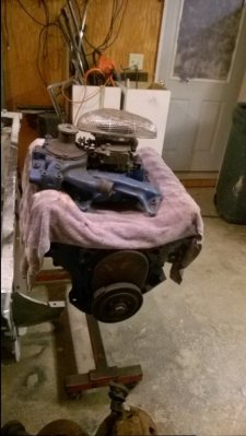

Wire brushed the dirt off that 78' 440 motor home engine, I bought last year. Dissembled the upper end, and was pleasantly surprised to find no ring ridge on any cylinder walls. The guy I bought it off said it had only 24K on it. This considerably reduces the amount the rebuild will cost me, as I was counting on piston replacement. I'm going have her hot tanked, re-ringed and all the bearings replaced. The machine shop I deal with, suggested milling the heads down thirty thousands, and put in a mid cam. I'm building this engine just to have some fun with it. I'm going to take her to the strip a couple of times, but no reason for me to get into any serious racing. Any suggestions on a cam shaft ? I was checking several after market sources, and was surprised that stock camshafts are all the same grind, from the 361 to the 440 applications. I expected different for each CID. Later next week, I'll get oil pan and front cover and pump housing off.

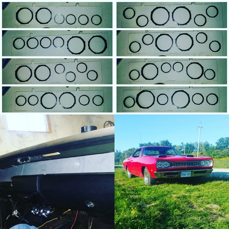

Went by the body shop to check out the dash removal and talk about how the ac / heater box was going to come out so I can rebuild it, just can't stand it it the heater works fine but the ac is long gone but you know dam well if it doesn't get touched and refreshed now while its open it will fail a month later and I WILL BE KICKING MYSELF STUPID LMAO got to order up some new wiper pivot bushing gaskets, heater/ac box resto kit, fire wall insulation, kick panel insulation, new heater core, new under dash insulation and finally getting around to replacing the wrong ignition switch housing! that thing has been driving me nuts since I got the car dam 69 one off key housing! lol my body shop is going to fix and re paint my dash and steering column, they have few extra holes to fill so many after market guages screwed to the bottom lmao. all will be patched. going to let them design a custom gauge pod on the center console top kind of like th 67 hemi tach setup except it will be 3 pod small gauge one tch will sit seperate next to it. also got new dash vents, going to have the dash painted black to match the interior.

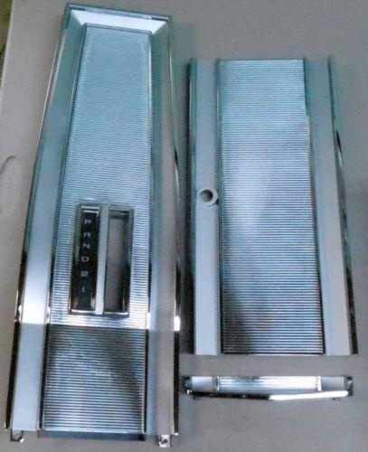

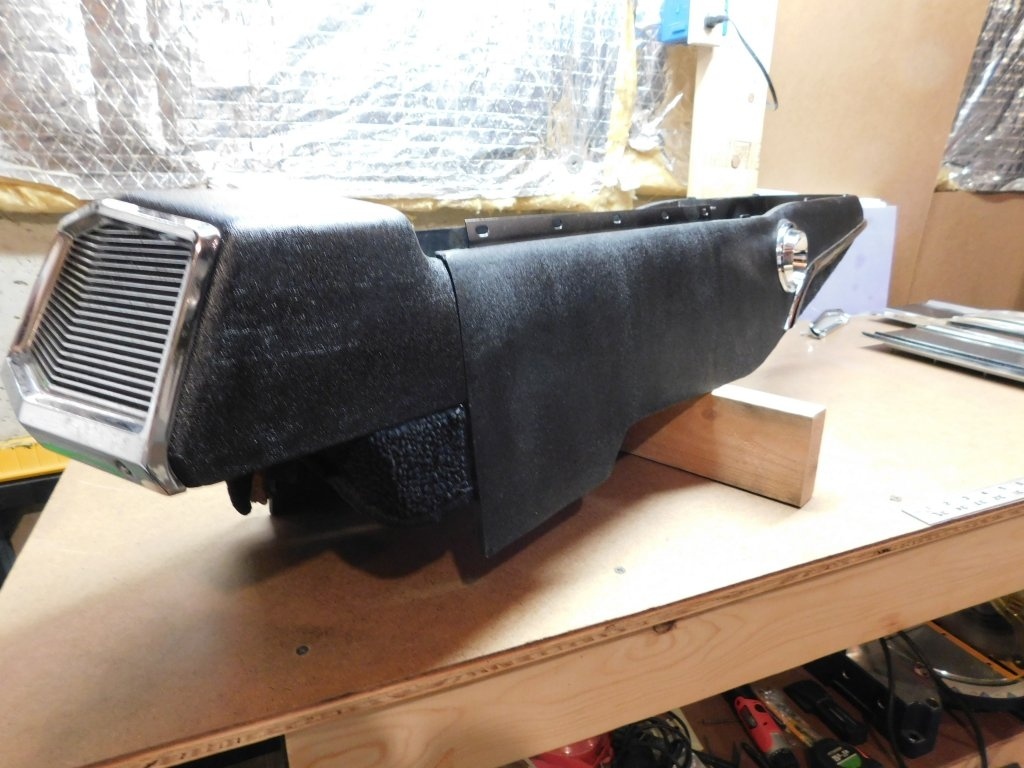

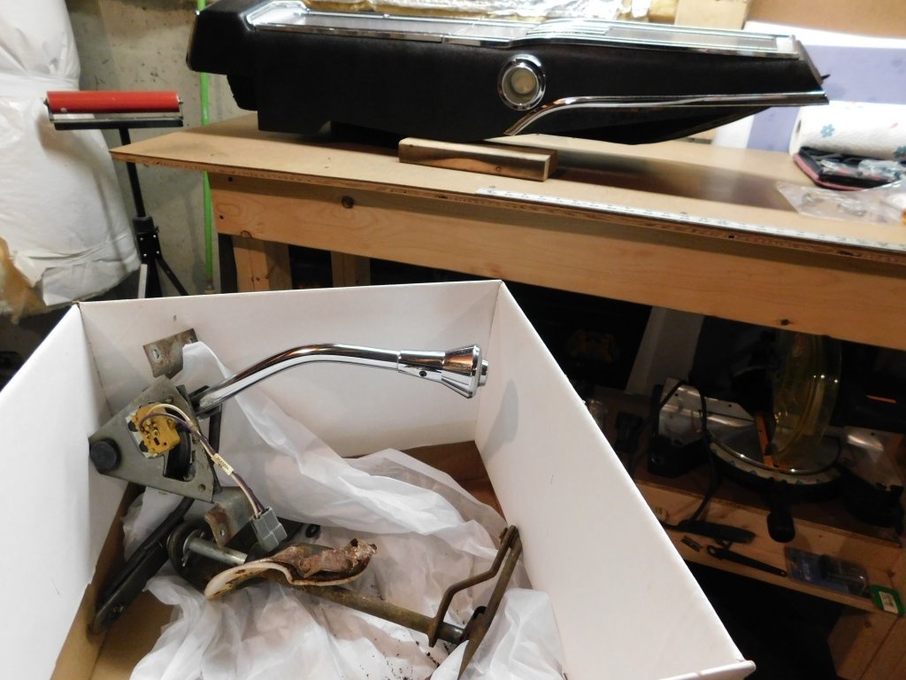

OK ..life has curve balls... bought a 67 Coronet and turned out to be, not what it suppose to be (some people suck)..snagged a set of buckets, console and shifter out of a 66 a few days later ...just redid the console, it was a mess, looks pretty good for a driver quality ..now got a console, buckets and no car to put them in... not selling these, just have to find another 66/67 ...(need pass. carpet piece if anyone has one)

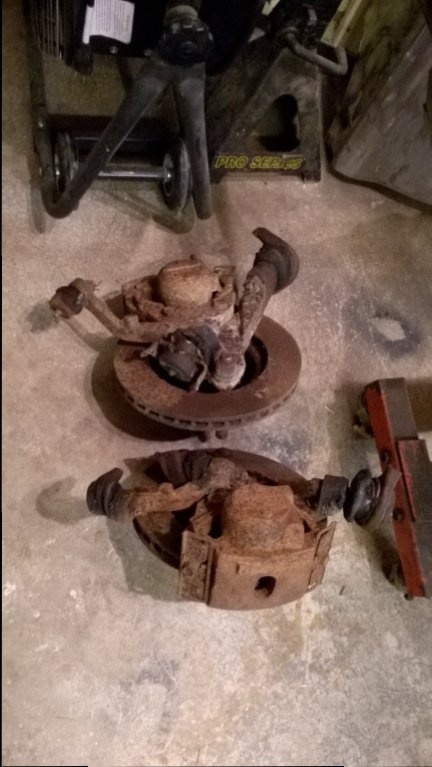

Well....I just spent an hour catching up on this thread with everyone's doings. All looking great and inspiring!! Keep at it! As for me....I went to my buddy Gary's house today and talked him out of a set of 11" front disc brake spindles, rotors, caliper's set up. $150 bucks. They are off of a 1976 Plymouth Volare, a state owned car.
