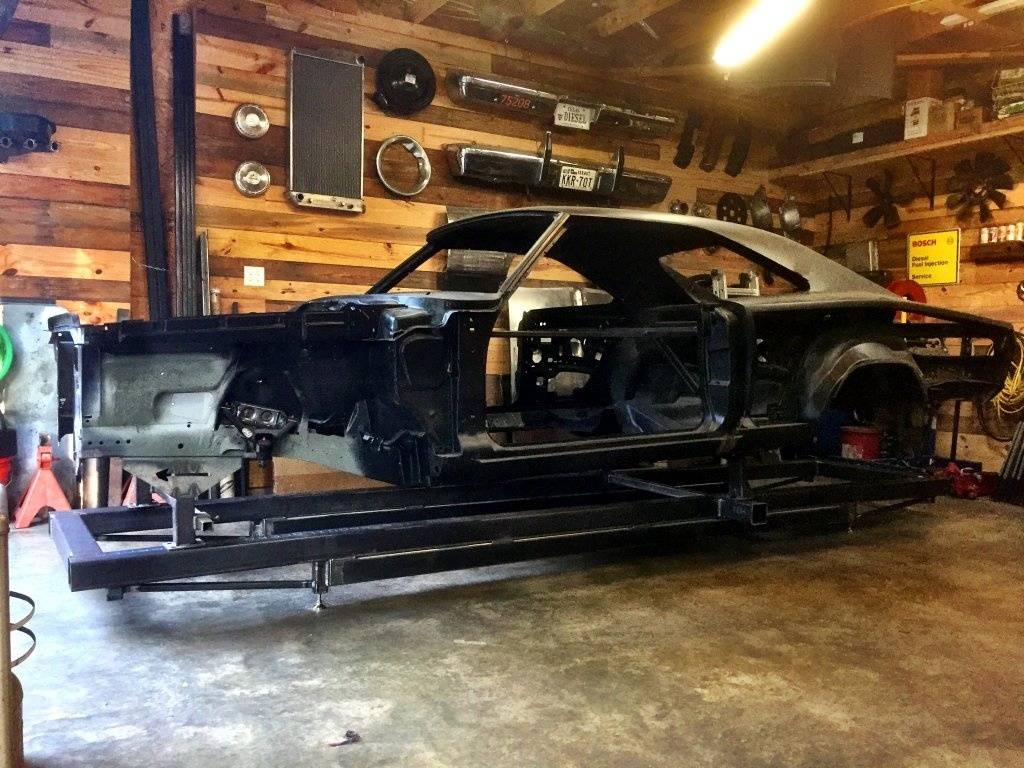

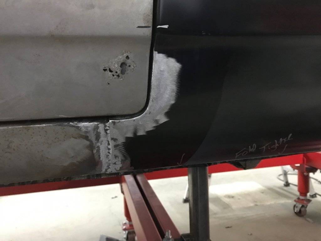

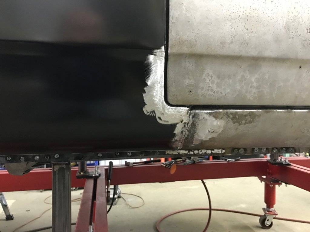

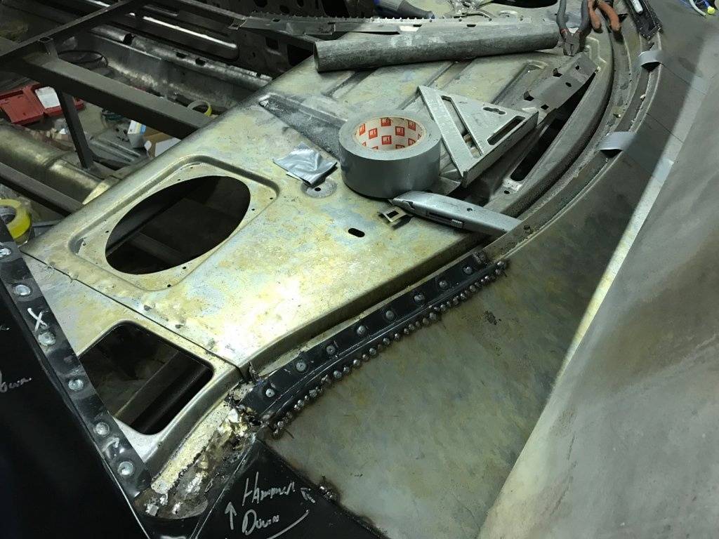

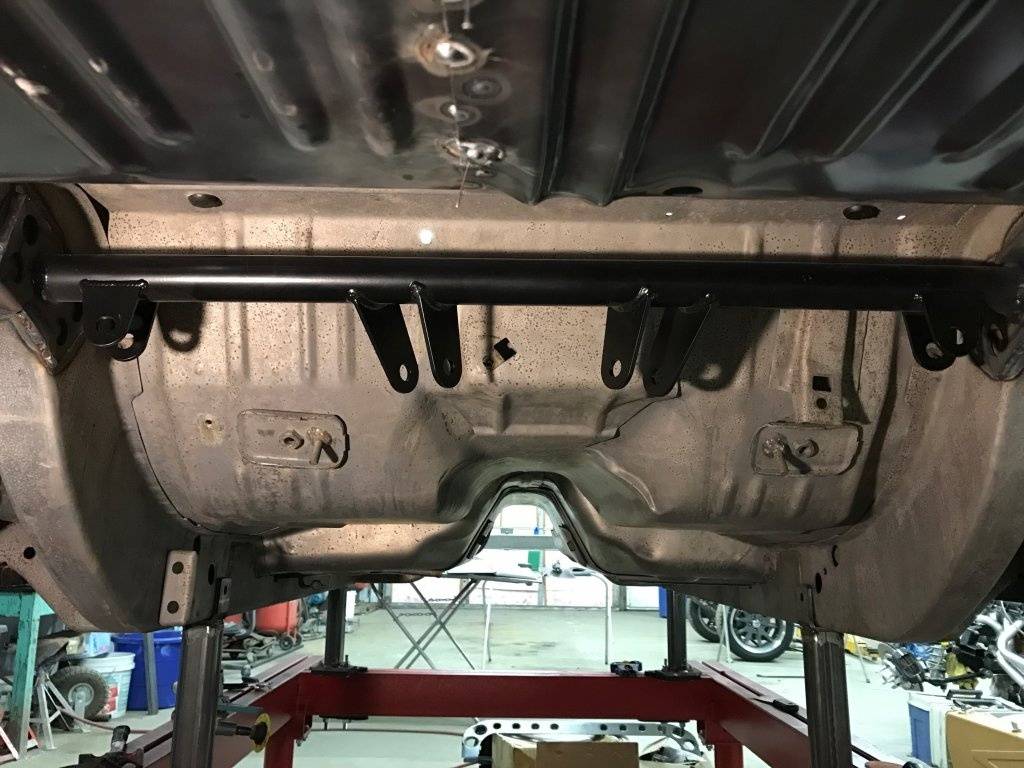

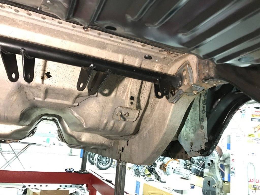

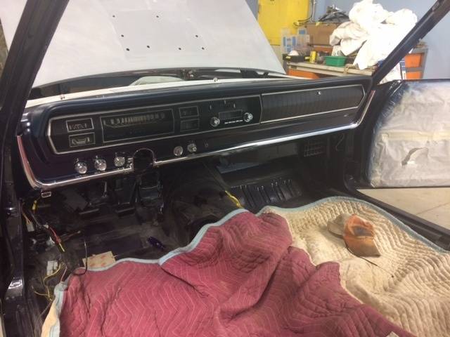

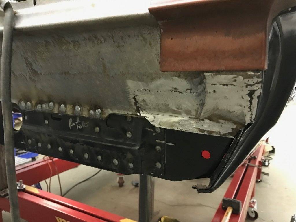

RMS suspension went in like a million on bucks, body lines are coming together real nice 3/16 all around the car. I think the car is getting better than me...lmao

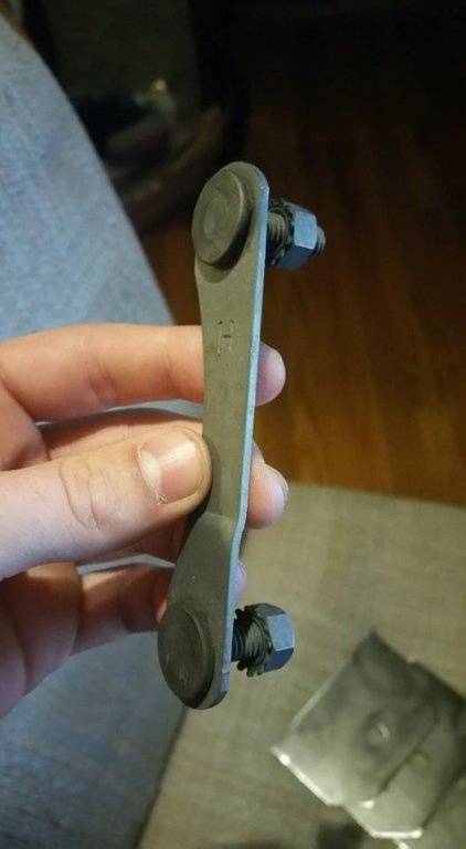

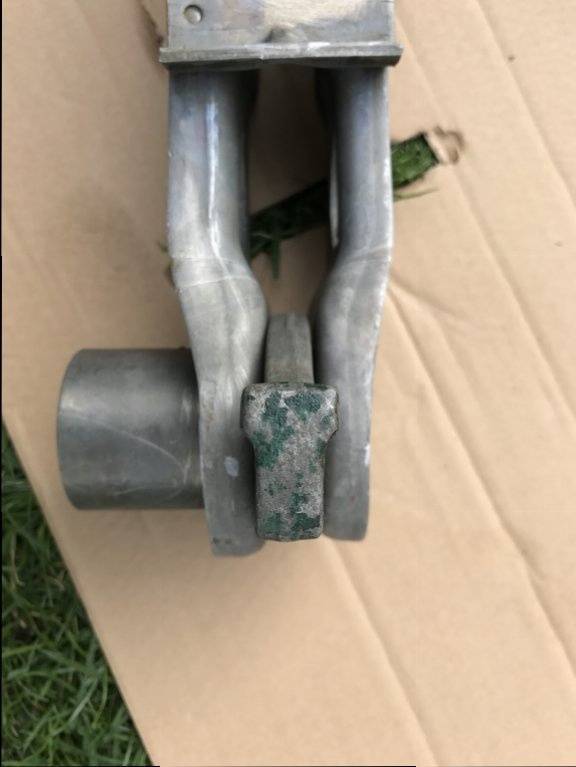

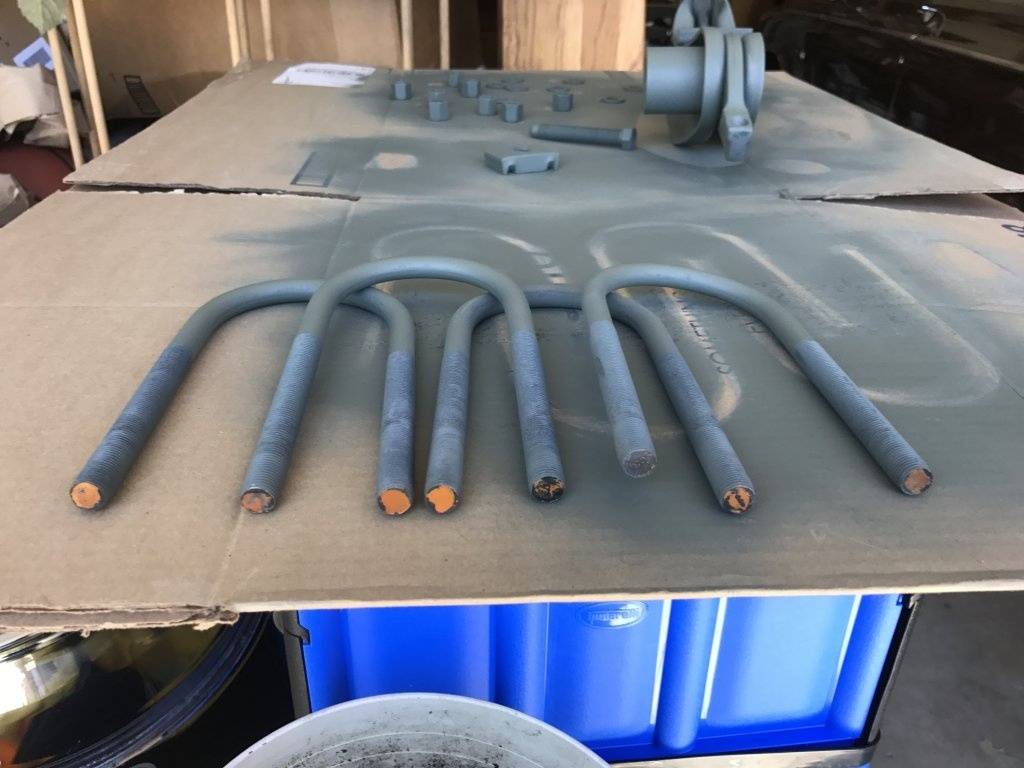

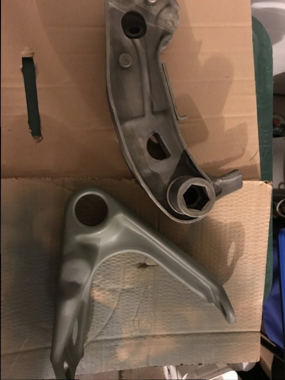

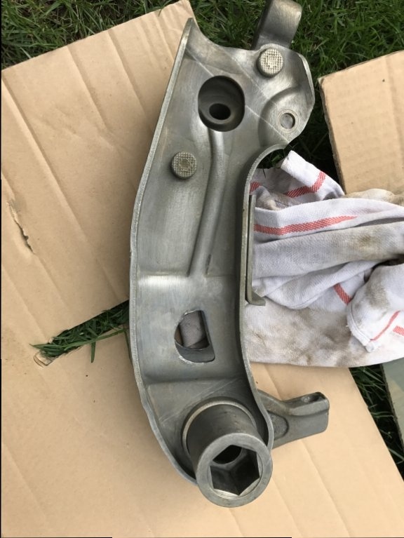

Is that before or after the primer??? That looks awesone!

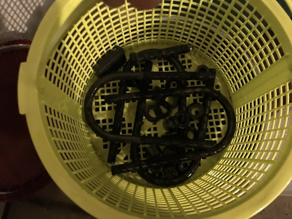

The lower was bare as in this pic. The upper had been spray with rattle can etching primer. I wish I could have kept what was left of the greem marking on the end of the adjuster. I also found the orange on the ends of the ubolts. I did put tape on those and we'll see if they hold up.

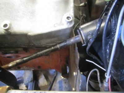

Got in a wrestling match with a front to back stainless 3/8" fuel line. I got the upper hand!
Front part wasn't bent too bad, rear was a good match. Overall length was a bit long. By the way, those aftermarket 3/8" clips are junk. Made up my own clamps and used 5/16" self tapping body bolts in the holes where the clips go. Just don't over tighten.

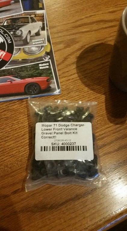

Ordered another $3000 worth of new parts thanks to my neon selling ! Wish I could of used all the funds on the charger but wife said other stuff needs attention too!

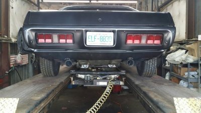

Had 2.5" exhaust with Flowmaster Delta 50 series muffles installed on the 71 SSP. No H-pipe yet... like the current sound.
