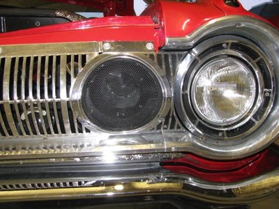

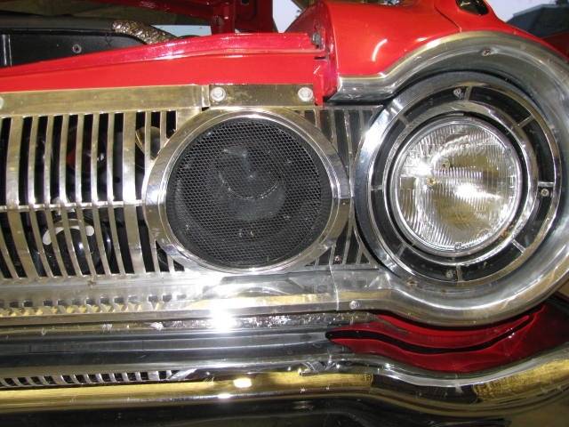

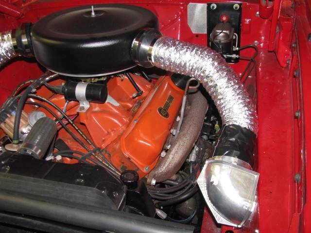

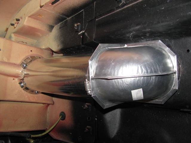

Working on the set up and installation of a home fabricated fresh air induction on Brutus, the 64 Dodge. Air comes in the inside headlight buckets , along the outside of the inner fenders and through the inner fenders where it will hook up to flexible ducting and then to the dual snorkle air cleaner. ............................MO
I got it cobbled together so I can go cruising Memorial day. Being the weekend, I ran out of hose clamps and a 4" to 3" adapter. Therefor the " gorilla duct tape.!!. Later, I will get some better hose and tidy things up a bit. .................................MO

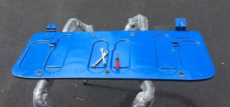

I stripped the paint off the tail panel and had the anodizing stripped. Then I had it polished and just got it back from the powder coater. I also had him coat my Weiand 8009 intake.

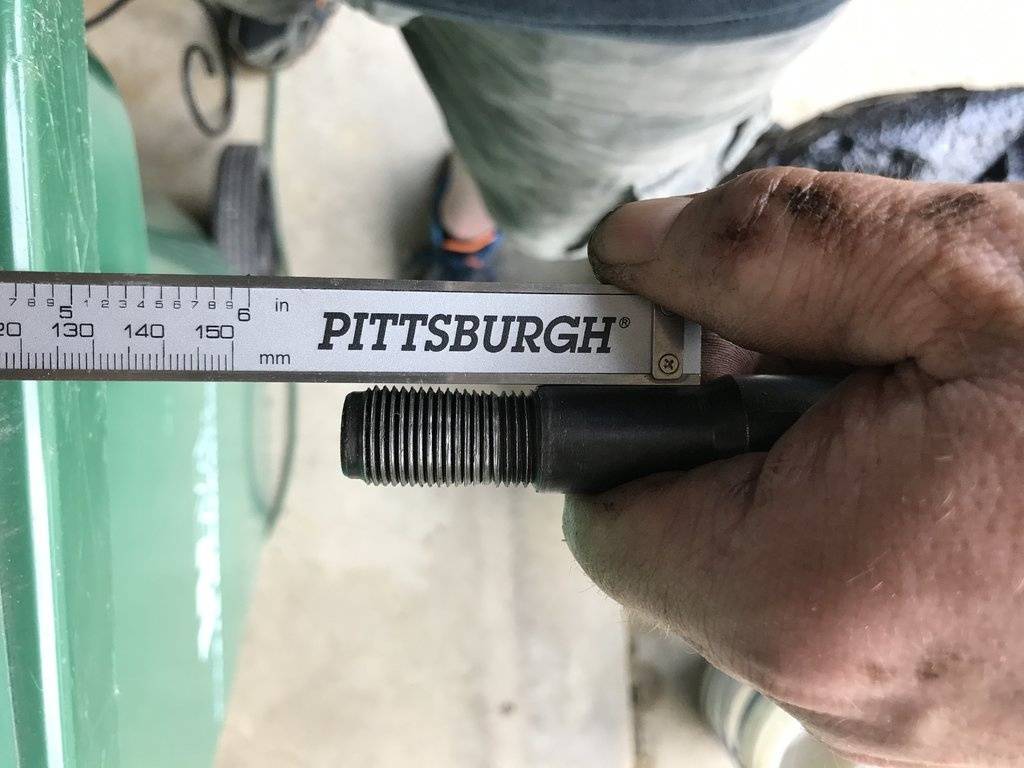

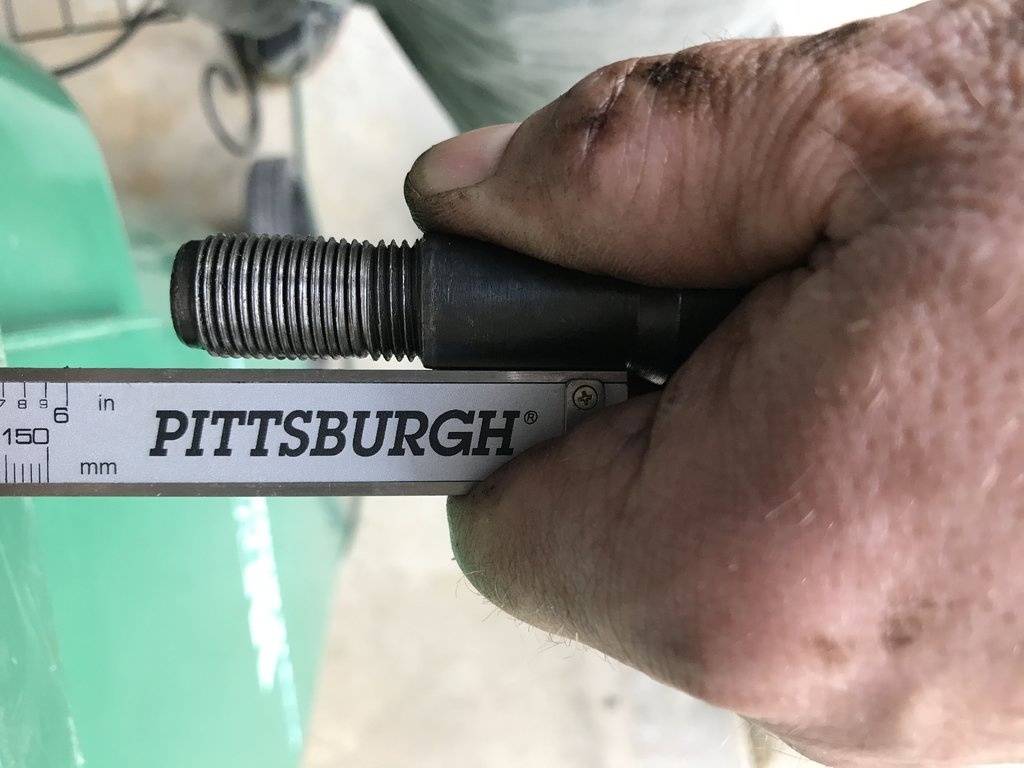

Finally got a little time to put some of the parts on. As I started to put the driver's side LCA on I discovered the nut won't go all the way on. I discovered the pivot shaft threads were messed up and part of the thread area was bent.
I replaced it with one of my cars originals. I checked the drivers side and noticed that it already had an original pivot shaft. I also noticed that the rubber bushing in the passenger side had a slight tear and was already worn badly.
Since I had already bought all new bushings and boots for rebuilding my original front components, I pulled both shafts and rubber bushings and put in the poly bushings and the original pivot shafts.
