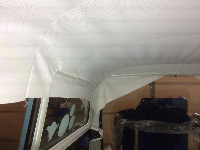

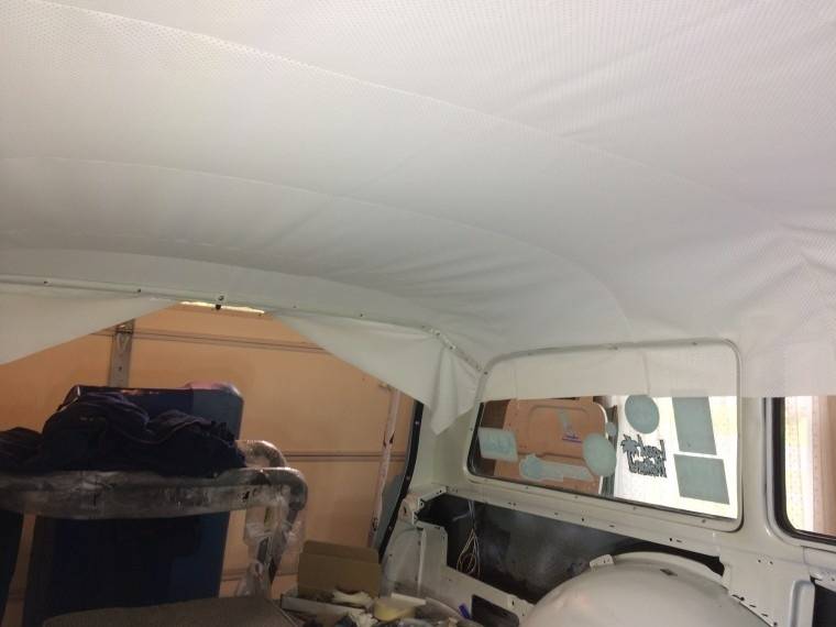

Worked on the headliner in the 1955 Plymouth wagon.

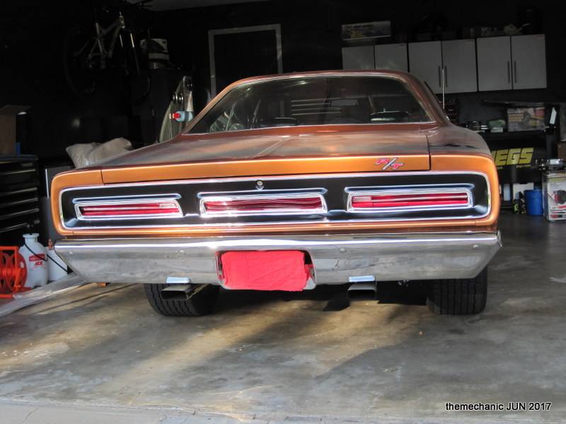

Forgot the photos from my earlier post about re-installing the tail light moulding. I restored the moulding and polished the "3rd" tail light lens. It's not a show car and not numbers matching. So, I had it powder coated satin black because I like the looks better than flat black. No criticism, please.

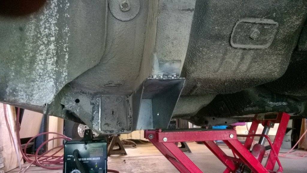

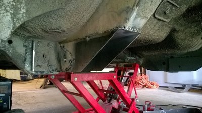

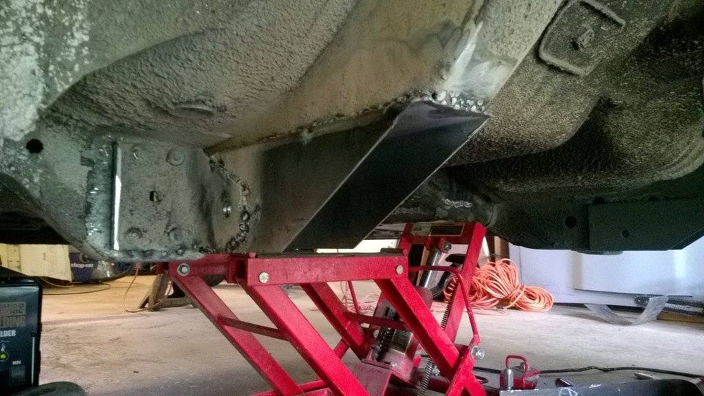

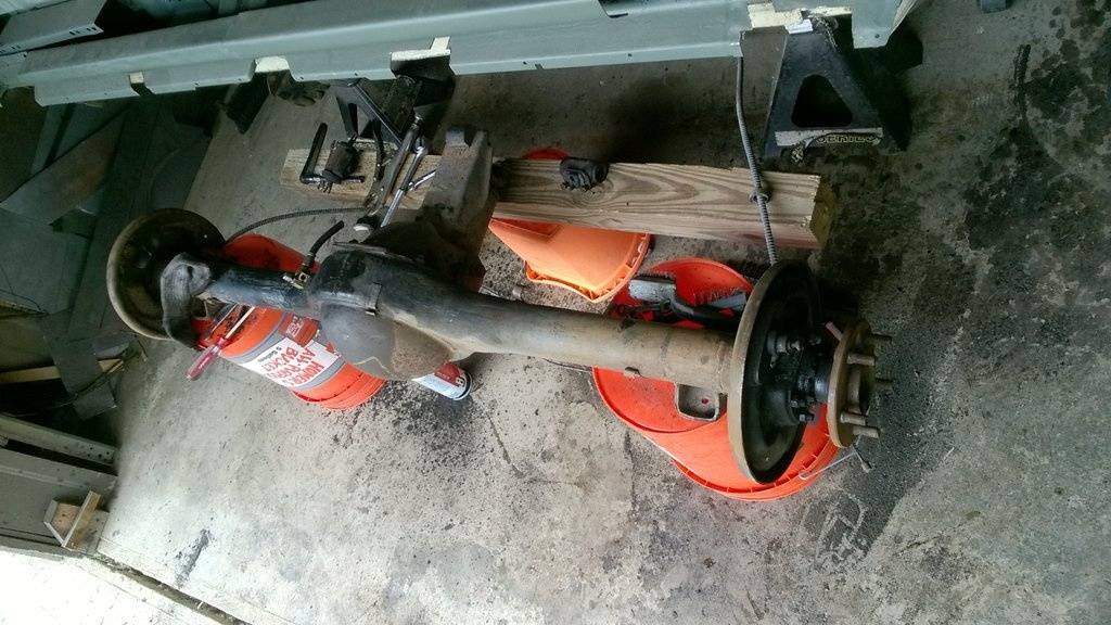

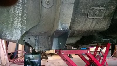

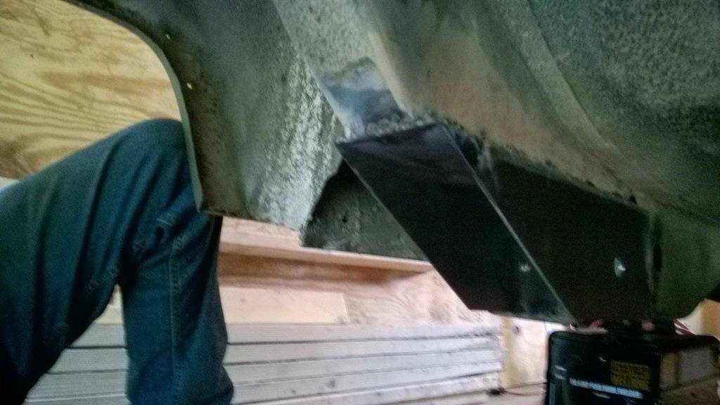

installed the left side spring relocation bracket and dragged the rear end out and set it up on some HD buckets so I can clean it up, rebuild the brakes. While it's out i'll get the center to center measurments for the leaf spring pads and weld them in place. And paint it.

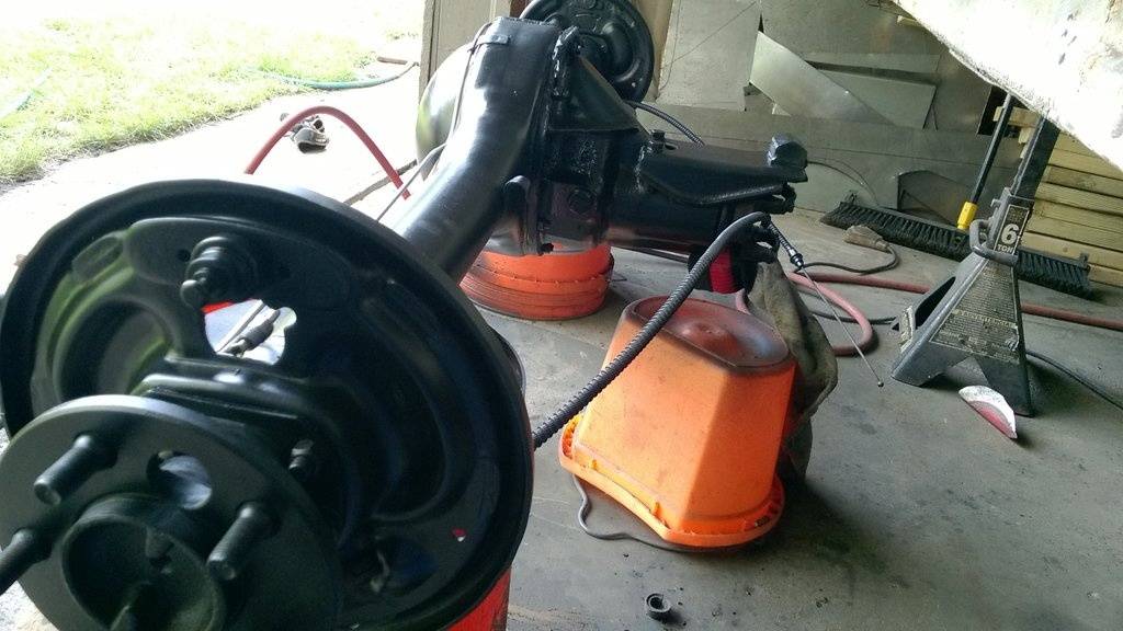

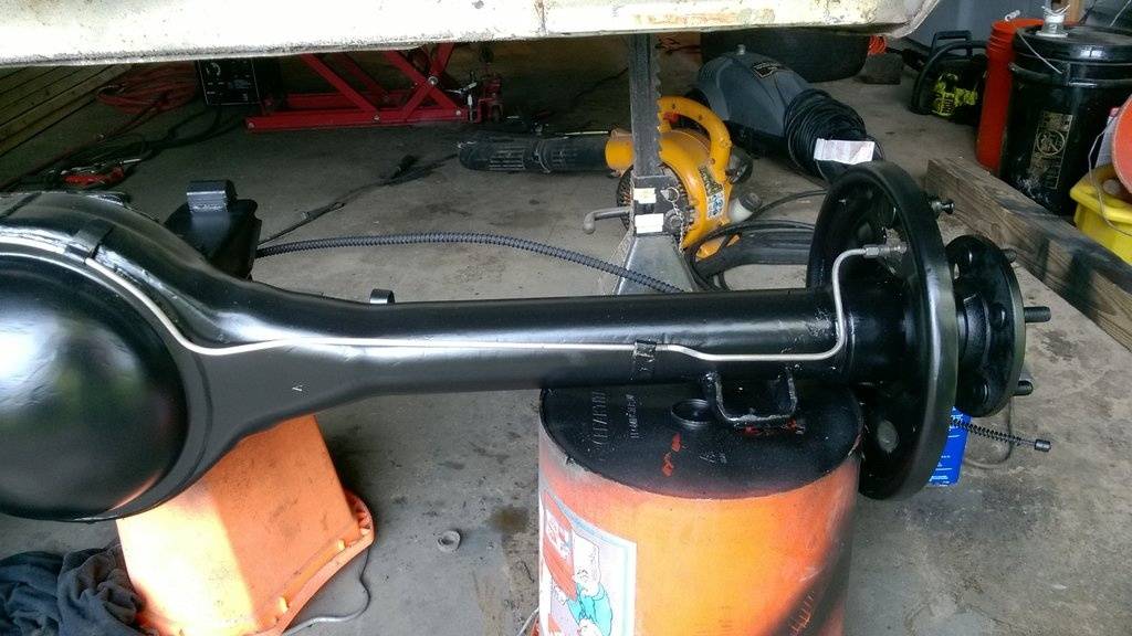

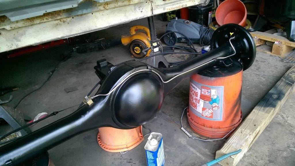

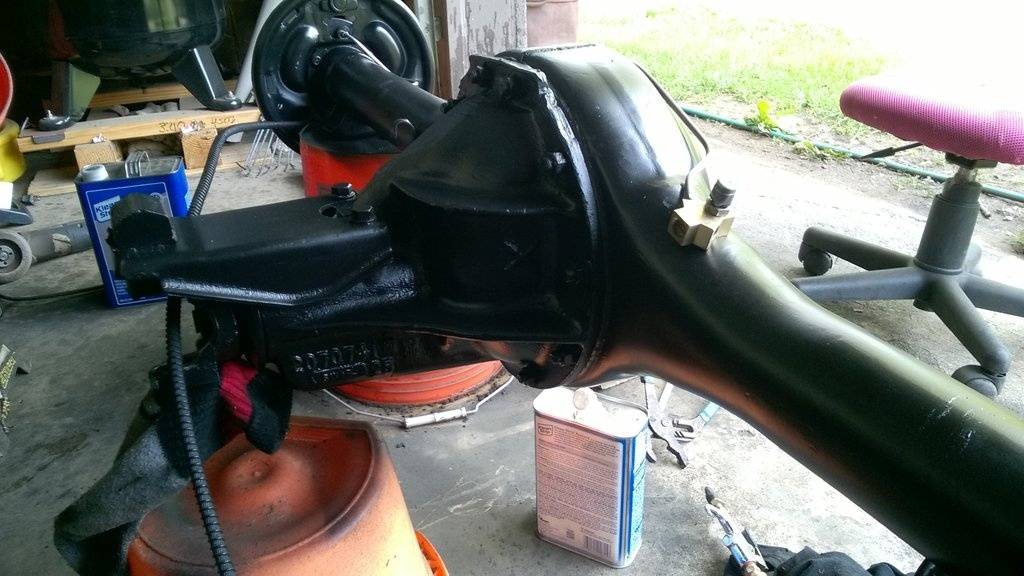

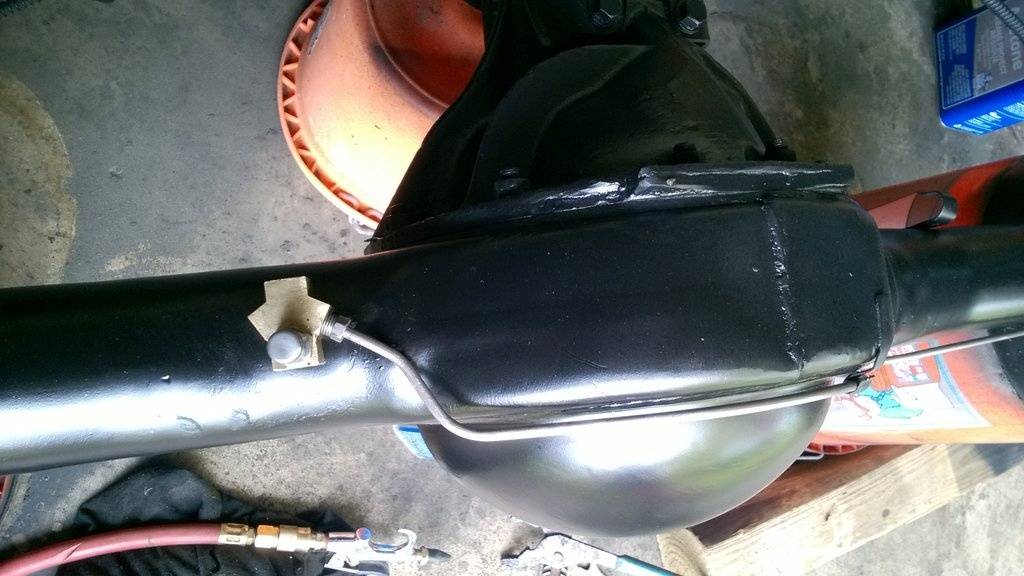

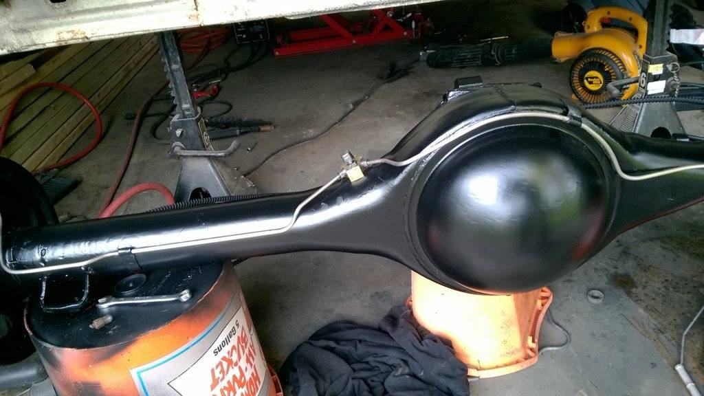

I spent the day de mucking, de greasing, and cleaning up the old 8 3/4. Broke a brake line end. Got it all tidy and put some epoxy primer on then semi flat Rustoleum. I shined up the brass tee and the lines and put them back on. Next is new brake packages for both sides and get the drums turned. EDIT,,,i just noticed a problem. With the new spring pads moved in under the frame the stock brake lines have the bend to accommodate the U bolts in the wrong places, hmm....

Looking good, I hope mine looks that good one of these days.
