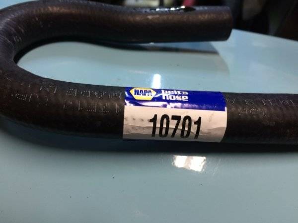

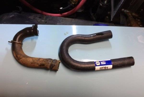

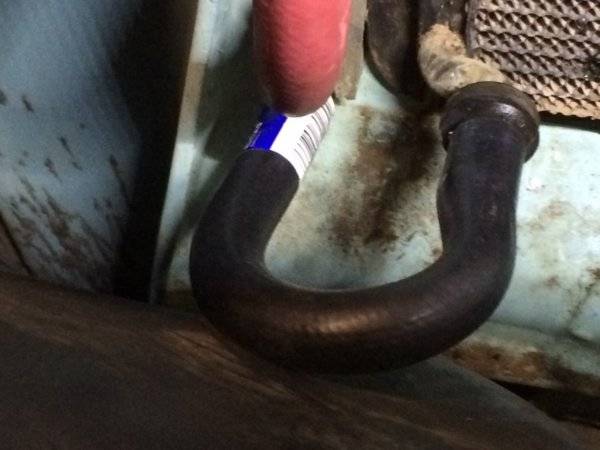

Found a Honda-application heater hose that, with trimming, could replace my ancient looped heater hose on the 1955 Plymouth.

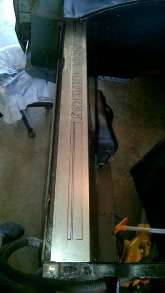

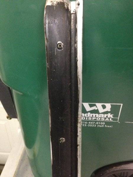

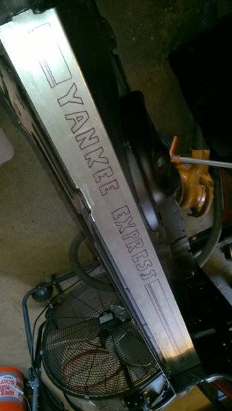

Cleaning up the trim while car is out for repaint. 40+cosmoline under the scuff plates,lol; nobody will see it, it stays.

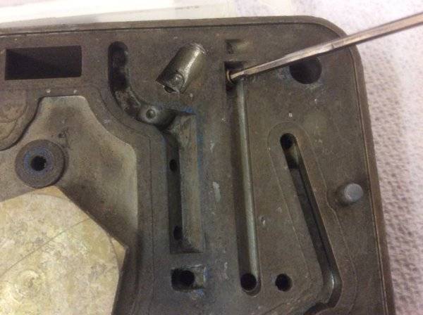

Do we need to start a new thread here? I'm 'old school' here & just remember this stuff from magazine articles. ( before Internet)!
Oldbee I'm using and article from Hemmings Muscle Machines Dec 2015. Probably restricted metering block IFR's to much.
After yesterday's disaster of 65 Dodge still not running right with carb mods today was go over the carbs. Removed them drilled the IFR's to .028 from .024. Closed primaries and made sure they were cracked the same. Ditto the secondaries, been screwing with them to add more air and keep primaries closed a little more to keep transfer slots covered more.

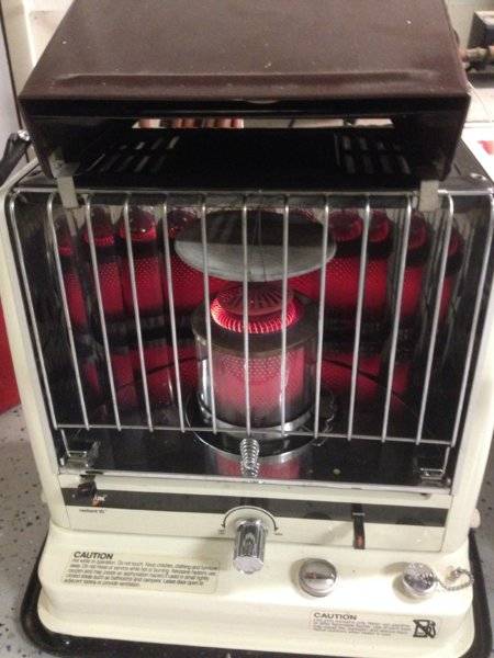

Snow tomorrow? Fired up the old 'Kero-Sun' that my dad had to check it out. New,last year wick from " Miles (something)". Worked like a charm. This thing is like 30yrs old and I like to keep old stuff working. Brings back memories. 10,000btu.
For 'fran' and others, I always thought secondary "crack-open" on the throttle plates was a "no option"(?)if you needed more idle air you drilled a hole in each primary throttle plate(?).
What's the difference. I'm not drilling holes in the plates (they could be replaced?) there 3116 carbs from Nov 64 haven't been drilled.
Fran we may be thinking different things at the moment? I always set secondary plates at stock & went from there, although not nearly an expert! I was thinking more air for primary plates at idle(?)

Was using a 250,000 btu heater. Working in the garage while heating, bad move. Was getting headaches, carbon monoxide poisoning symptom. After that heat garage so walls and such were warm and not be in there . Then open garage to let fresh air in shut door and blast heater for a few mins good for 2 hrs . Have use the heater for years, garage to crowded.
