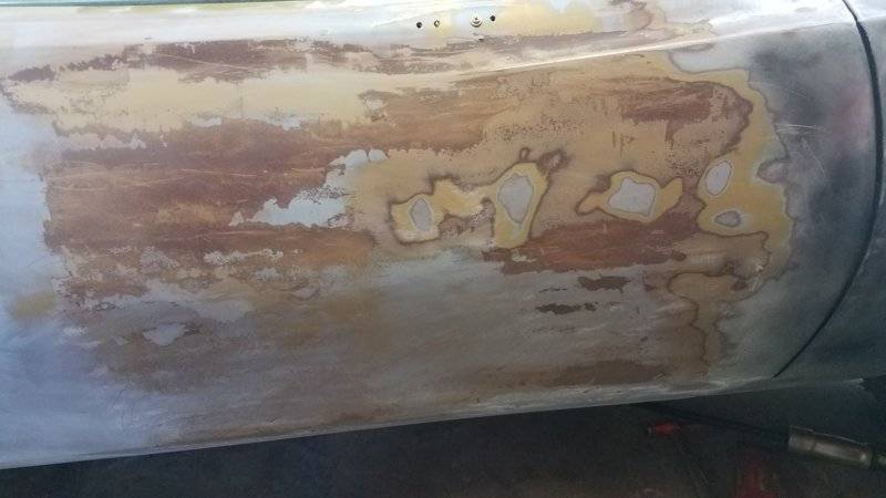

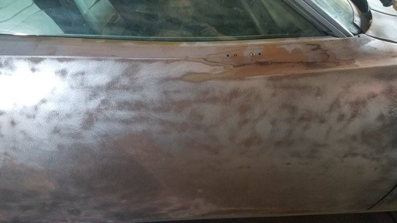

To slow down drying, try putting on a sheet of plastic over the coat of stripper. It will stay wet longer and let the chemicals penetrate deeper. Stripping is safer than sanding if the old paint is lead based.Tried some spray on paint stripper on my right door today.
Paint coming off one layer at a time. It's so hot I think it dries up before it can do its job.
