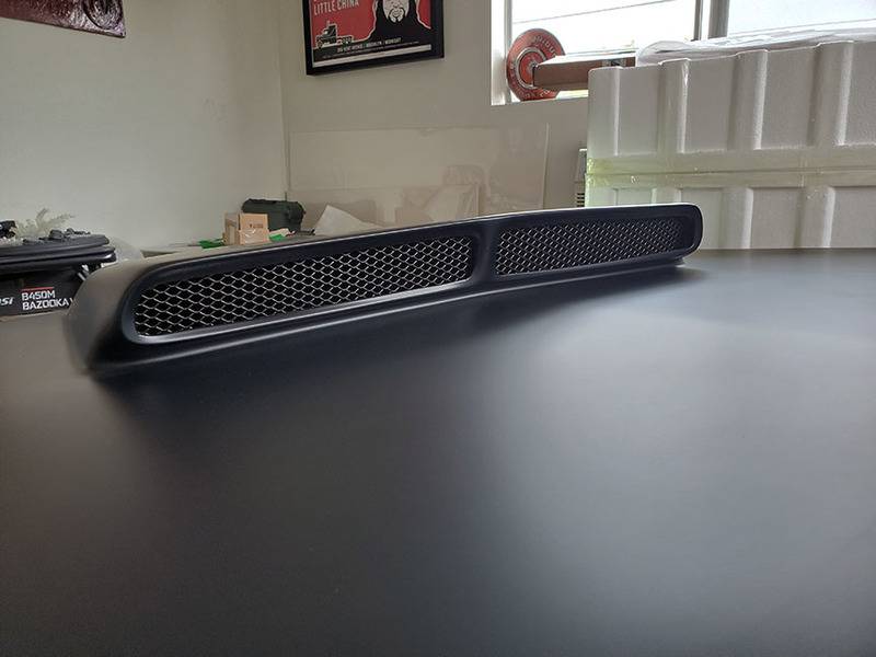

I decided to put a screen/grill on my hood scoop, I've had enough debris fly at my windshield to want to protect what's under my hood as the opening is large enough to let something in.
https://www.customcargrills.com/Diamond-Grill-Mesh.asp
6"x36" sheet, cut to size. That gives me enough for a second attempt if I need it.
Even though I made a cardboard template there was still a fair amount of cutting to size as the inside of the scoop is not all that uniform in shape and the mesh will need to be altered all around on each opening.
It was my plan to use rare earth magnets to hold it in place as they have a strong connection but they don't stick, so I may use a 2-part epoxy even though I wanted to be able to remove it.. I'll figure it out.
I like the way it looks though.
Have an old summit racing plastic sign, cut it down and glued closed cell foam to it. Cut the foam ( 2" thick stuff) so if we were out and it started to rain, just push it into the openings. Foam thick enough and stiff enough. Comes right out, foam does not scratch anything, reusable. wind keeps it in place, and the thick stuff keeps it from moving.

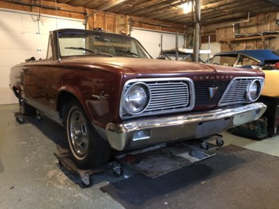

Do to the virus and everyone is going to die this week school closed ( drive school bus). So have 66 up off ground, Got my complete e-brk system parts, some desert Valley Auto parts, some new. Car has no e-brk of any kind. so will install pedal assembly all the way.

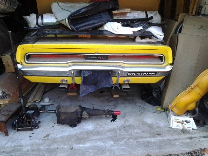

I pulled the 18 spline Hemi 4 speed transmission out of my 70 Charger R / T SE. I am going to have it freshened up for use in one of my other cars. This car will be getting one of those 855 5 speed transmissions when I get around to putting it back together. One of the u joint strap bolts broke off in the yoke,its going to be fun trying to get that out!

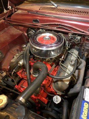

Had to veer off the B body path and get this car running. Thrashed the whole weekend getting things back in place. Happy to report, she’s running again. Bad news?....the 90 degree filter adapter is leaking, and she’s running richer than Paris Hilton’s allowance! Took the rest of the day off, I’m pooped!

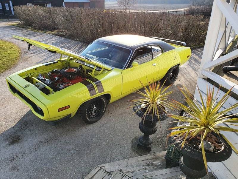

Adjusted the steering coupler.
Started it, drove it out the garage, drove it back in the garage,
Parked it - waiting for spring to arrive!
Mounted washed and correct seatbelts.
Now im just gonna look over the suspension and brakes!
And mount the 71 Gull wing instead of the go wing

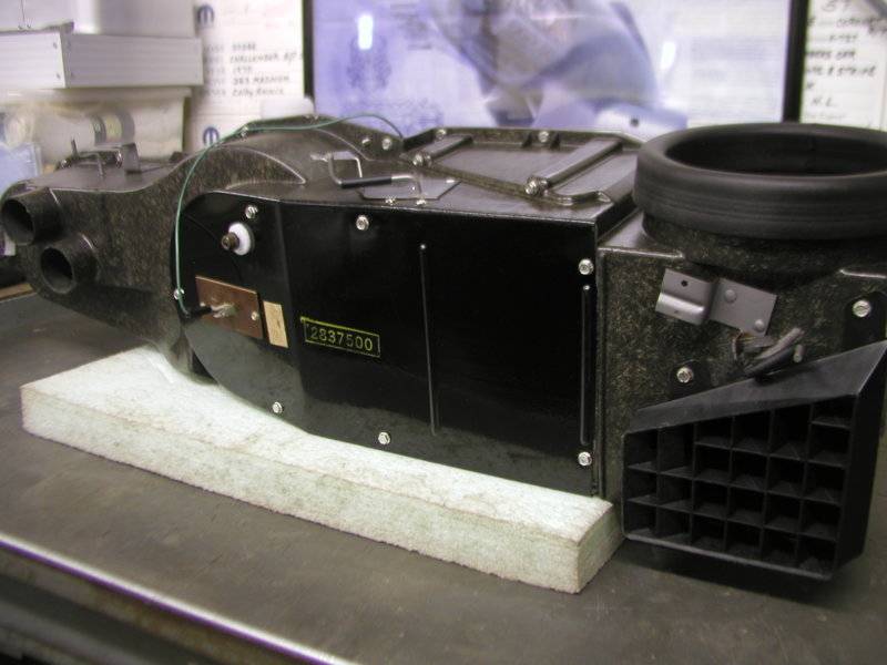

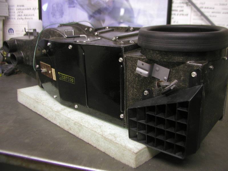

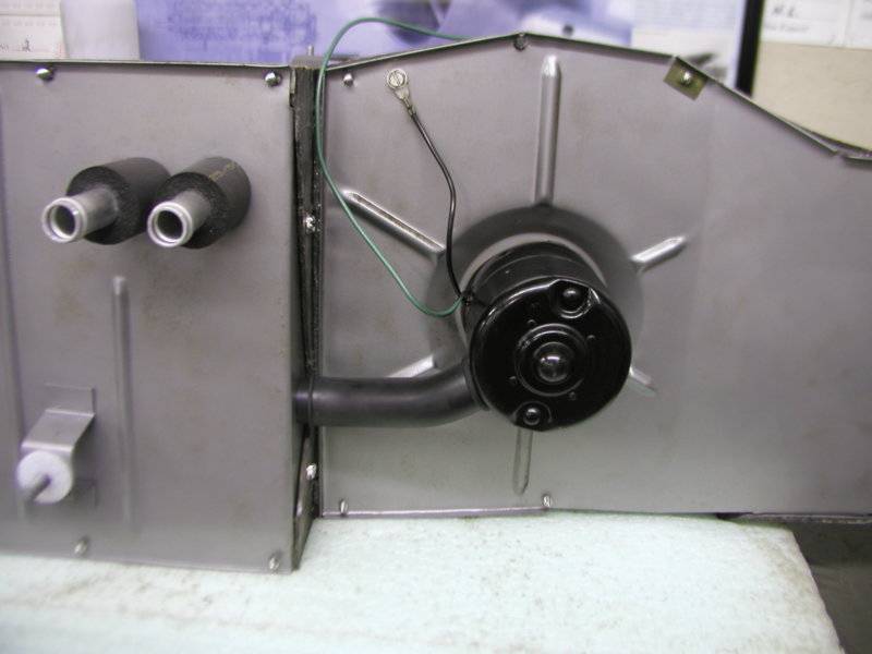

......I haven't refurbished a Mopar heater box but it looks way easier than my El Camino factory air and heater boxes.
Well, I haven't done an El Camino box either, so I can't tell you its easier or harder. I will tell you it is an absolute PITA getting the box out of the car and then back into the car. The actual refurb of the box once out, is not too bad.
This is on a fully assembled, running, driving car. Not a disassembled project car. There is a LOT of interior/dash stuff IN THE WAY and it gives you fits.
:mad::BangHead::mad::BangHead::mad::BangHead::mad::BangHead::mad::BangHead::mad::BangHead::mad::BangHead::mad::BangHead::mad::BangHead::mad:

Nice lookin' car! :thumbsup:
