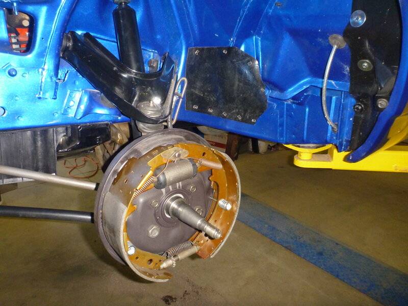

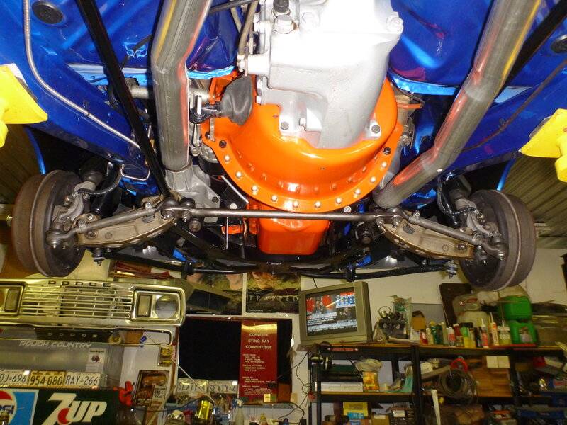

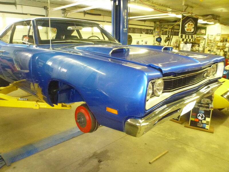

Pulled the hubs on the Bee and swapped sides (and readjusted the shoes) to determine two things. Is the right getting hot from tire scrub or a bad bearing and to see if that also makes the left brake grab now vs the right. So tomorrows test run, as it's already 36C today, will hopefully have the heat STAYING in the right wheel and the brake grab moving to the left and I'll at least know it's a drum issue for the brakes and that I have no bearings that are bad. I know I need an alignment touch up, but I'm not going anywhere near an alignment shop at this time.

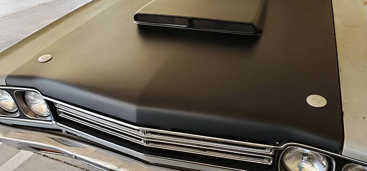

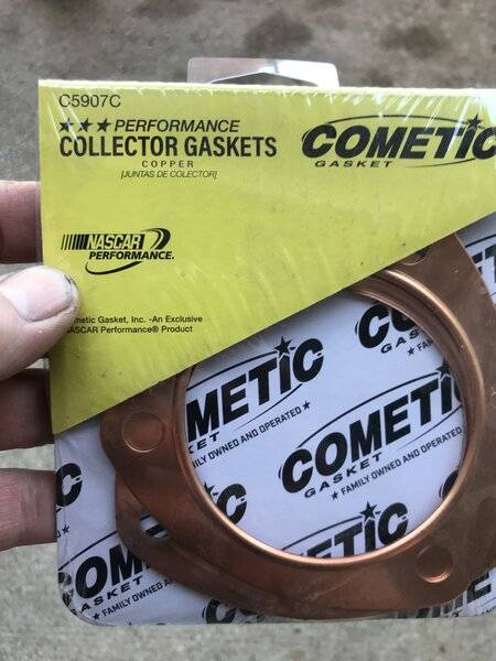

Pushed through the heat ( thank god I had the umbrella up) got it painted with the Eastwood rust encapsulater, matte black finish. Ran to O’Reilly between the first and second coat and got some new copper header collector gaskets. Darn things are made in China
