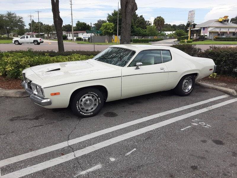

Adjusted the hood hinges, put the side molding back on and drove it to the grocery.
"Only" 92 degrees and 88% humidity (between sporadic showers).
Didn't even run the AC.

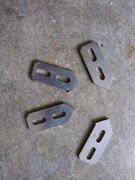

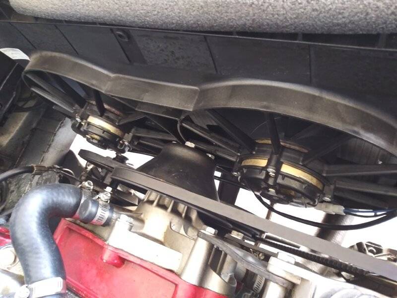

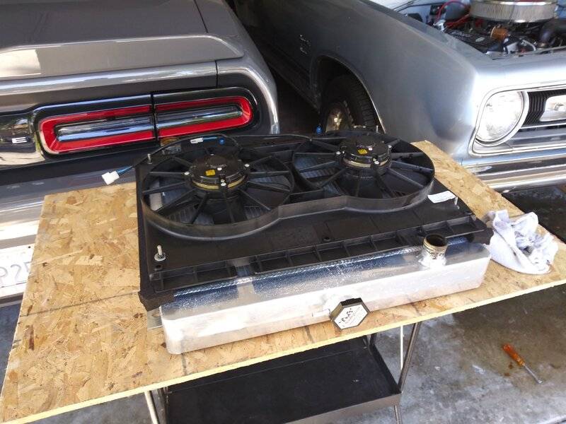

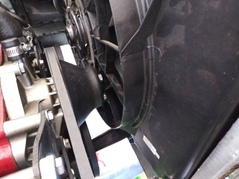

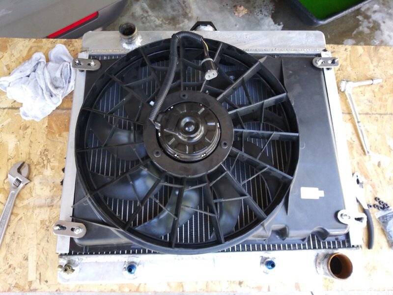

Started a few projects. ..the biggest being an electric fan swap.
I was running a 2 fan system that I felt wasn't moving enough air...so I am swapping it out for a single Taurus fan.

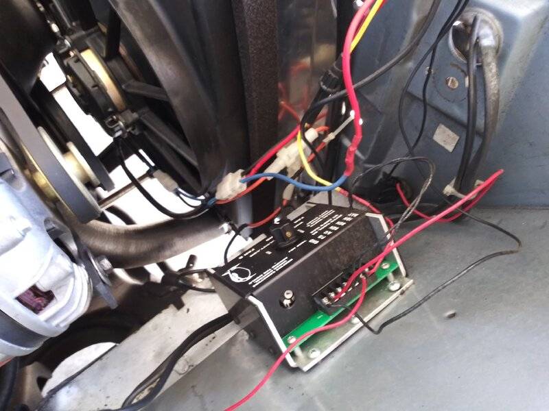

Not to mention I need to clean up my wiring. ...that is an AWESOME controller from Autocoolguy (Google it...) ...it "soft starts" the fan instead of nailing them full blast right off the start...

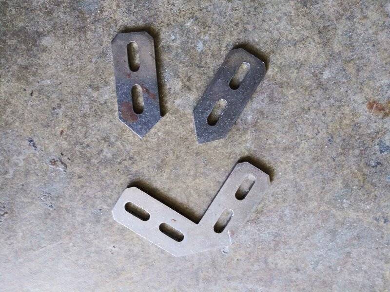

Anyway, I had to trim some plastic and make some simple brackets. ..
And as I figured, I'll have to trim more plastic to move the fan closer to the radiator to clear the water pump nose....
No big deal but it's well on the way to 100 degrees so I'll get back after it later...

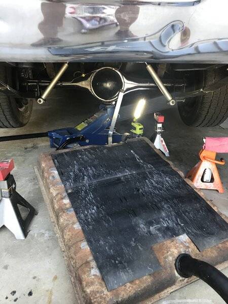

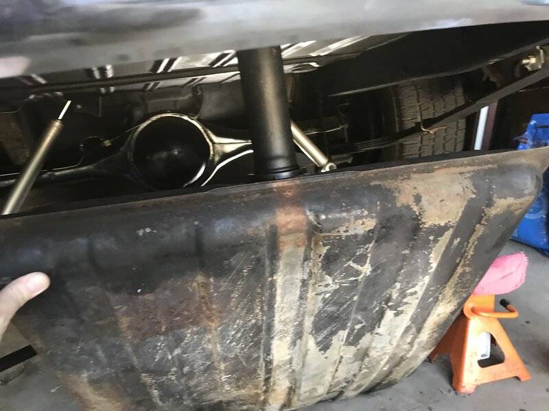

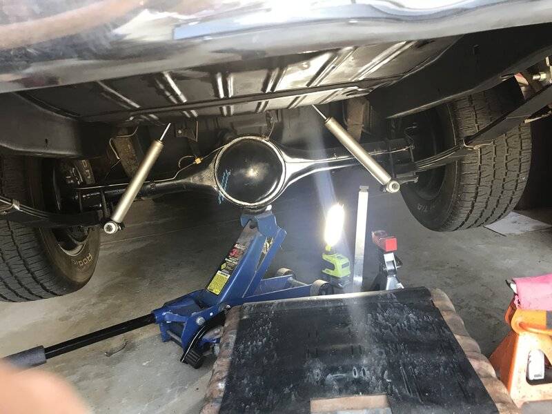

Put the gas tank back in Friday evening. Hot and muggy out. Loaded it with recycling Saturday morning and went for a ride, feels hotter that Friday. Running well, fuel gauge is working. I'll check the fuel filter after a couple drives and see if I got everything out of the tank.

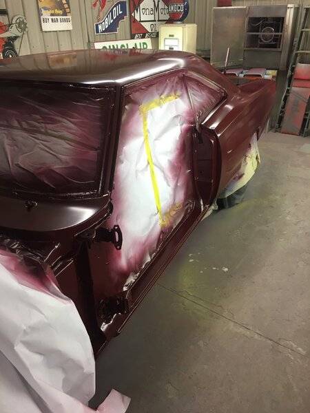

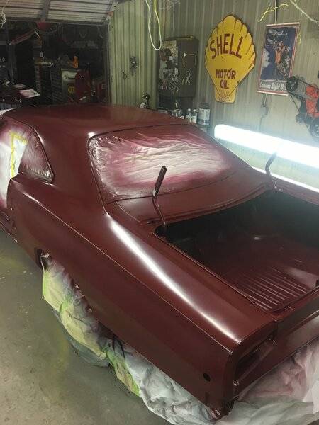

I finally got the body in color this weekend. Well, my paint guy did. He sent me the pictures around midnight. It was all I could do to not put on my britches and drive over to see it! Tomorrow we put the panels on, and get ready for clear.

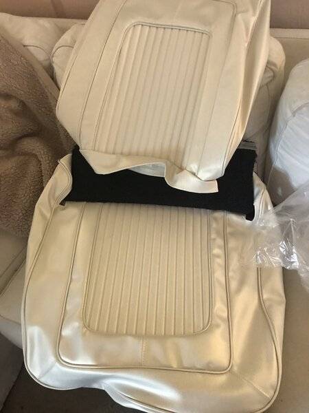

Got my bucket seat covers from Legendary Interiors yesterday. Unfortunately I didn't know that the seat backs are actually a separate piece, so I had to order those. :BangHead: I'll be waiting until the winter to do them anyway. I have to pull the bucket seats, all the door panels and the center console to take to the upholstery shop to have him switch all the old light tan carpet to Black. I also need to take the bucket seats apart so I can sand blast them, make sure no repairs are needed and paint them. I really don't want to have the car down for several weeks now that I have it on the road.

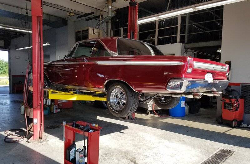

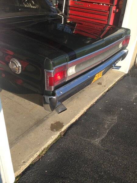

Friday I changed the oil & filter (Driven GP-1/10-40 & WIX 51515) tightened exhaust clamps and gave a general look-see underneath.
Then I changed the fuel filter.
Then I changed the fuel line that fed it because of course I had a full tank and when I pinched it off it got nicked and started misting the side of my engine.
And I bumped up the insured value with Hagerty.
