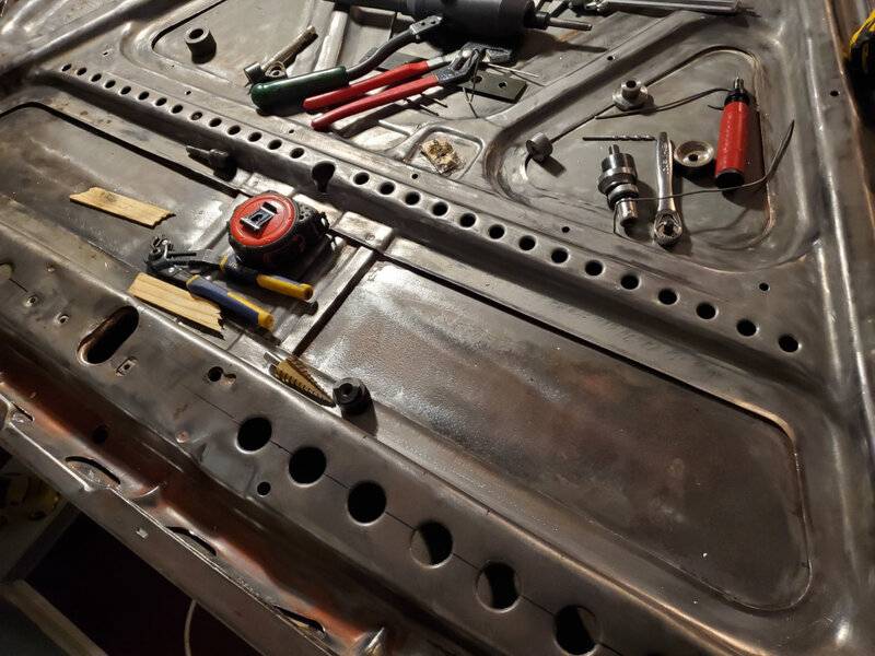

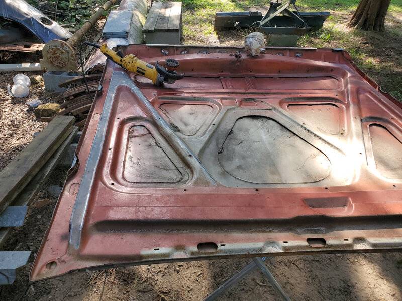

On to the next project . . . the Hood . . .
Here's what I've got to work with . . . just started . . .

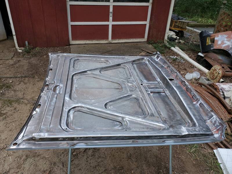

After 2 hours with an "old" cup type wire knotted wheel . . . progress was slow . . .
So I went and get a "new" one and tore into it . . . MUCH BETTER !
Note to self - buy a NEW wire wheel when starting a new project . . .
Now to figure out the layout of the holes . . . looks like I might be fabricating a new dimple die for this project too
Created a 1" and a 1/2" dimple die for the trunk lid project ( needed to fit into the tight locations)

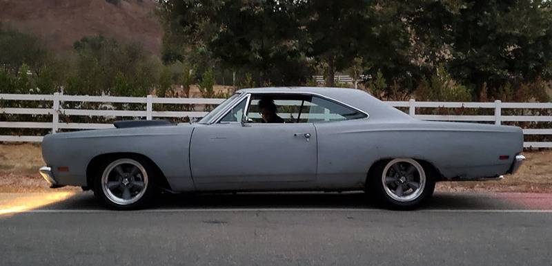

Another canyon, p.c.h. drive this AM. Approx. 2 hrs (+/-) and 75+ miles.
Mullholland Highway.
Definitely need to up the firmness/rebound on the front shocks with the 2" drop spindles.
Wilson ported RPM intake and 1" tapered spacer helps the motor do so much better on the street, fwy driving just as good.

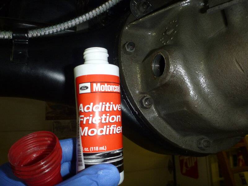

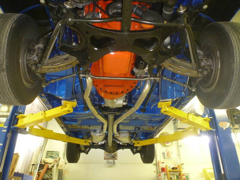

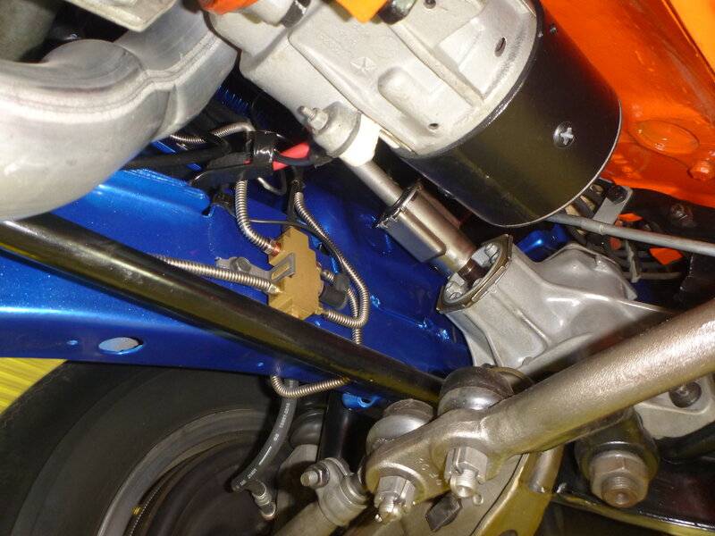

About 1000 miles on her now, on the hoist to take 4 ounces out and then adding 4 oz of stink to the rear end to hopefully end the complaining noise after she's hot. Looking pretty good underneath after 1000 miles and living on a gravel road to boot. Looks like all that "RPM" and clearing work was well worth it. Was supposed to be sunny all day and was ready for a drive, walked outside and someone closed the "roof". Hopefully the ugliness goes by without dropping moisture.

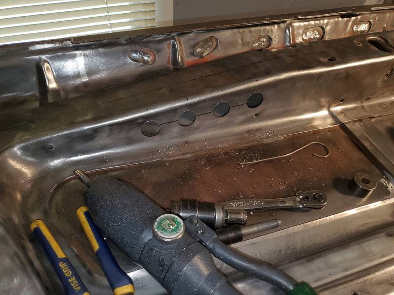

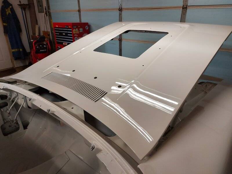

Mad Scientist Build . . . Hood fabrication to match the trunk lid . . .
With no "easy" access holes, like in the trunk, getting started on this hood was a whole lot harder . . . everything is blind and no way to get to the back side to hold the cutting parts . . .
But I've finally figured it out and now I'm making some progress . . . . the first set of 4 holes took me 2 hours . . .
BUT . . . got them done . . . Oh, the 4 holes are to match the trunk lid and like them both look like "maybe" there was some planning in the layout . . . maybe ? ! ?

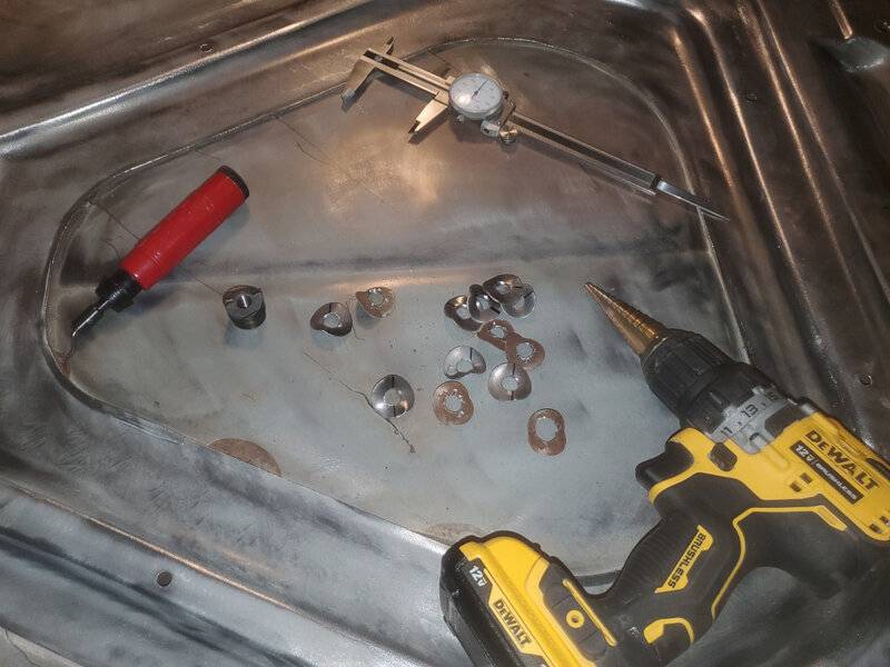

You can see the bottom of the dimple die in the hole - and see that there is very little access to work with it and get it attached to the tool to make it work . . .
In comparison, the next 9 holes were done in less than and hour . . .
And I'm starting a new collecting of cut outs for the hood - not that it'll remove a lot of weight
Now it's time to get back it, got a lot more holes to get in the hood and get them dimpled

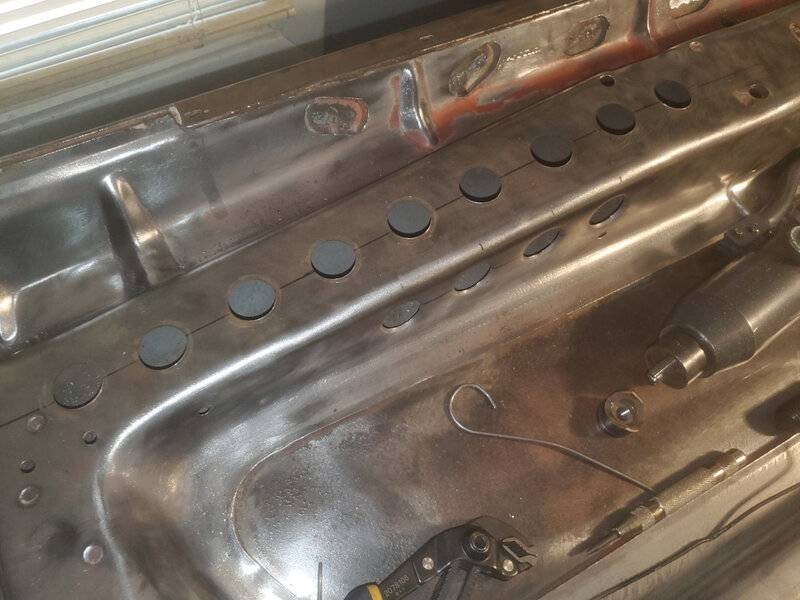

With all the rain from Hurricane/Storm Sally . . . I got a chance to "try" and focus on getting more done on the hood . . .
Working in these confined spaces, with holes so small I can't get my fingers through . . . means being creative . . . and finding method that will work.
But . . . got the next line of holes completed today . . . ( thanks to the rain )
Got more holes to get drilled, punched, and dimpled on this project . . .
