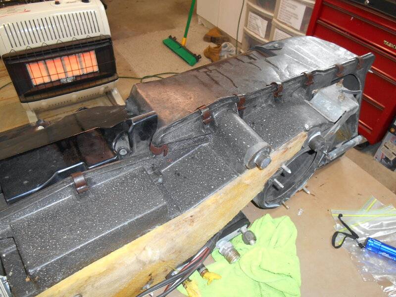

Got the a/c heater box out today. 47 years of crap in and on it.

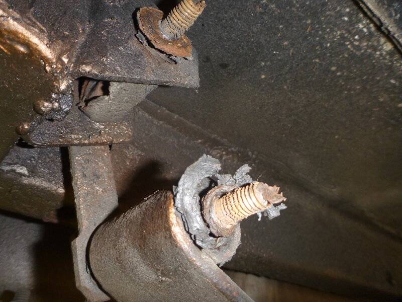

I installed an eye bolt in my garage floor and used a turn buckle to pull the header down away from touching the torsion bar today. Glad that's finally done.

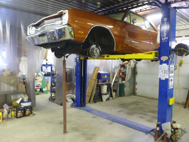

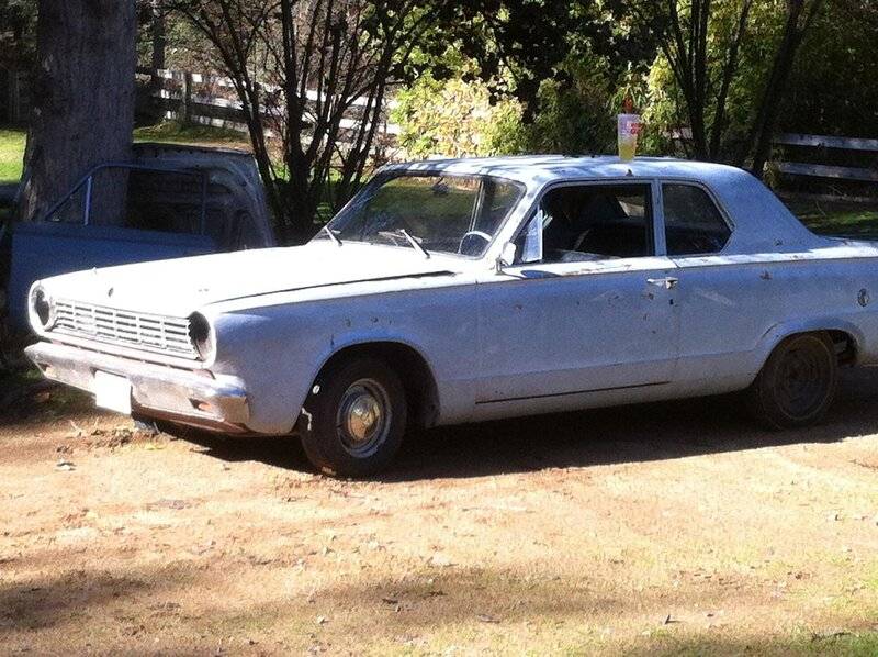

I had a 65 Dart for sale on ebay a few weeks ago. I picked it up in 2015 in non running condition for a cheap price.
I piddled with the car in between other projects, tinkering with the various inoperable things on the car. It was a slant six car that was converted to a V8 but wasn't finished.
I put in the V8 center link, got the car running, put in dual exhaust, added front disc brakes and did body and paint in the Spring of 2019. I was lazy about trying to sell it but when I decided that I wanted to convert my Charger to a Tremec 5 speed, I figured that this Dart might pay for most of the swap.
With the car on ebay, a bidder emailed asking about rust and underbody condition. I put the car up on the lift and while the underbody was great, I did find that there were some rust bubbles coming through the fairly fresh paint.
I cut out the rust and patched in good metal. A little filler, primer....
Today I painted and clearcoated the repair. I hope to have it relisted for sale soon. Dart 3.jpg Dart 9 G.jpg

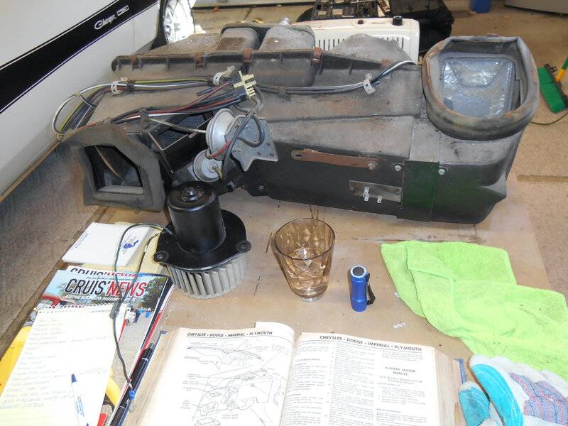

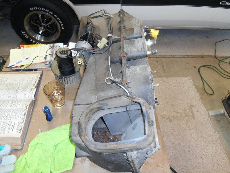

Soaked the clips with oil on the heater a/c box for a couple of days and it came apart without any issues.
Only had a little bit of debris. No critter nest luckily.
Now just need to find a radiator shop to pressure test both. If they're bad will have to order new ones.

Funny how long they went without a cabin air filter to catch all the crap that gets stuck inside the box.

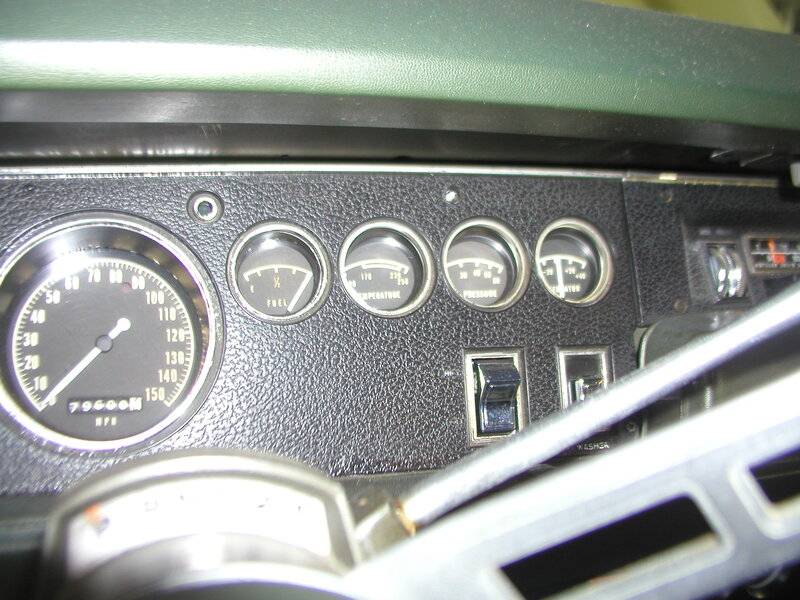

For about the last month or so the fuel gauge on the R/T has been intermittently working/not working while out cruising around. It finally quit altogether the last time out. So today, I decided it was time to do a little troubleshooting to find where the issue was.
First was to get the car up in the air..........
Then I attached the decade box to the sender wire at the tank and dialed in 10 ohms..........
Turn the key on and check the results.........
As I suspected, wiring and instruments are fine. The problem is in the tank, either the float is no longer a float, or the sender VR has given up the ghost.
