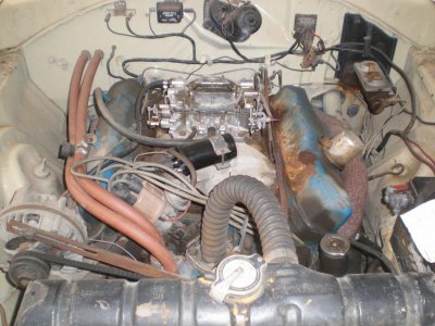

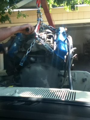

Pulled the engine and trans, replaced with another engine (10,000 miles) and rebuilt trans. Still have work to do with other things to but back on but its in. First is what was coming out and the last is a start of what is going in. :hello2:

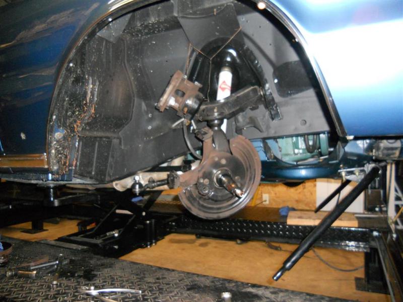

Ordered my new tires today, and started work on another ugly problem. Since I changed out the front suspension bushings to the PolyGraphite parts, I haven't been able to keep the front end toe-in consistant. Seems when you change out the lower control arm bushings and the front strut rod bushings, the lower arms are no longer locked into position as firmly as with stock bushings. So to combat this situation before the new tires are installed, I am going for the Firm Feel adjustable strut rods and hopefully gain some additional positive caster while locking the lower pivot in place. Here's a link for the part http://www.firmfeel.com/adjstrut.htm and some pics of the project. BTW, everything sure comes apart a lot easier when its only been together for 2 years and 3,000 miles.

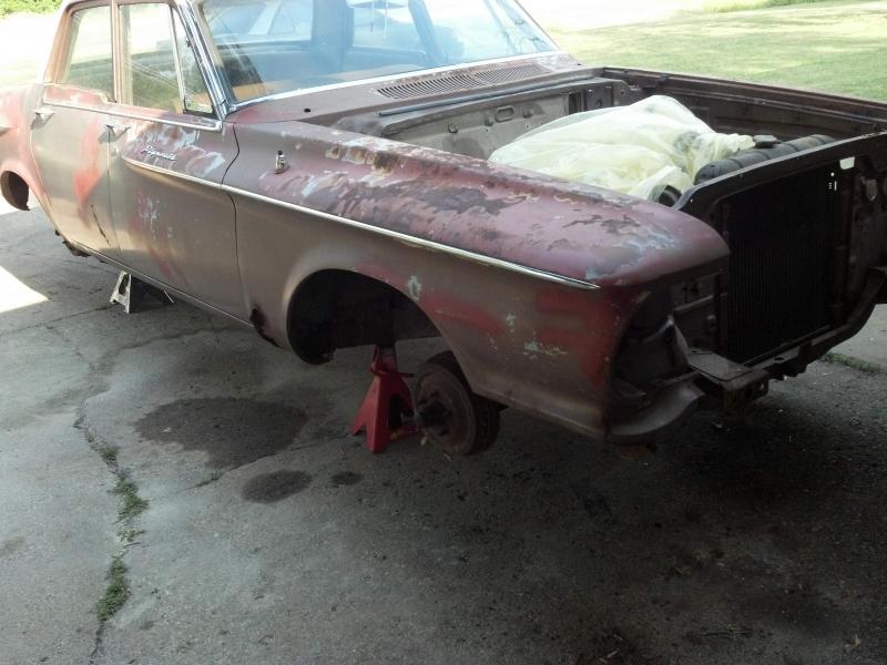

taking apart the parts car

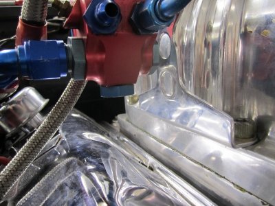

I got my headers reinstalled and finished my fuel lines:happy7:
