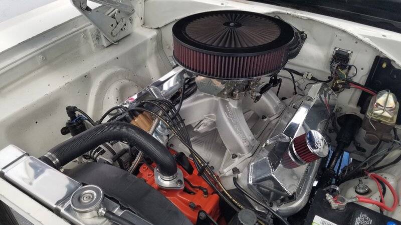

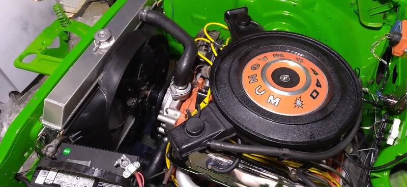

Got a shroud on and finally have a normal operating temp. Carb and timing done also. On to the next thing

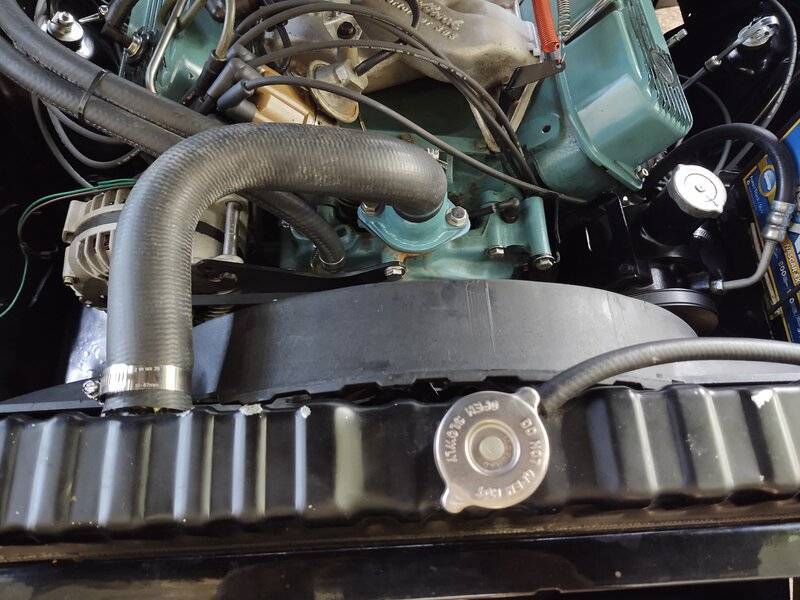

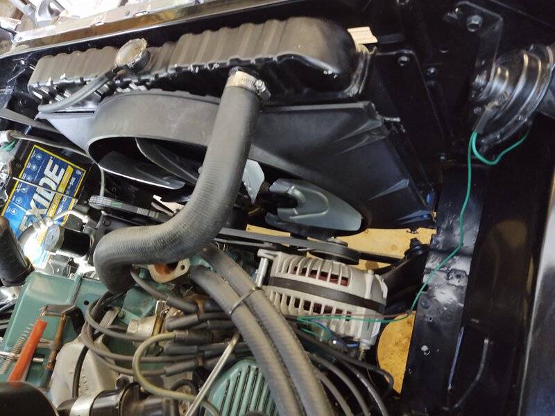

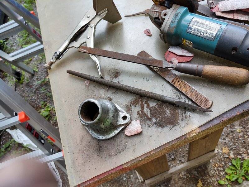

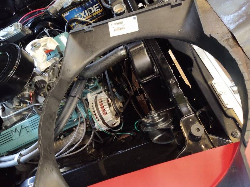

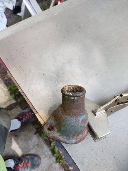

I started getting the satellite ready for Carlisle.

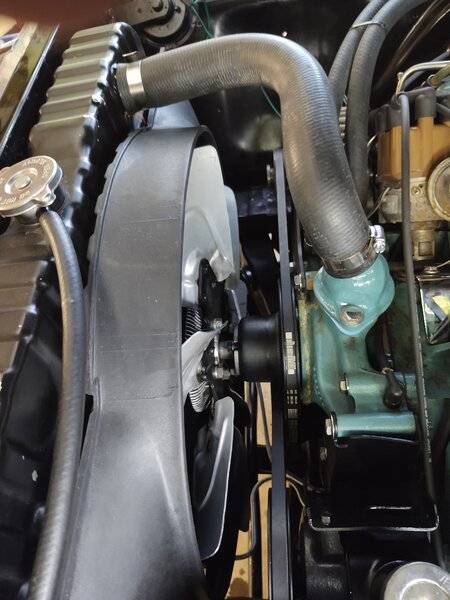

Switching the thermostat outlet to the factory cast iron and installing a shroud.
Coolant had more rust in it than I expected.
That is a great looking car.! Is it fast? Sure looks the part.
Thanks.
It seems fast to me. Nothing like some of the guys on here though.
7.80 1/8 mile, around 88-89 mph.
Haven't had it on the 1/4 lately, but should be low to mid 12's.
I made so many changes over the winter I'm still trying to get used to it again.

Last evening I put it back together.
A gallon of white vinegar and no thermostat just for a few hours of driving.
We'll see how much rust comes out.

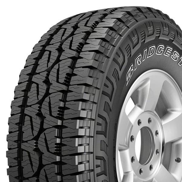

I put Bridgestone Dueler A/T Revo3 on my 2500 about 2 years ago. LOVE them. 10 ply, wearing like iron, ride great, excellent fuel economy, great traction wet, dry, snow, or off-pavement. I run 80psi all around, no issues. Mounted mine black sidewall, not white letter.
ges%2Fbridgestone%2Fitems%2Fbridgestone-dueler-a-t-revo-3-with-outlined-white-lettering-close-up.jpg
Can't hear a peep out of them...but, it is a Cummins, so....
These are NOT mud-terrains. They're a highway tire with some bite when you need it.
I did turn a buddy on to them and he put a set on his Wrangler, and loves them.
