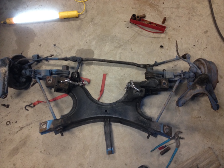

Took out K Frame, what a mess
Hope I can get it back together once I tear it apart. lol
Took the K to get powder coated. waiting for the rest of the parts to arrive.
PST/Moog/just Suspension and more.

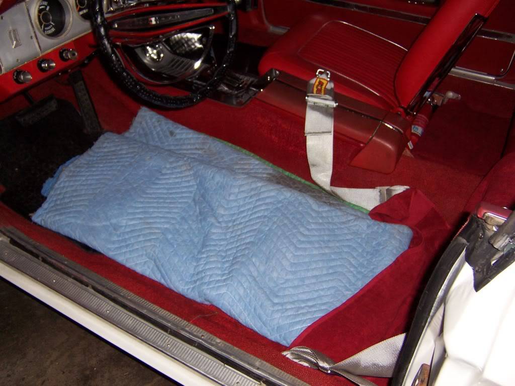

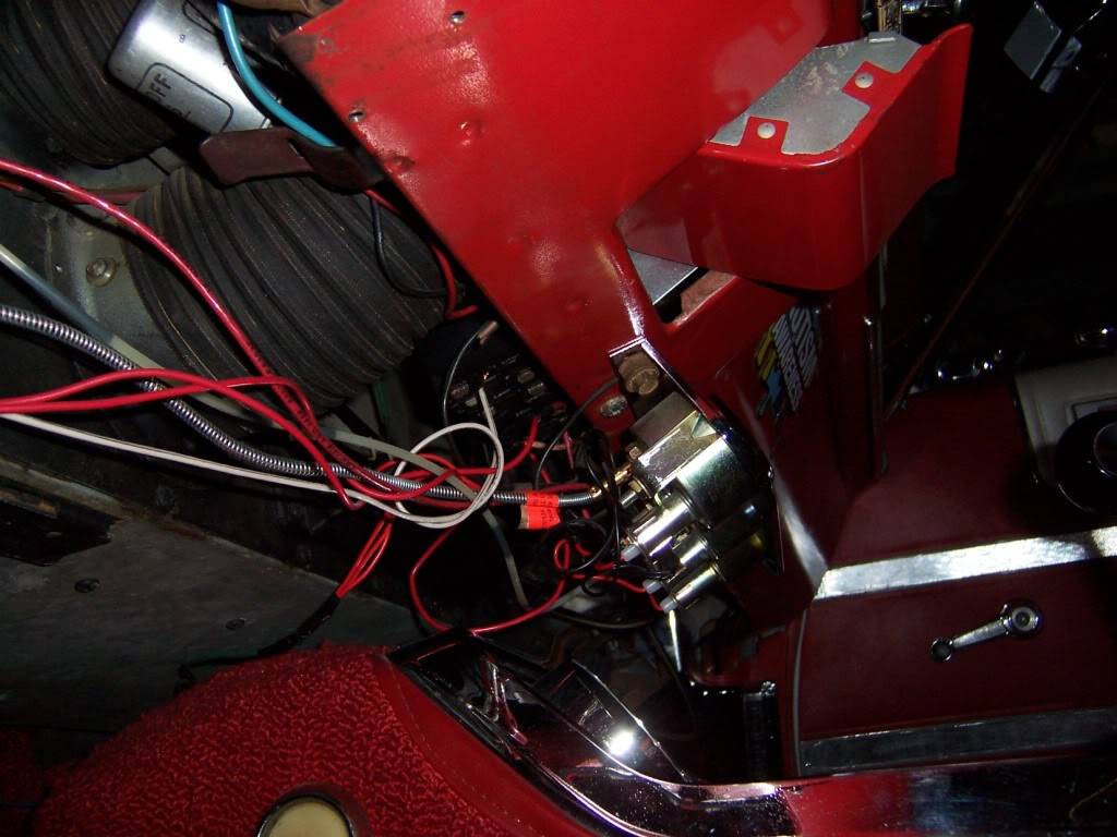

Got started on the gauge replacement/wiring repair.
1)Act like it's Christmas in July,as Santa Summit(via the FedEx sleigh) sent me(OK;the car) some shiny baubles. Sabrina likes shiny baubles,but only functional ones.
2) Prepared the work area. Helluva lot easier job to do with the seat removed.
3) Peruse fustercluck under the dash;curse past owners-again-and plan attack.
4)Consult with assistant,Louie the(neighbor's) cat.
Louie decided to go to sleep in the back seat while I got started;lotta bloody help he is. At least he doesn't critique my work.
Also was a good time to install some of the nice RCI harness I bought from SSR. I'll feel more secure than with the old original stuff. Oh Chris;are those up for a re-cert?
Well;back to it. Pics when done-hopefully tonight!

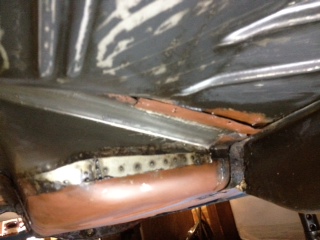

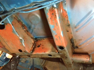

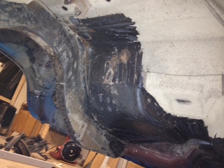

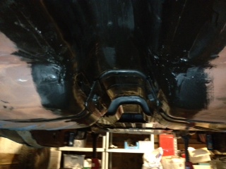

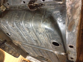

Cleaned the underside
Well, just finished shedding about 50lbs or better off the bottom. Cleaned and now painting with POR 15. I debated what to do and just decided to paint the bottom and undercoat wheel wells only. I can still paint it body color since the POR 15 is paintable.There is no rust left on the car. It also has the back half of a 4 door o it so there are some scars from that which I used seam sealer on.

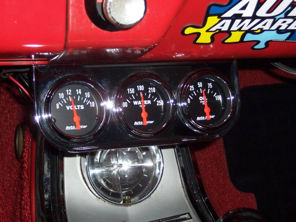

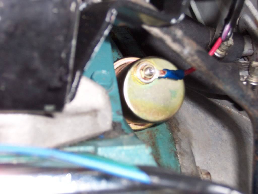

Well,without the help(?) of my assistant,Louie(off chasing rabbits),I finished the gauge installation. Cleaned up the wiring mess as well. Also discovered a couple of things that may help someone else.
First,I had both the oil pressure gauge and the dash o.p light wired to the Auto-Meter sending unit. Fired the car up and no needle movement on the gauge,and the dash light was glowing. Hmmm...removed the wire for the idiot light,fired her back up and Voila! Oil pressure! Since I do want the dash light as well,I may have to make up a "T" arrangement to use both the A-M sending unit and the OEM style.
This was also nice to see:
My other issue is a possible voltage drain. I say possible;my gauge reads approximately 11.5-12 volts(after the pic was taken;it looks like 12.5 in the pic,but it dropped a bit),and it seems like I should see 12.5-13 when running. Double checked my connections,but something doesn't seem right. I'll have to get out and drive it and see if the battery drains.
