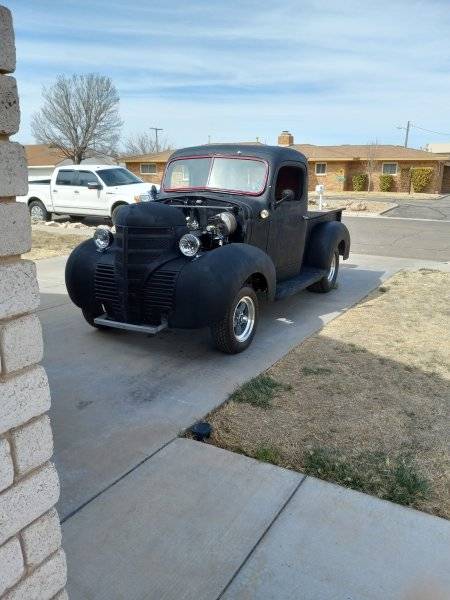

Getting the old Plymouth ready for
a level III vin inspection.
All modern equipment must be
installed and operational.
Horn, lights, wiper, Ebrake, seatbelts,
turn Signals, marker lamps, backup
and license plate light. Some of these
did not come as standard equipment
on a 1940 Truck.
My favorite truck, I learned to drive in my grandaddies 41 3/4 ton flatbed in 1958. If i cleaned up sawdust in his shop I could drive the truck down in back field to dump it.

We did not have Plymouth trucks in Canada. We had Fargo instead, sold by Plymouth dealers.

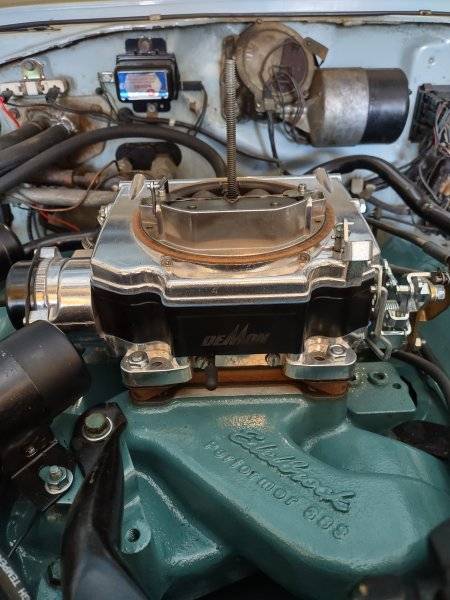

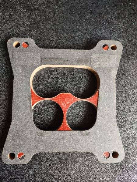

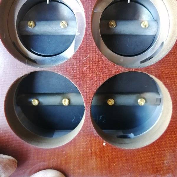

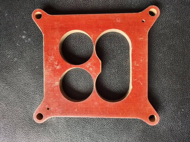

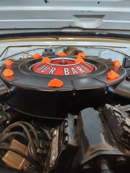

A detail job today. I was running a 1/4 inch fiber insulator under the carb. I had tried my 1/2 inch 4 hole phenolic spacer, but the air cleaner rubbed the hood bracing. Since I switched to the drop base and taller air filter, I figured it should fit now. I decided to cut out the secondary bores to match the street demon goggle valve secondary. The air cleaner clears the hood fine now.
