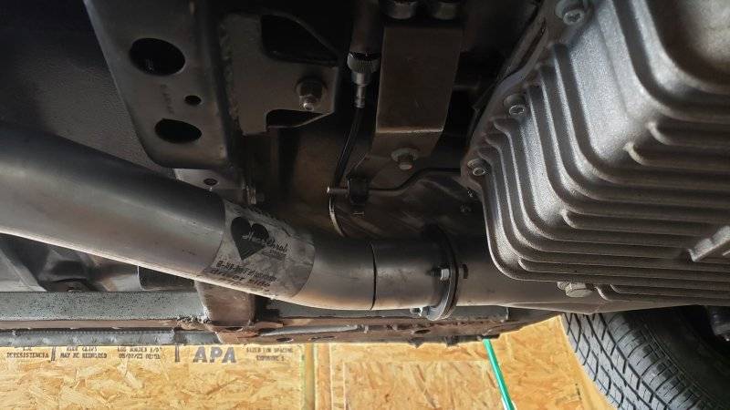

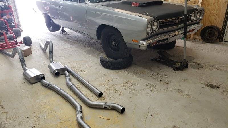

Started replacing my 2.5" exhaust with 3". Got a kit from Jegs and 2 Ultra Flow mufflers. Had to make the driver side shorter to get it through the trans cross brace. I'll finish fitting it tomorrow and get it welded up including a crossover pipe and o2 bung.

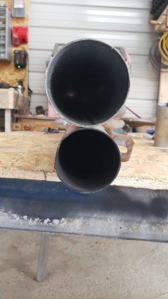

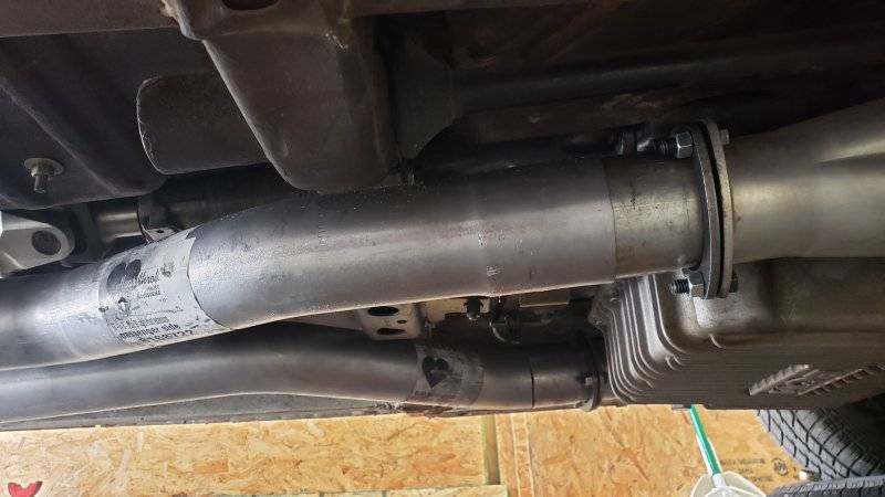

Is it possible to take a pic of a 2.5" vs. 3" pipe, end section for comparison?
It's rather remarkable, more than most folks think it is....
Oh, and be prepared for some increased interior temperatures with the 3"!

You ask and you shall receive. :)
So area of a 3" circle is 7.07 sq/in. Area of a 2.5" circle is 4.91 sq/in. Volume of a 3" tube 8' long is 678.58 sq/in. Volume of a 2.5" tube 8' is 471.24 sq/in.
And the modifications to the Jegs B body kit are endless. The over axle pipe needs cut and a harder bend put in. Old 2.5" pipe below for reference. It's what I'm basing my modifications on.
Thanks! Yep, that's my point - that little ol' half inch in diameter gives like 50% more flow/volume,

Finished it up today. I think I have a piece touching the trans crossmember. Of course it was fine until I welded it up. I'll deal with it tomorrow.

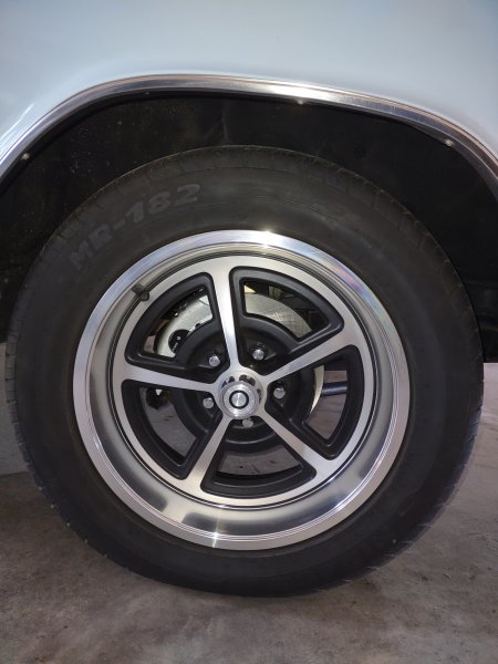

Finished the front disc brake conversion and got the wheels back on.

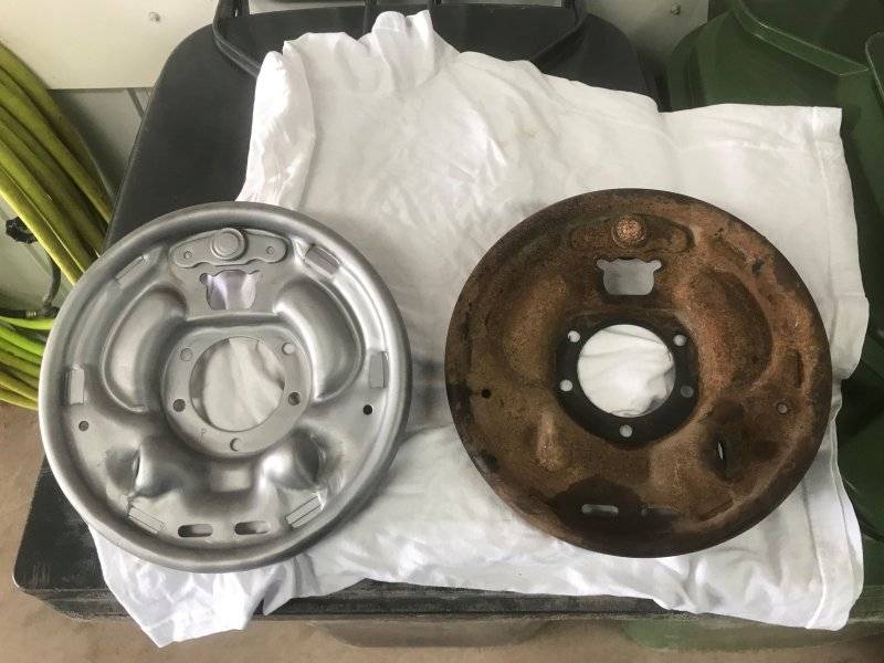

Up bright and early this morning. Time to tackle the rear end. Took a page out of Wayne's playbook aka dadsbee. I might have mentioned before, I really love my media blaster!
Started with this...
ended up with this, ready to blast.
