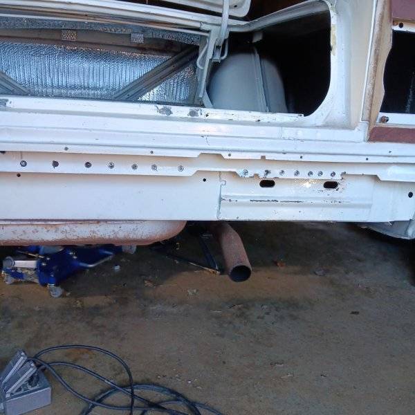

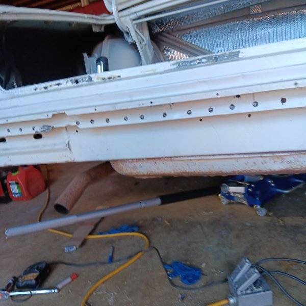

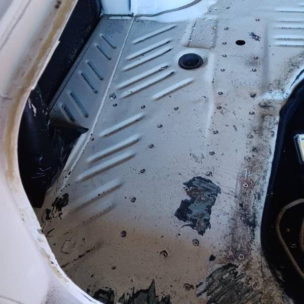

Drilling spotwelds...a very tiring task. I'm removing the entire panel, making a new flat panel for the fuel cell/pump mounting and plug-welding the new one in place, HOPEFULLY to look OEM. But, we'll see?! An original Southern Tennesee car, no undercoating & rust-free, never crashed, very straight 318/727/8-3/4 Belvedere II car I picked up in July. From what I was told, this car had been on FB Marketplace for 3 years with no takers. I looked at it a year before but I hadn't sold the Whale at the time and other circumstances kept me from buying it. Nonetheless, it must have had my name on it!?!

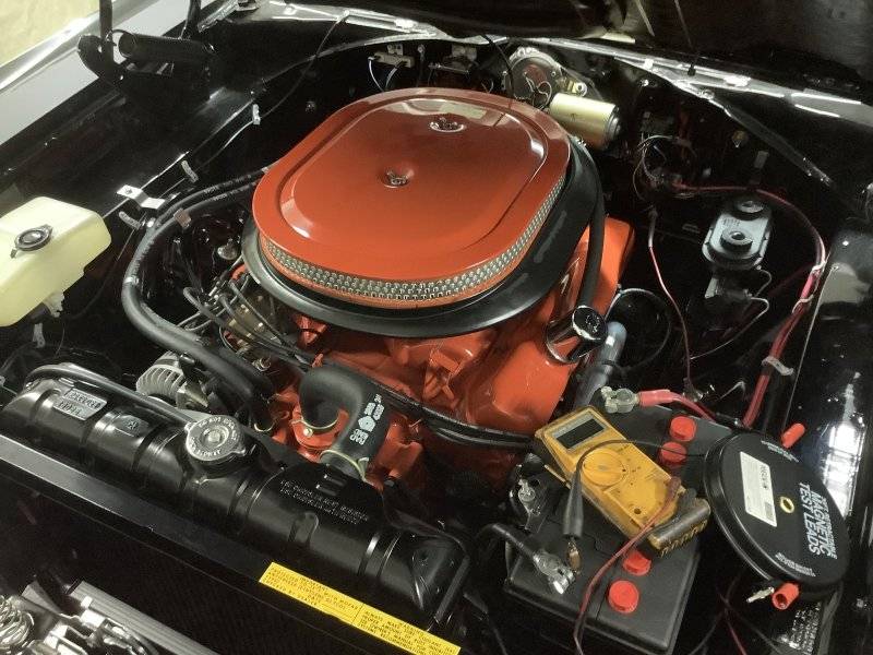

When I fired up my GTX last weekend it wouldn’t crank with the key, I had to bypass the starter relay on the firewall. After some basic troubleshooting I determined that the NSS has failed. There’s no continuity to ground at the brown wire on the relay with the trans in P or N. It cranked with the key after I grounded the terminal with a jumper. I just ordered a USA made replacement from Rick E’s eBay store, it should show up sometime next week.

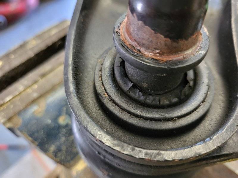

Finally got time to start on the front suspension rebuild. 30+ yr old bushings need to be replaced. Took off the sway bar and pass. side T-Bar and LCA. My HF shop press made pressing the pin out easy and a cut-off wheel made quick work of the inner bushing sleeve, but needed a hacksaw and chisel to get the outer sleeve out. Had to stop and get cleaned up for dinner guests so hoping to get back on it tomorrow.

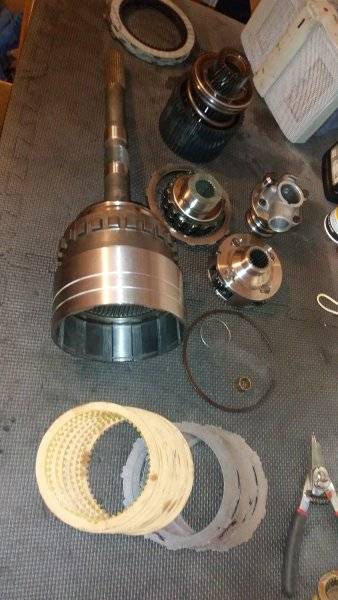

Started overdrive reassembly of a complete 518 rebuild for a friend's '32 Ford Street Rod with an early Chrysler Hemi.

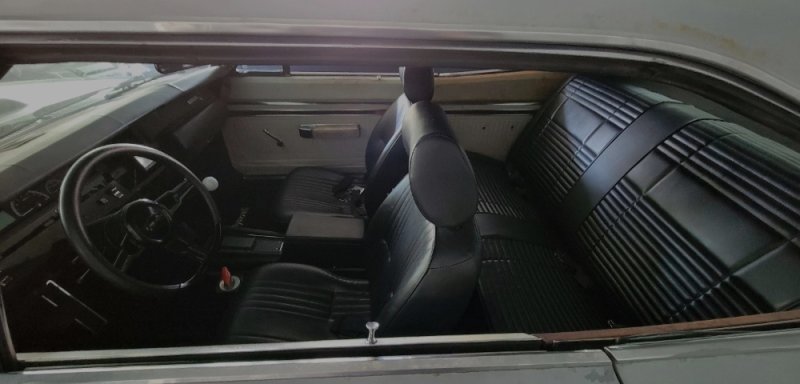

After working on my interior every day all last week, spent a couple of hours and finally finished today.
Long overdue, after installing the TKX 5-Speed & Sniper EFI Q1-2 2023 it'll be nice to have a clean interior with all insulation in place.
You are a braver man than I. I have only worked on one of those, for a project my son had. I rebuilt the 727 style front end, and I took the O.D. chunk to my local Dodge store to let the pro's rebuild it.
