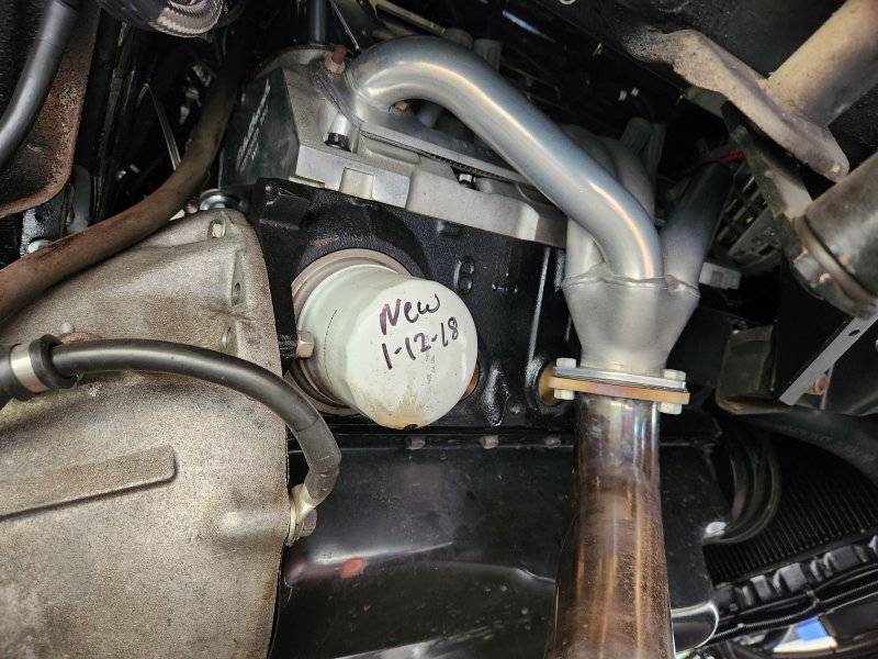

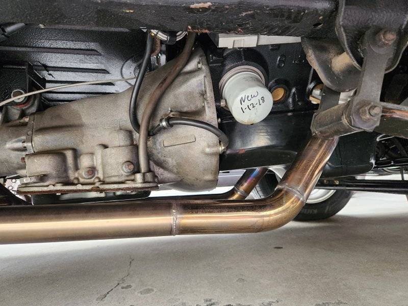

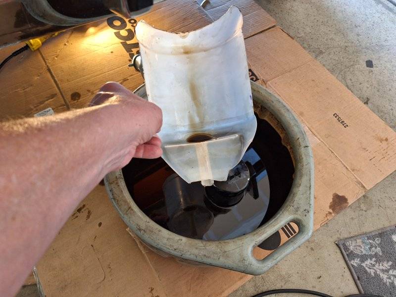

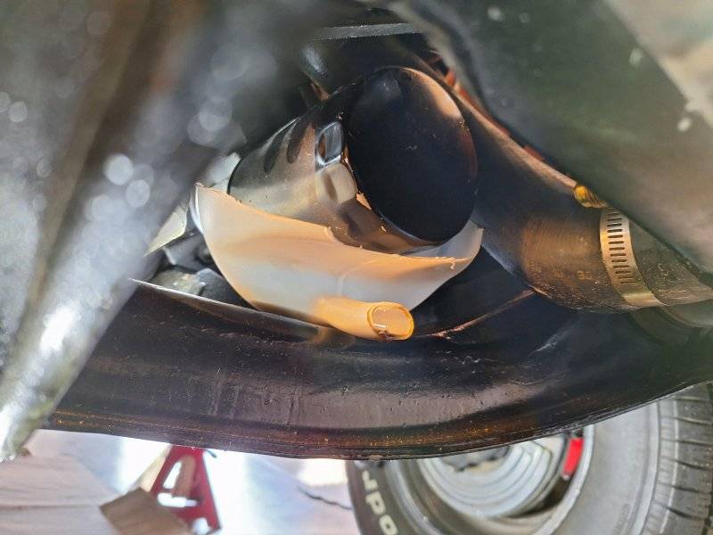

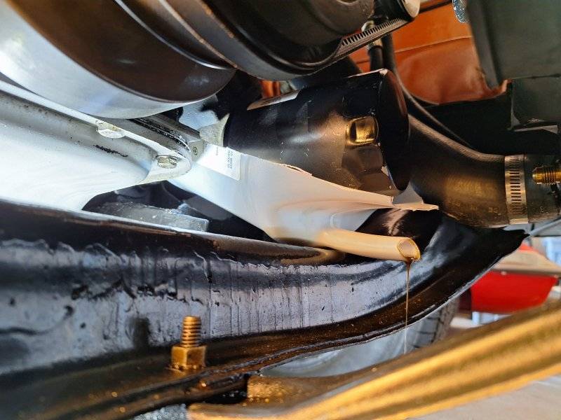

Changed the oil and filter on the Coronet. Pretty routine, but this time I used a homemade funnel for the oil filter, the idea was pilfered from a @dadsbee thread. Cut a plastic jug in half and placed it under the filter. The hollow handle makes a perfect spout. No more oil spilled on the K-member.
Valvoline VR1 10W-30 and WIX 51515 filter.

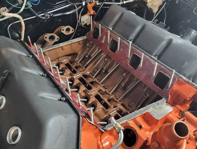

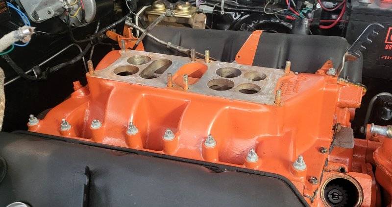

Getting my car back together.
Swapped the intake fasteners over to studs . Mainly to guide the intake straight down and ease to torque it down.
I'm on my 3rd round of tightening it so far today.
Hopefully I will have it torqued tight by end of the day.
Then will go back over them a few times once engine has had a couple heat cycles..
Probably be late next week before I get to fire it back up though.

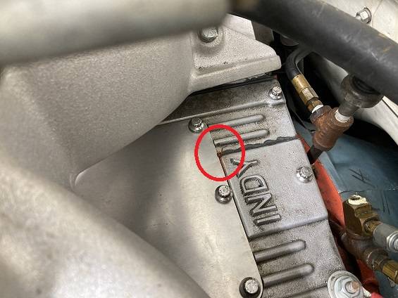

Hopefully fixed an oil leak where the 3 pieces of the valley plate meet. Made this 3 piece from their 2 pc more than 20 yrs ago, before they offered a 3 pc.

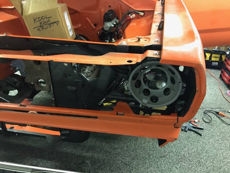

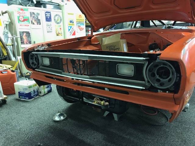

Trial fitting the nose of my Duster. No grill, till I install the engine....

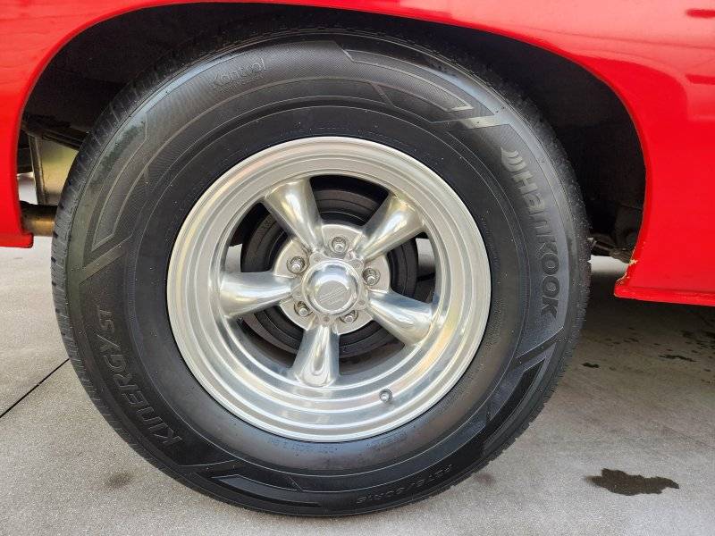

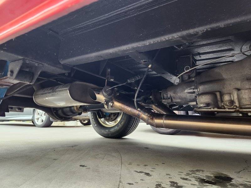

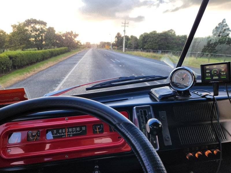

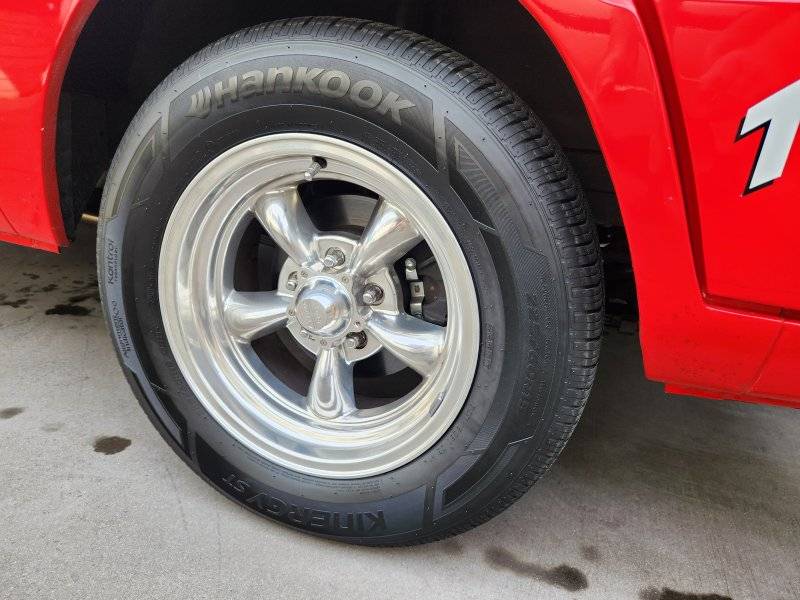

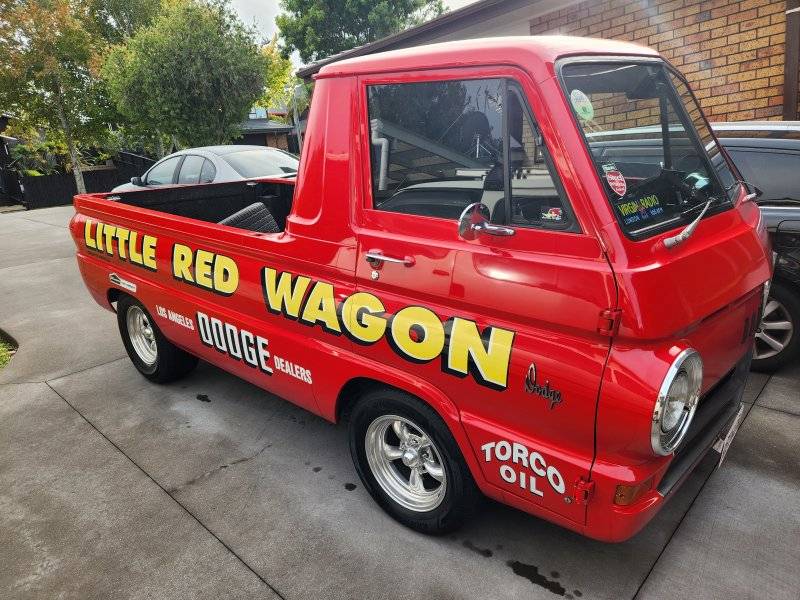

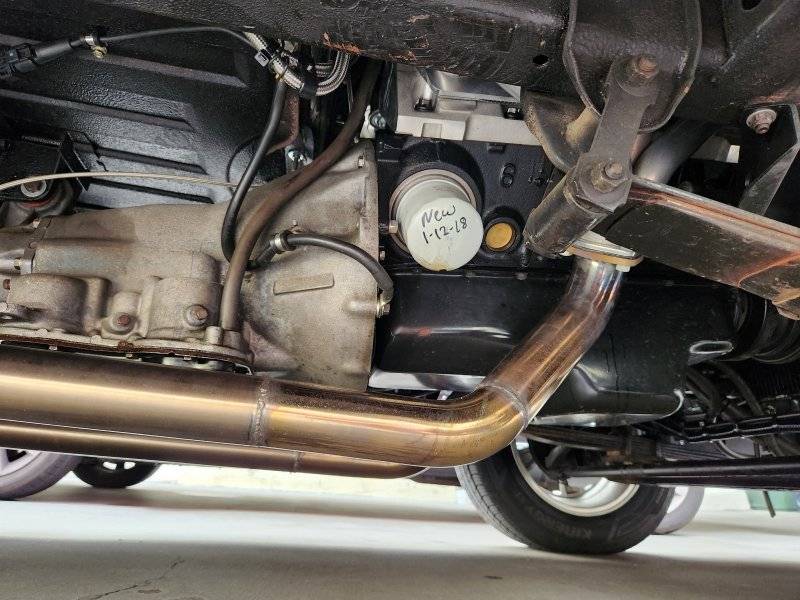

Brought my toy home....been away for a week getting some "throat and feet" treatment.
New tyres (tires for you Colonial types) and new exhaust headers along with some re-jigging. I bought a set of Patriot hugger style headers last year, and had them coated inside & out locally, and have been waiting a long time now to get them fitted. So at last they went on, and the Hooker Super Comps are going up for sale locally in NZ. The Patriot headers take up less space, and hopefully will reduce the heat build-up inside the doghouse.
I have not noticed any loss of power (by my "seat of the pants gauge") but I have noticed a significant loss of engine noise...much quieter while driving now.
The bonus is also the entire exhaust is now stainless steel except for the repro tips off 68-70 Chargers.

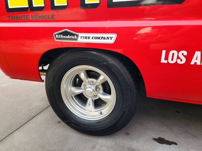

New tyres are Hancook's .... 225x60x15 up front and 275x60x15 out the back. They feel nice on the road, and I only managed a small squeak off the line at a traffic light once....accidentally of course......lol

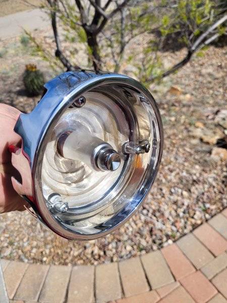

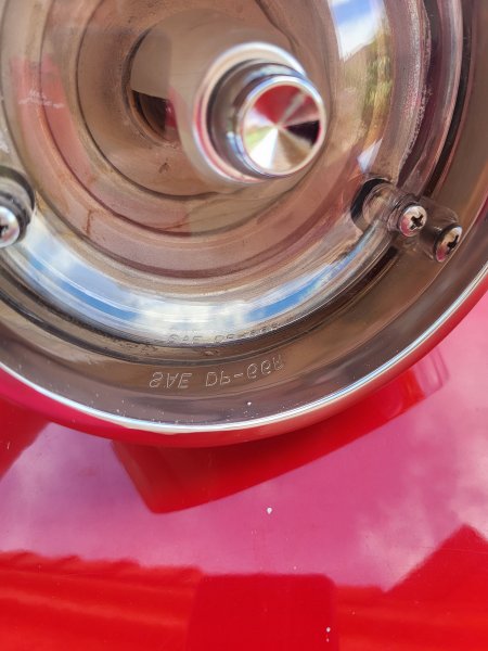

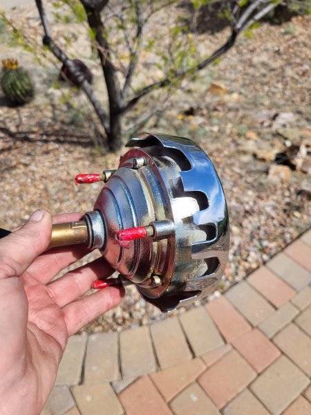

Picked up the pieces I had rechromed. Dropped them off last Novemeber
Wasnt happy with the other park lamp assy. But this one turned out nice

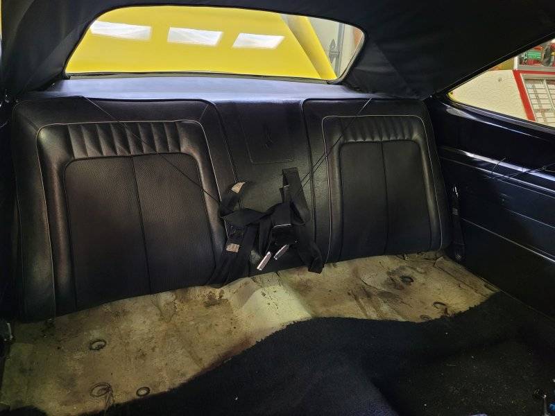

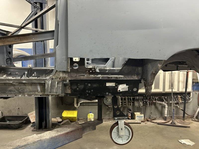

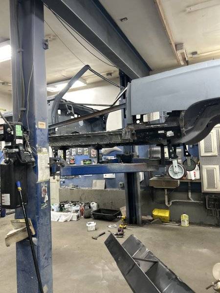

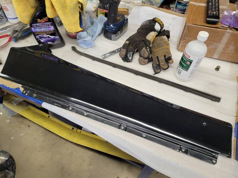

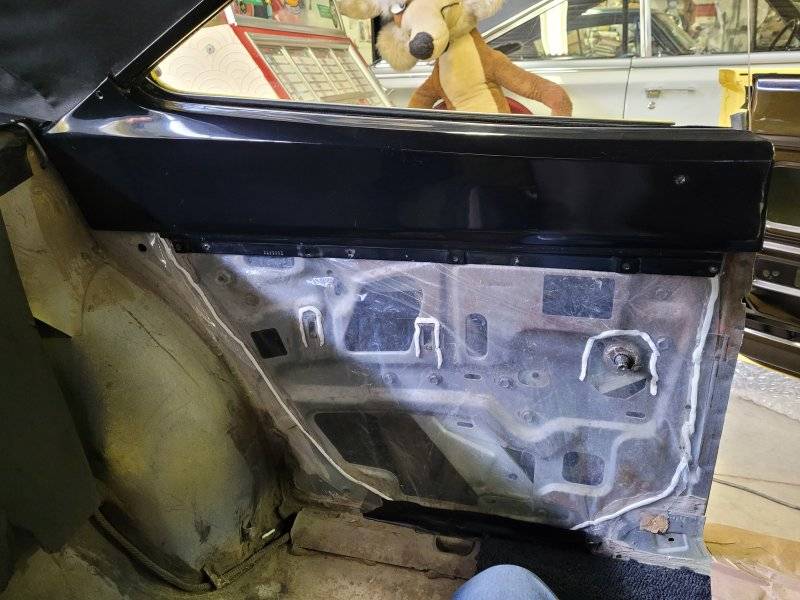

Finally putting this Jenga puzzle back together. My first time going into this much depth. Rocker panels on a convert are a good time
wow... that's gonna be awesome when done... i only had to repair rust and patches but it felt soo good to be adding metal back instead of cutting... i'm sure yours is 100x better:)

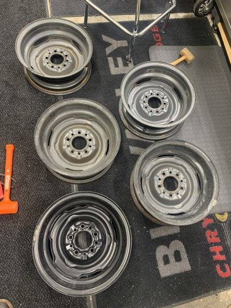

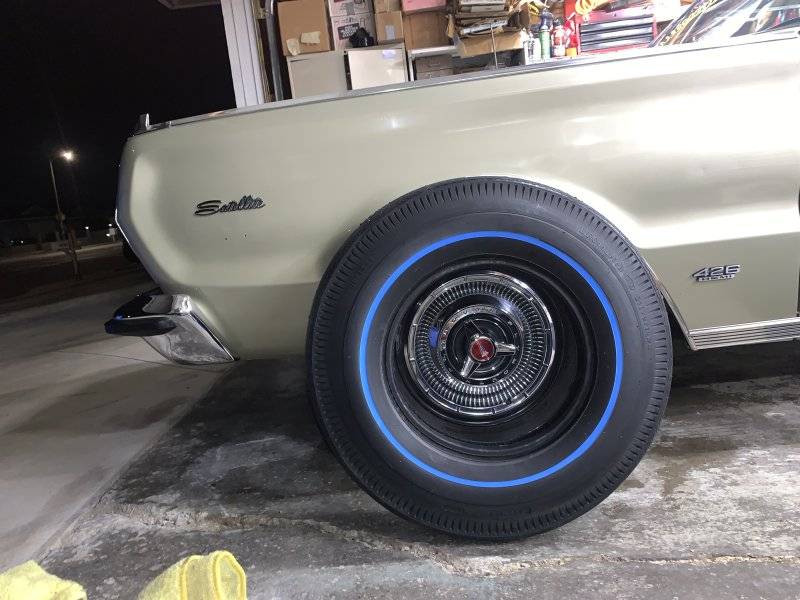

I got my tires, now to paint the original rims.

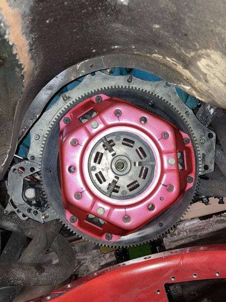

Installed the rebuilt clutch and pressure plate.
Ram will rebuild their stuff, which saves a few bucks.
I got the bellhousing on too, hopefully the trans tomorrow.
Then I’ll work on the clutch linkage, I’m going to make a new bellcrank.
