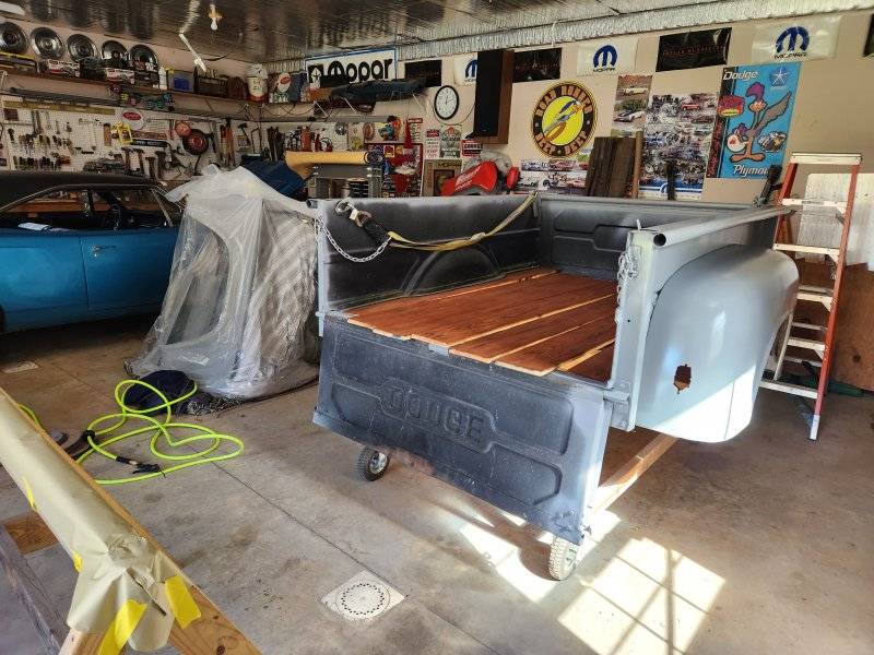

Working on the bed on the 64 D100
For those who have replaced wooden beds this bit of information may be old news.
The wood is actually a structural part of the bed. In other words, don't remove ALL the boards at the same time. The 2 outer ones by the wheelwells are basically most of what holds the sides on (ask me how I found this out). Live and learn.

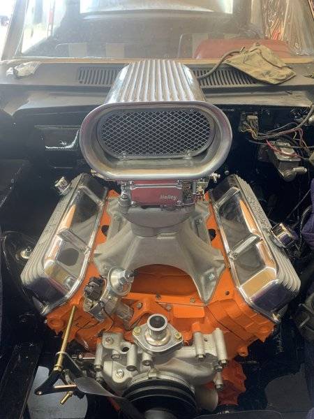

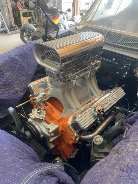

Hmmm, black inner fenders.
How is multi color candy and gold leaf going to go with that?
Can't wait to see.
Oh, and I guess the grandpa sleeper look is not an option with a tunnel ram.
Haha…going a different route with this one! Be tough to close the hood, so sleeper is out the door, lol!

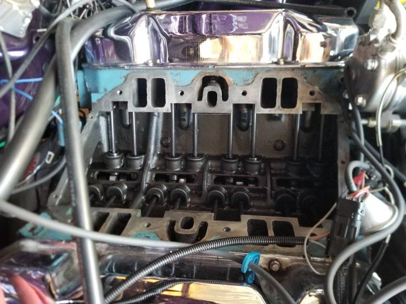

I swapped my Performer RPM and Edelbrock carb for my old Performer 383 and restored Thermoquad. Now, to try and remember how the stock kick down, throttle cable, and vacuum lines attach.
