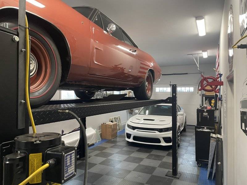

I looked at her, up on the lift, she's sad, with 8 vintage motorcycles waiting for service sitting beneath.

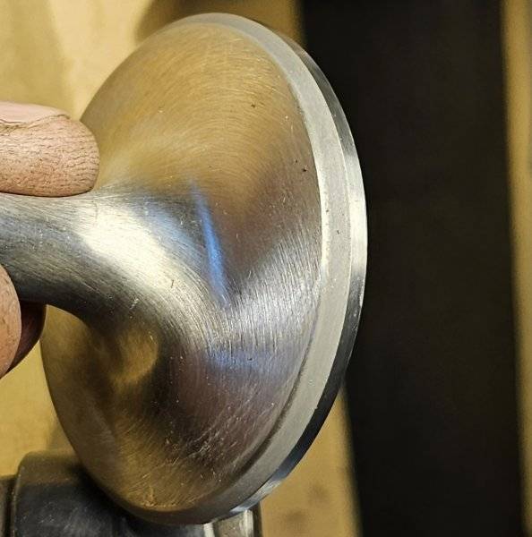

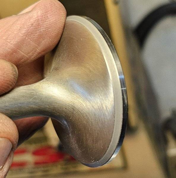

The below pictures may be hard to see. But to verify that the valve sits exactly where it should be, it is lapped into the seat to see where it is contacting the new seat. To start, I always start slightly small so more can easily be cut out without sinking the valve seat. The more shiny ring (may be hard to see) at the end of the valve should be no more than .005".
For my second cut, I nailed it. Again, the pictures may make this hard to see, but there is a tiny little shiny ring at the edge where the seat did not contact, and it is less than .005". Now the cutter is set and the rest of the seats can be cut.

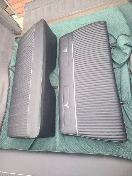

Picked up my 64 Polara seats from the upholsterer with brand new Legendary covers. I'm real happy with the results. Ordered last January, received in October, installed in December. Less than a year.

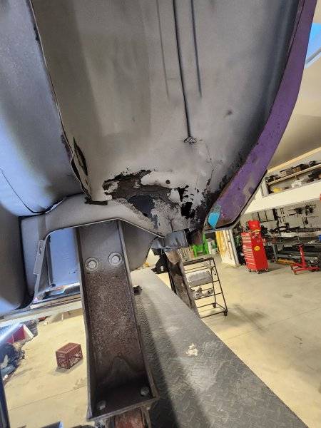

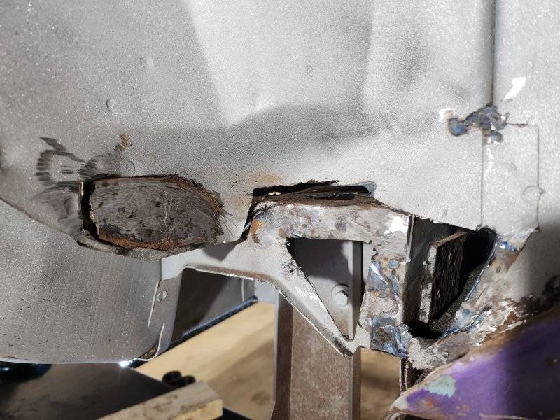

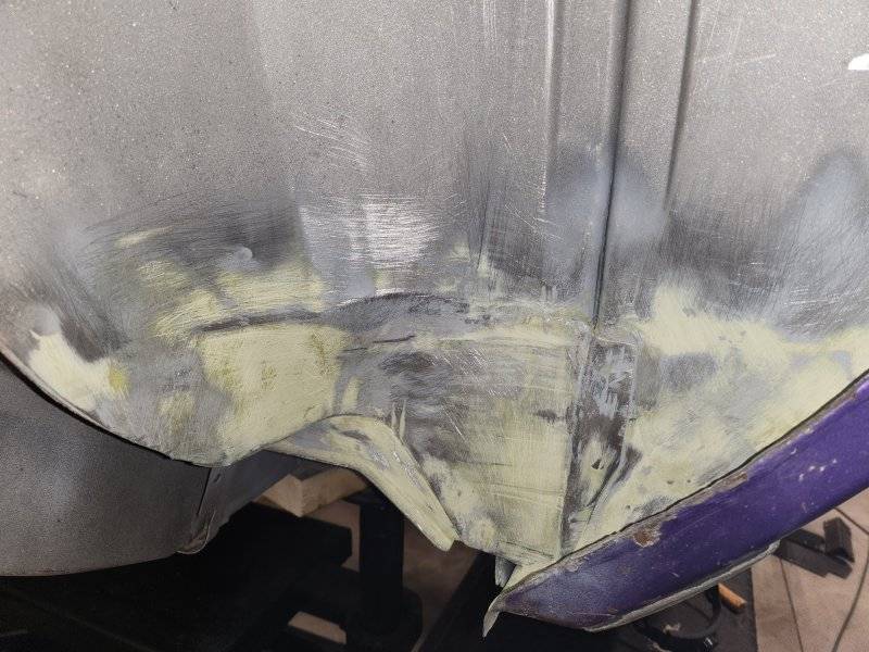

The rear frame had issues:
They welded in some new metal, a little paint and voila!
$750 all in. New burlap, foam and backing board. I have more work coming his way.

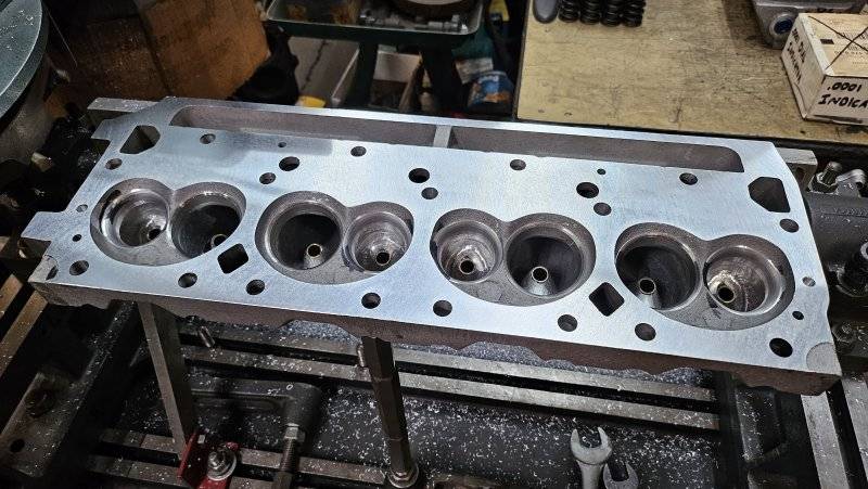

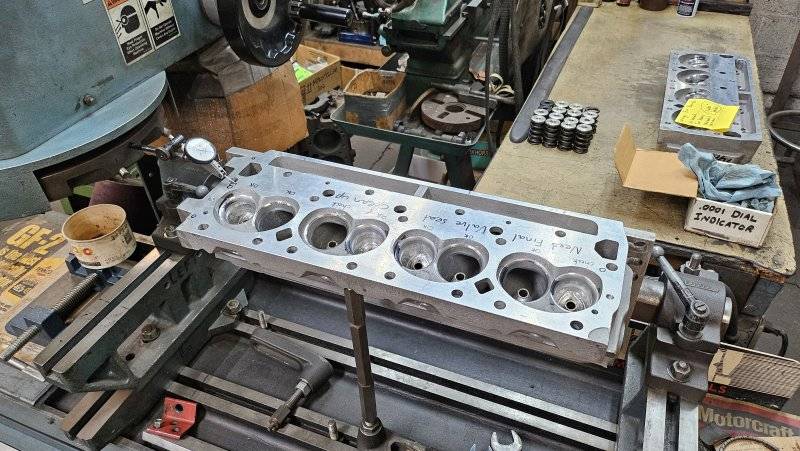

As I said, these heads had some shelf wear from sitting since new. NOS does not mean new condition! So I set these heads up to cut .005" off the surface and clean up the scratches.
Here is where I am getting them set "flat" (or parallel to the cutting head) in the machine. The dial indicator is mounted to the cutting head since that is what counts when you cut. It measures to .0005", and I got these heads to within about .0002" side to side and front to back. This is what takes time - the cutting is fast!
By the way, these heads were about .003" thicker in the center, so it was good they got a nice clean, straight cut.
Here is a picture as I am starting the cut. I color the head in with black magic marker on the beginning of the head. The cutting head is then lowered down until it turns the black magic maker gray. When it does that, you know you are at your "zero". From there, I backed off the head, added .005" to the cut and then let 'er rip. The picture below is as it the machine is starting the cut all the way across the head. This is automated so all the hard work is done at this point!
Here is the head after it was cut. All the scratches were cleaned (cut) off and the surface is now super smooth and ready to mount on the short block.
