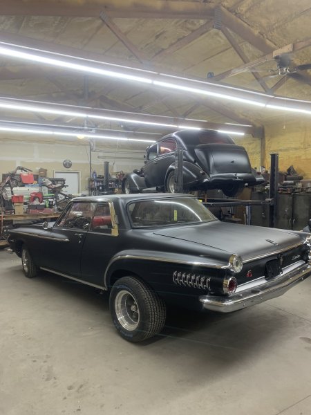

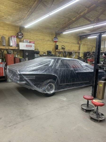

3 full days of installing trim on the 62”, with the help of some good friends accomplished it without scratching anything, still need to install the trim around the rear window.

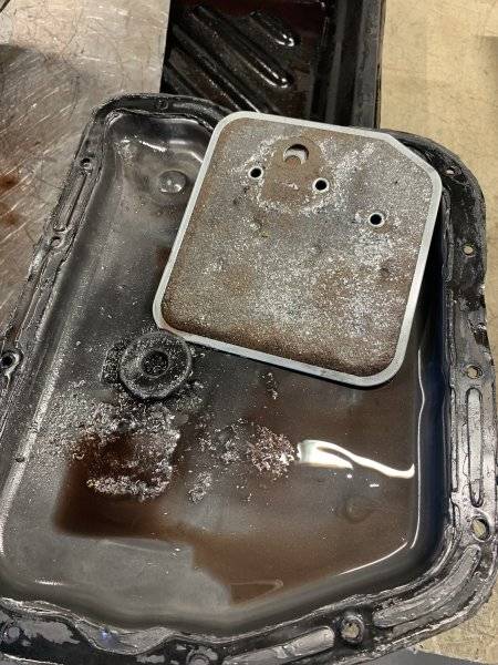

Finishing up a 1964 Torqueflite rebuild for a friend. He dropped off a deep pan setup he bought from Mancini's. On the Plus side, it came with the late model o-ringed pan gasket, and longer pan bolts. On the Minus side, it came with normal 1 hole filter, and filter extension. I had to drill a 1/2" hole through the extention to feed the rear pump. I had already ordered a 2 hole filter, along with the rebuild kit. Then, I discovered the supplied screws to bolt the filter and extention to the valve body were too short. I rooted around through my extra spares and found a set of longer screws, so I was O.K. The transmission had a broken Belleville spring and rear band anchor.

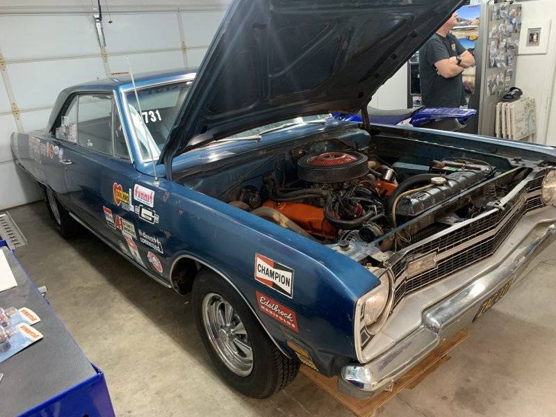

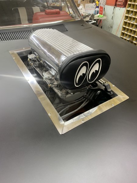

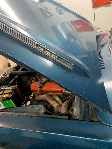

I was driving the Hemi Satellite to Hobby Lobby to get some Spring Fling show supplies...
But I slow cruised by a house and ran into the owner of this car:
Note: I did not make it to Hobby Lobby

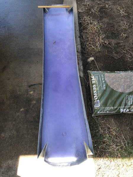

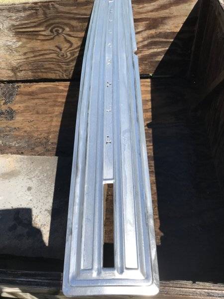

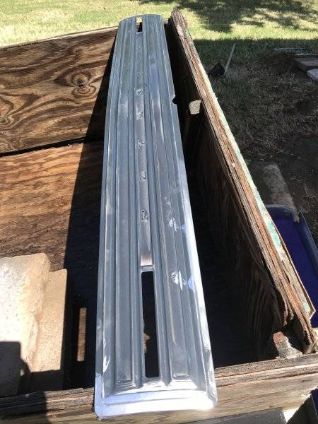

Stripped anodizing off a spare 66 tail pane that I’m going to finish out for my Satellite. Used lye pellets which is the best approach I’ve found.
It’s in there somewhere.
Forgot to strip some paint remnants out of the letters first. Lye won’t eat off paint. Now on to polishing.
