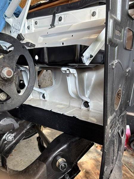

Picked up a new Battery Tray for the Charger!
It didn't have one in the past, just some old jury rigged piece of rusty sheet metal that was sorta welded on there.

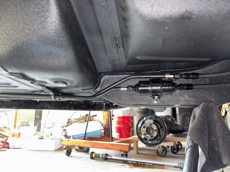

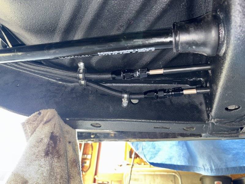

Strapped up all the fuel lines today after lunch. Fuel system is complete now, ready for test and leak checks.

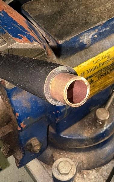

I also put my gravel guard on the 3/8 CUNI hard lines running under the chassis. Like I told the fellas on the 1st Gen site, I used a 1" Electrical Shrink Tubing for that... the Heavy Duty stuff with the adhesive liner inside for industrial/Outdoor buried connections, etc...

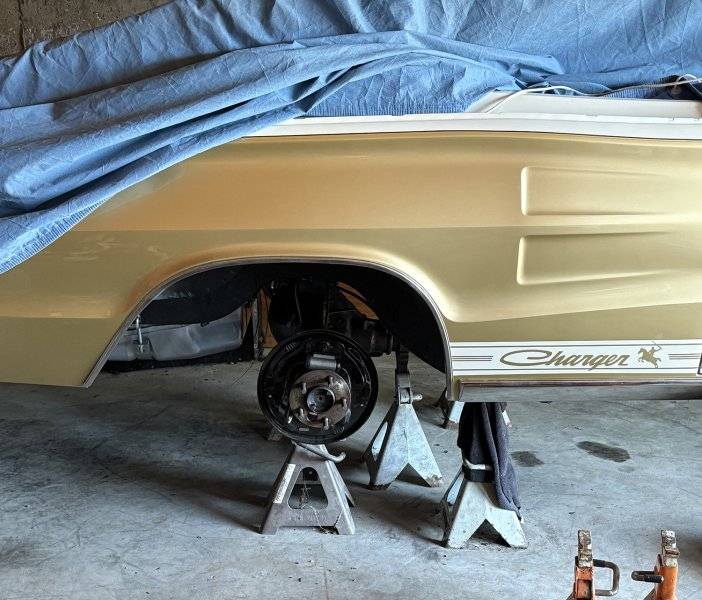

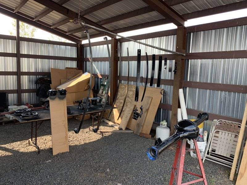

Set the rear end under the chassis on jack stands for now. I'll get the leaf springs installed tomorrow if I get the chance.

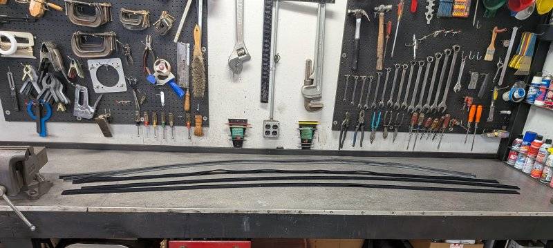

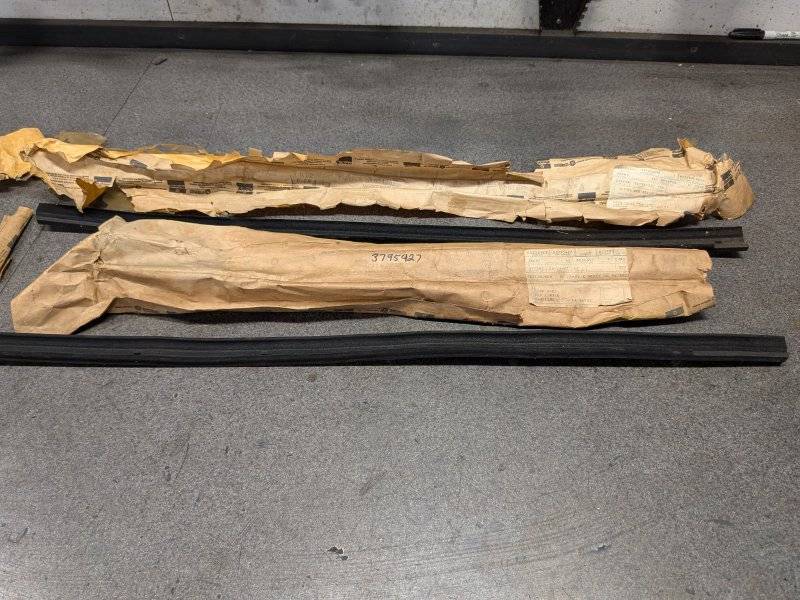

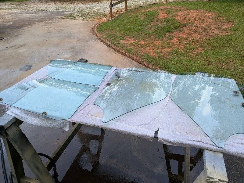

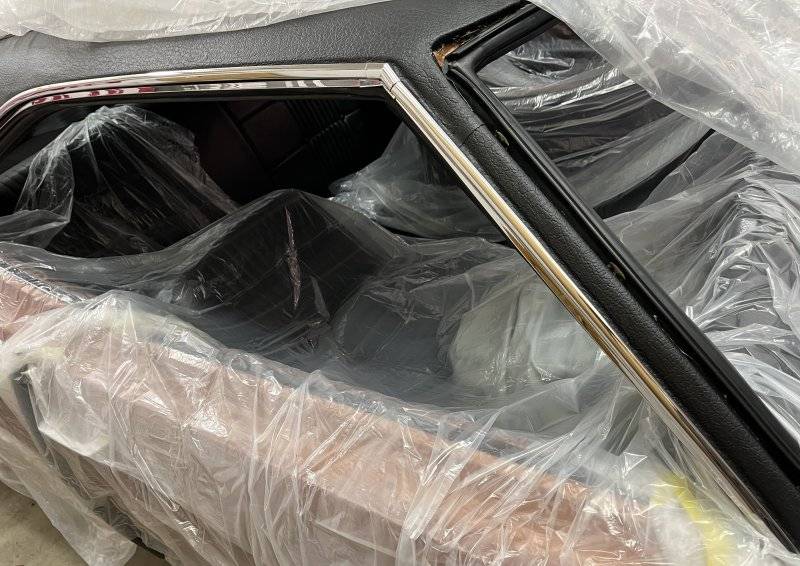

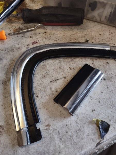

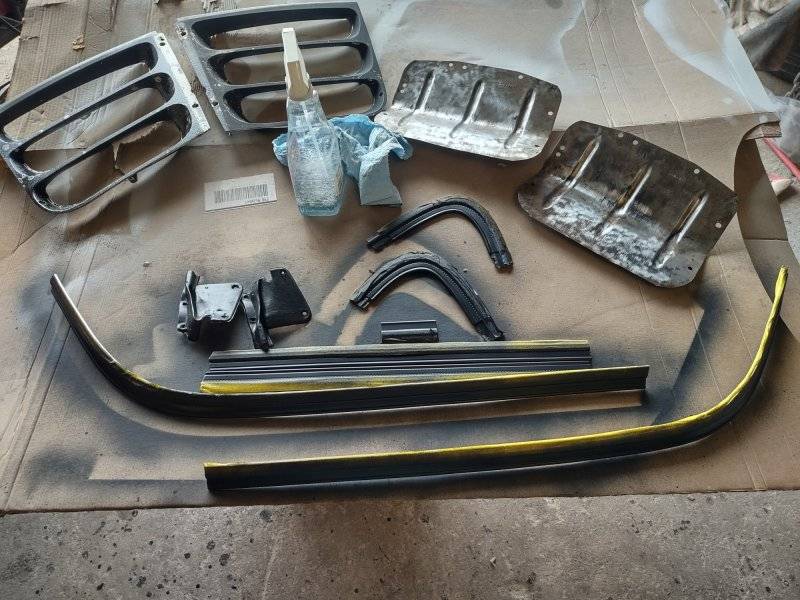

Installing new belt weatherstrips and door channel, cleaning and lubricating latches, lubricating the window regulators, tracks, etc. and reinstalling glass.

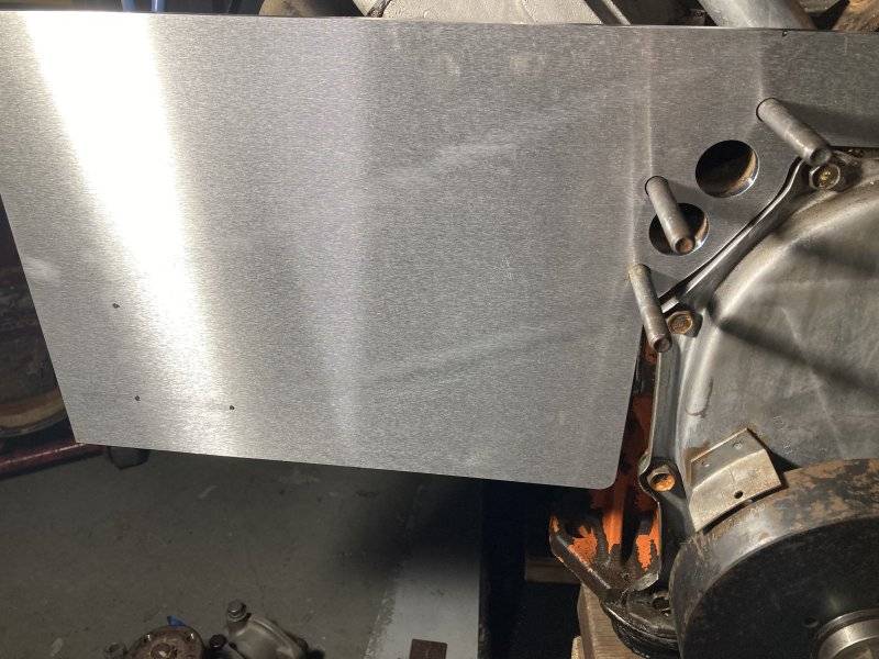

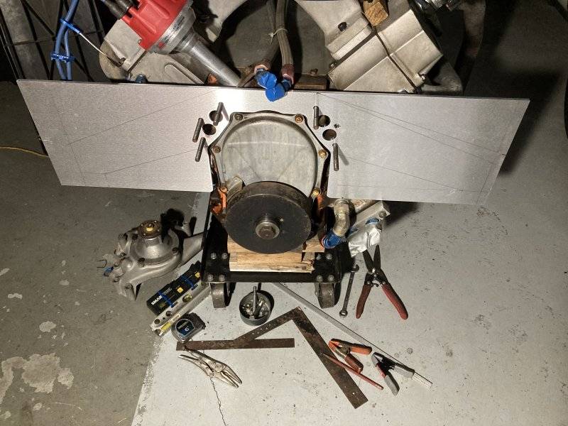

Dropped off a BB motor plate at a local water jet for them to connect my center punch marks. This plate is for my Dirty B1

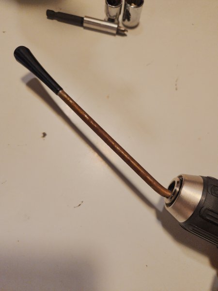

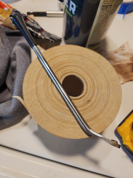

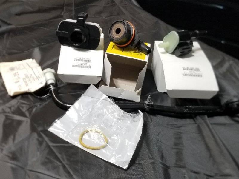

I fired the parts cannon at the Grand Cherokee hoping to resolve the annoying evap system small leak code. I put in a new PCV while I was at it since it's at 76k miles. What a PITA on a 3.6. I stuck a 3/8 bolt in the end of the new PCV to get enough leverage to twist it in.

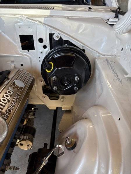

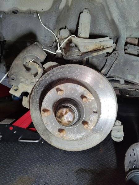

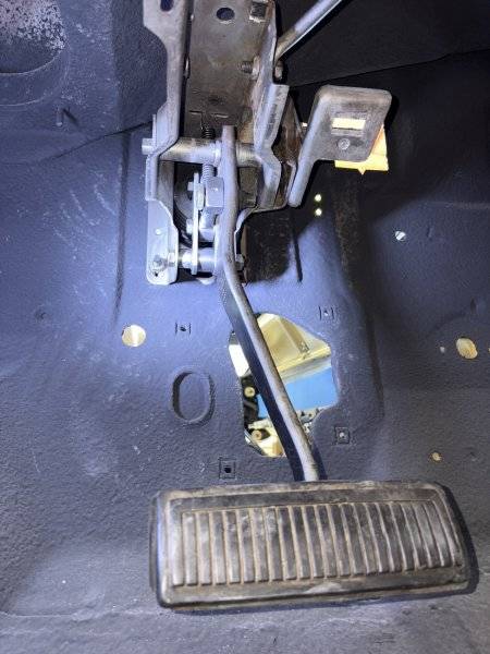

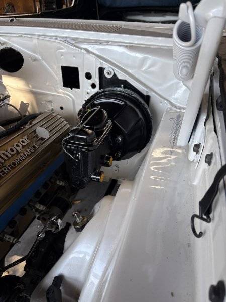

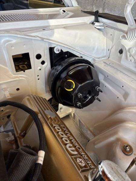

That's funny. I am currently taking my power booster, pedal rod, master cylinder out. Switching over to manual front disc and rear drums. Also removing the power steering for manual. :D

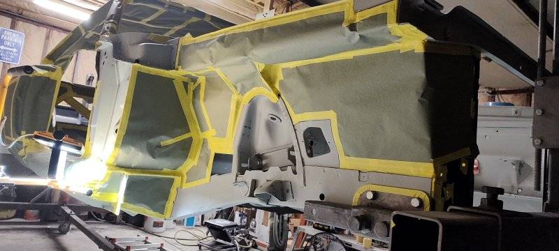

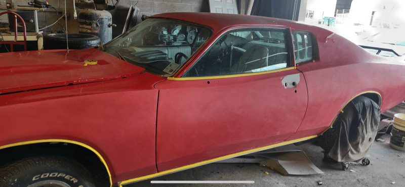

Waiting in Vinyl top. Hopefully have her back this weekend to get the motor and transmission back in, then wiring the engine bay and tuning.
