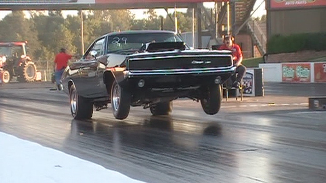

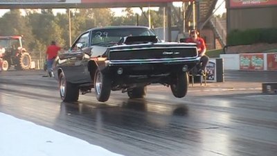

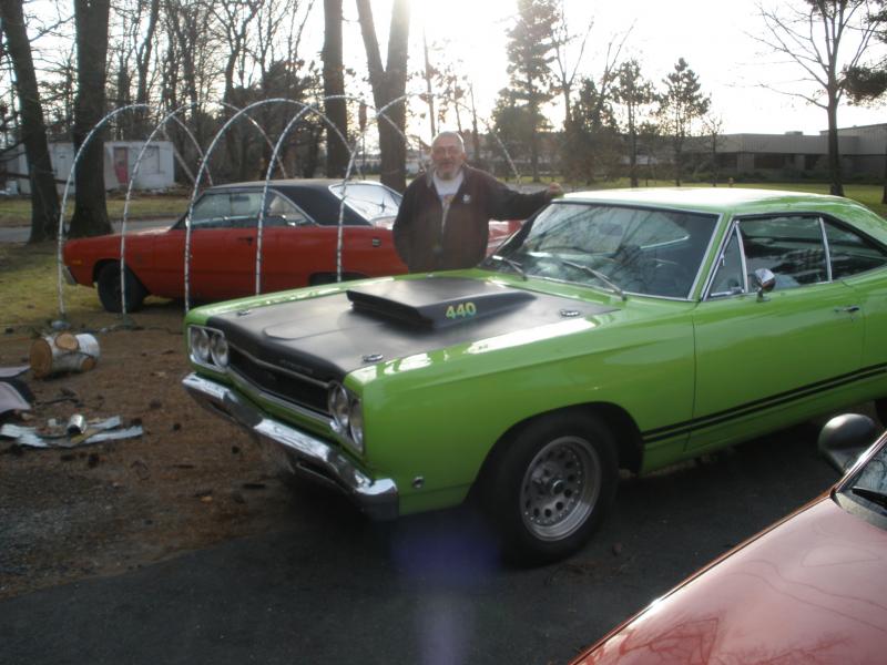

My car weighs 3,900 lbs and it's hard to hook up. I have used slicks and they work pretty good but the ride of a radial feels alot better going down the track in my heavy car. My best times are also with a Hossier 275/60 with a 1.38 60 ft and went 9.84 @136 all motor. I am installing the 1/2" front longer segment also so I can fit 315s Mt drag radials. They look good under the car but not enough room without moving the rear end back a 1/2".
What kind of tire are you using and what are your shocks at ?
Would love to see this car.. My Dart went 5:70's in the 1/8 with 1:24 60' on a 10.5 tire... Caltracs and split mono with 9 way shocks.. Never an issue with traction at any track it was at..
And I abused it with a little go juice off the line...
Car weighs 3,900 lbs and have a ahrd time hooking with drag radials. Car went 9.84 @ 136 on just the motorwith a 1.380 60Ft. I also found that my driveshaft loop was touching the driveshaft when the rear end had about only 2" of seperation. That was not helping my problem any but maybe with the new front segments and some 315s M/T radials it will hook consistantly now.

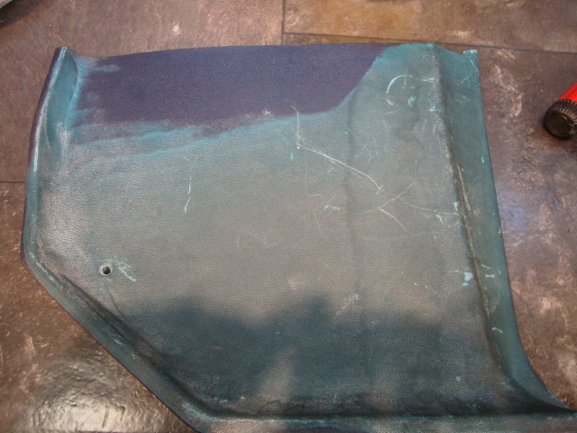

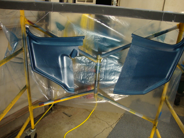

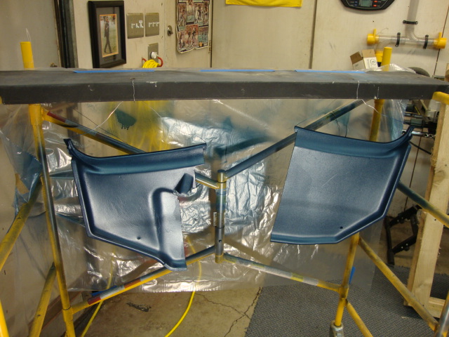

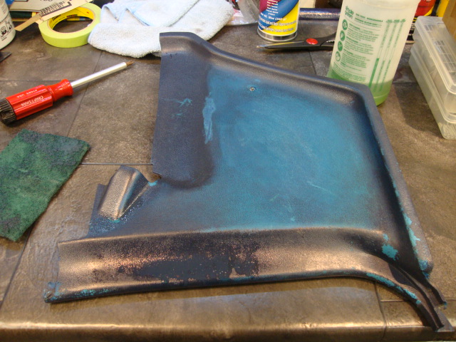

stripped down my kick panels and gave em a nice coat of interior paint
View attachment 94155View attachment 94156View attachment 94157View attachment 94158
they'll do till i can get new ones...
My car is supposed to have all blue plastic but they put black in when they restored it, I can't find black repop panels and the last original blue set just sold for $210 on eBay! That's freakin nuts! What kind of interior paint did you use?
Tony
Tony
Holy Mackerel!!! $210?? i bought my paint from Mr Moparts... http://www.mrmoparts.net/interior-paint-dye-12oz-spray-can/ . the paint itself sprayed real nice (make sure you shake the hell out of it before and during use) and matched very well. but....it took him like 3 weeks to ship it out. otherwise, i would buy from him again. IIRC Herb's parts sells interior paint that is supposed to be good as well.

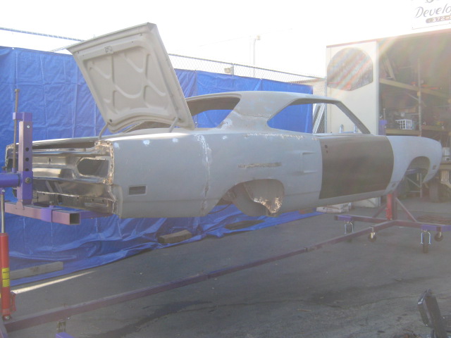

Took the GTX "out back" and sand blasted all the welds made during the rebuild/replace/fabrication process. Now it is on to final body work and paint!
