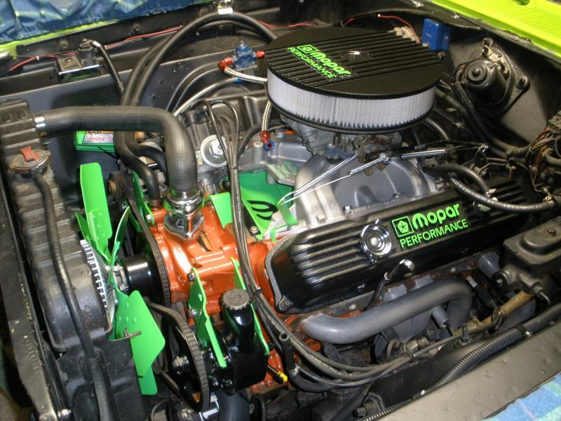

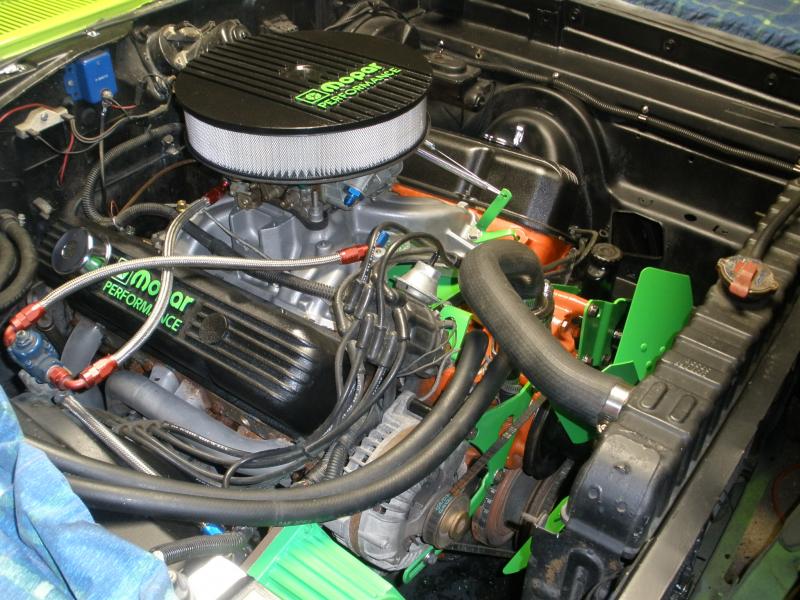

I will give a progress report on Cr8crshr's Satellite. We bypassed the Heater core as it seems to be full of Nevada clay dust. Seems like everytime we flush the radaiator it looks like rust, besides I think it sprung a leak as we had H2O on the paas side carpet. We also backed the lash/preload 3/4 of a turn and boy did that really changed things for the better. Much better throttle response, idle quality, knocking we couldn't figure out where from. The only knock we have now is in the tranny which we can clearly ponit our finger at it and agree. It slips real bad in D with no real bump of engagement, but R is fine, speedo's dead also. So he's looking at trannys now. We are going to do final tune/dail in on Sun. If it weren't for the tranny now, the car WANTS to go for a drive, it's going to be fun!:blob1::upside down:
