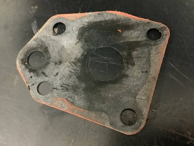

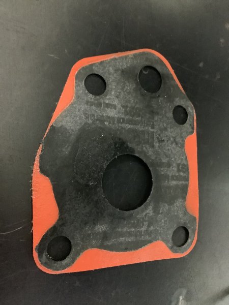

did u pack the pump with petroleum jelly/Vaseline before u installed it?Yes I could feel the hex drop into the pump.
Here is the culprit, the gasket was indeed missing the critical hole for the oil pickup port. What a **** show…
View attachment 1469530View attachment 1469531
