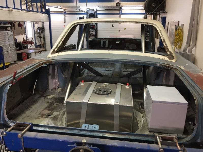

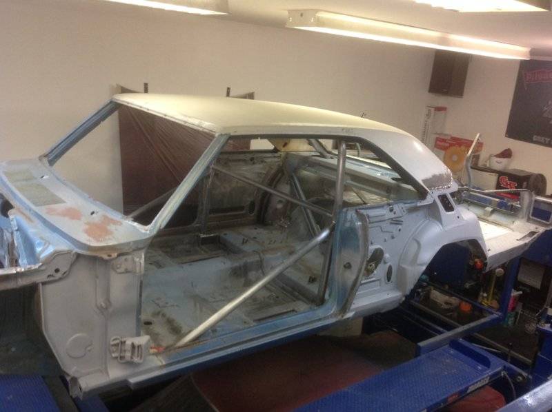

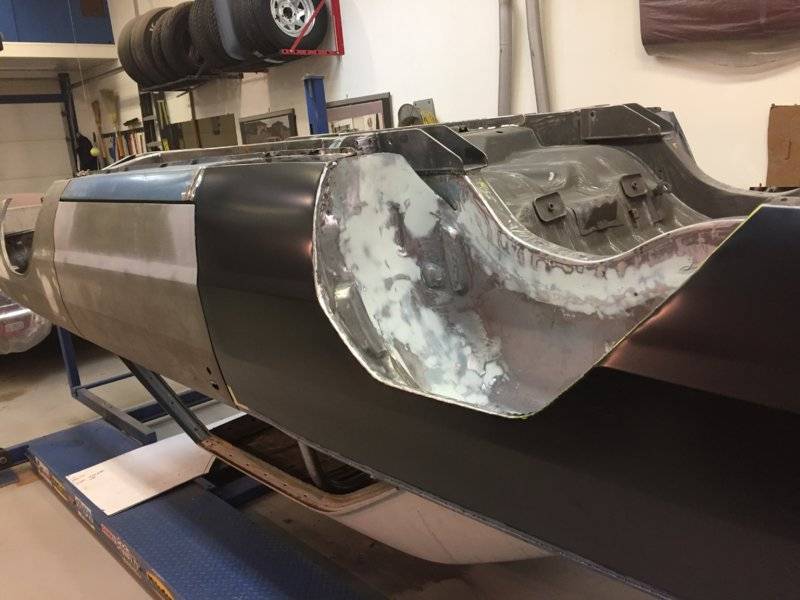

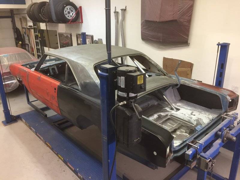

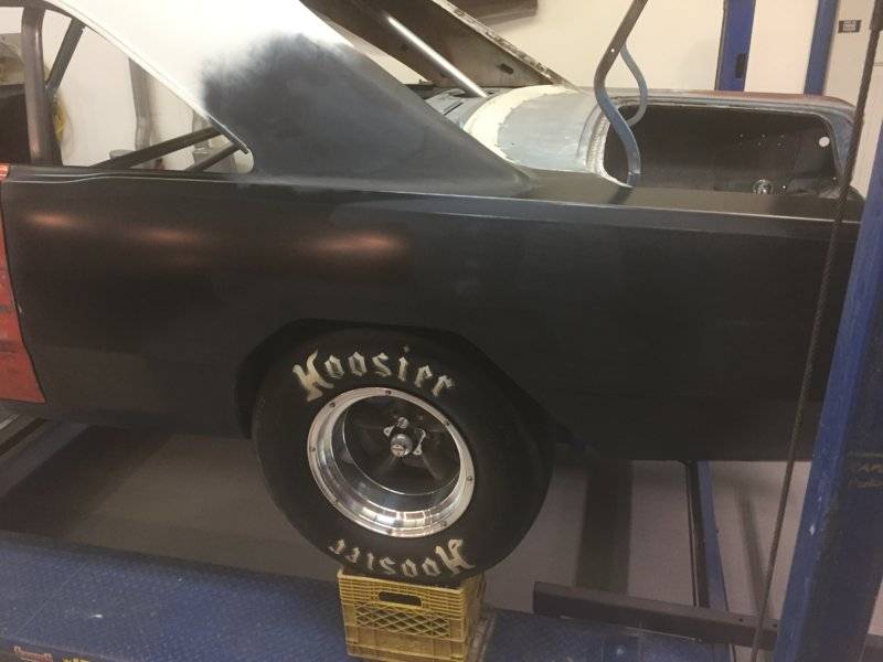

For me, I got this old Dart to keep me busy till the track opens in a few more months. Yeah I know it's an A body but I do bleed B-body..

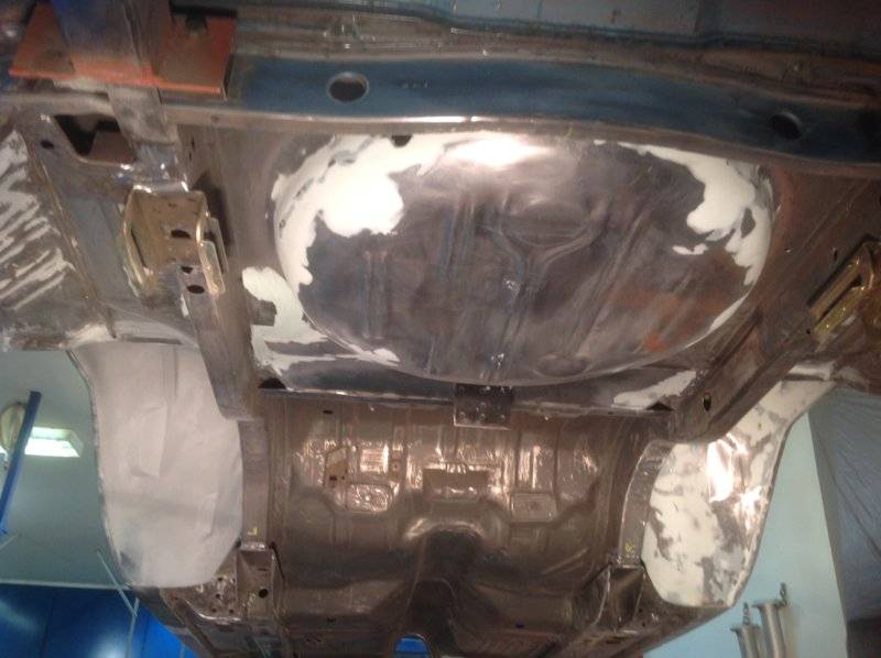

Got the bottom ready to epoxy prime. Mini Tubs, Springs relocated, frame connectors, front floor boards, rear spare tire tub, etc. Raised the tub 3" too so it doesnt hang down like a donut.
Fuel cell and battery located.
Roll bar installed and left quarter removed.
The Superstock look.

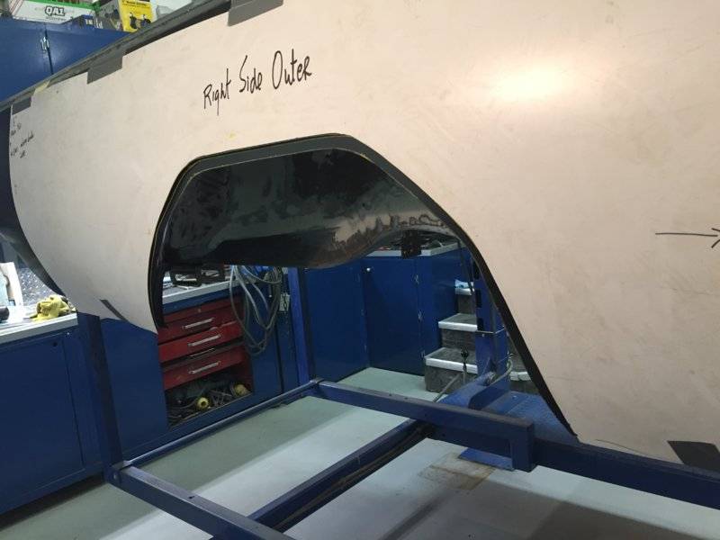

Tub to wheel opening work happening.
Tire mock up. Heater delete, radio delete, fuel filler delete.
Stripping remaining old paint off. All metal work done. Next up, finish body work.
That's what's going on over at my place this winter. Work by day, ache at night.

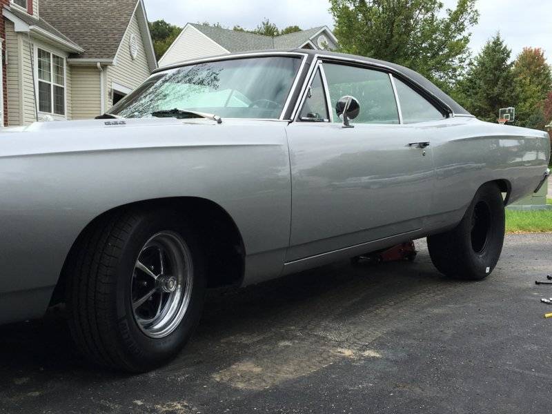

Might do a little more tuning on the Plymouth. .maybe put a manual valve body in it for better tire chirping

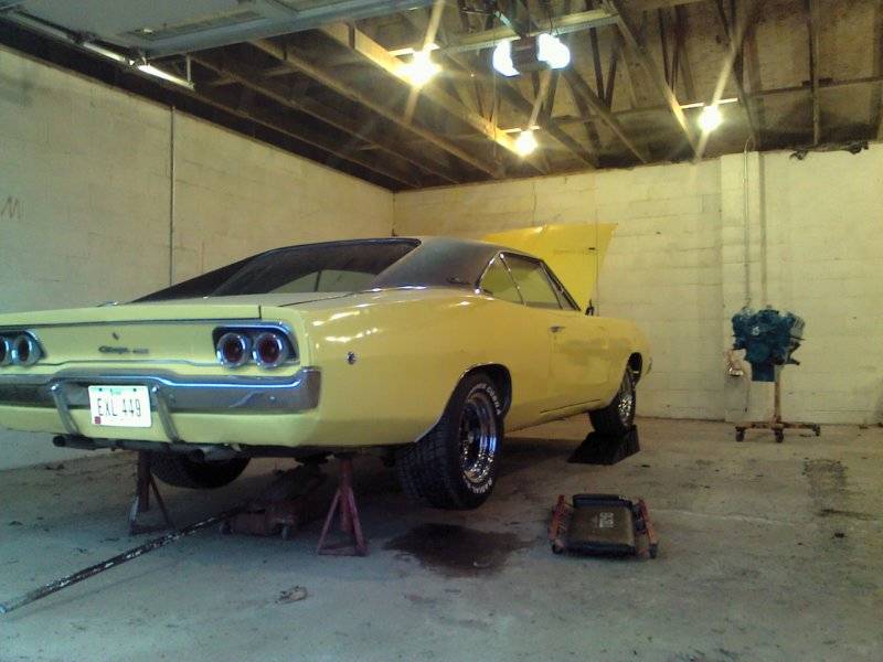

Got to take the motor out of the 66 due to bad rear main oil leak
Can't roll in a new one? Pan should come down easy the the drag link out of the way? I've had success with the rear seal when clocking them. By doing so it helps guilde the retainer into the right position.

Well the guy that built that motor in the 66 is goin to warranty the leak. .its a 4 speed car.

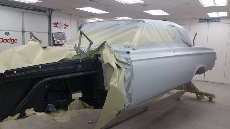

Malex, your work ethic, speed, and quality amaze me. My trans is freshened up. The new spool and gear are done. I'm going to paint the wheel spokes a different color. The real work is another N/SS car. My friend is building one similar to mine, 64Polara 500. Cage, mounts, and brackets are done. Body is in 2nd prime coat. Same guy painting as mine. Black with a red gut. Motor is done. KB 540" by Best Machine. Made a touch over 960hp. I'm doing the Dana and trans now. When it comes out of paint I'll wire it up.

That 64 Polara 500 is going to be a beautiful car! Fast too.. The picture shows the quality already, Can't wait to see the progress on it.

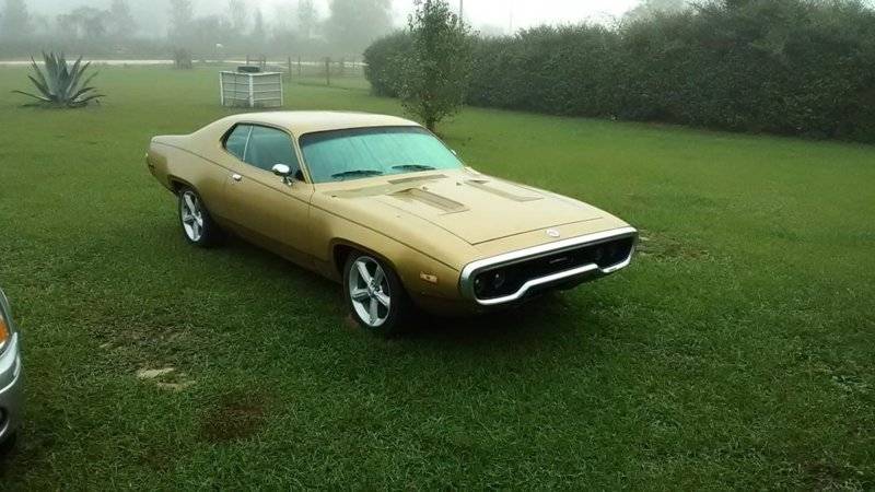

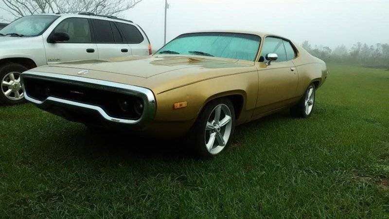

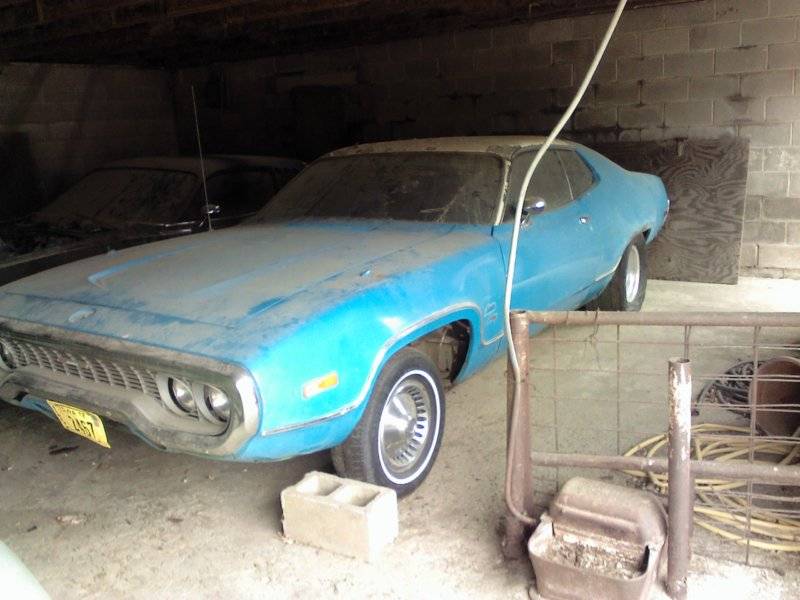

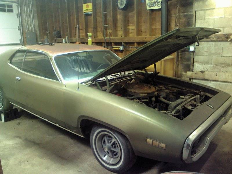

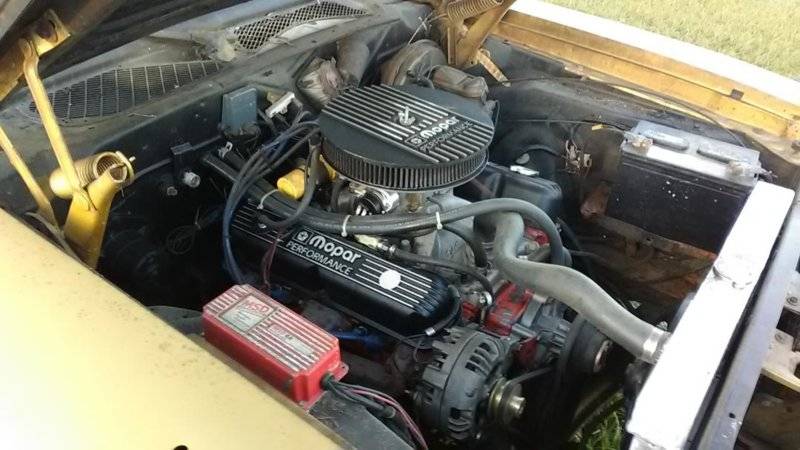

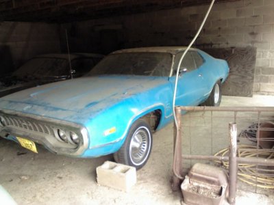

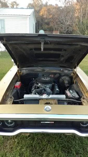

I'm parts gathering for a 72 Satellite I just bought. The interior was taken apart and needs a new roof panel installed or a patch.
