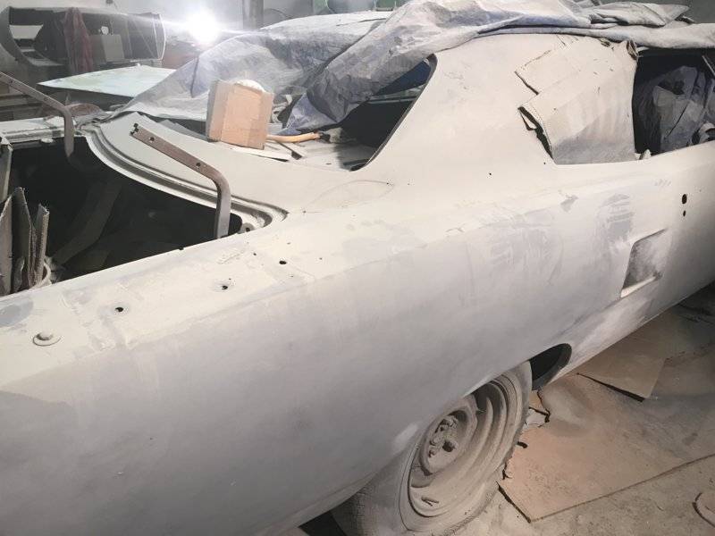

The reason l have lite race cars and milder motors is because of this thing I’ve been working on for three winters.i ll spend my money on restorations instead 70 superbird

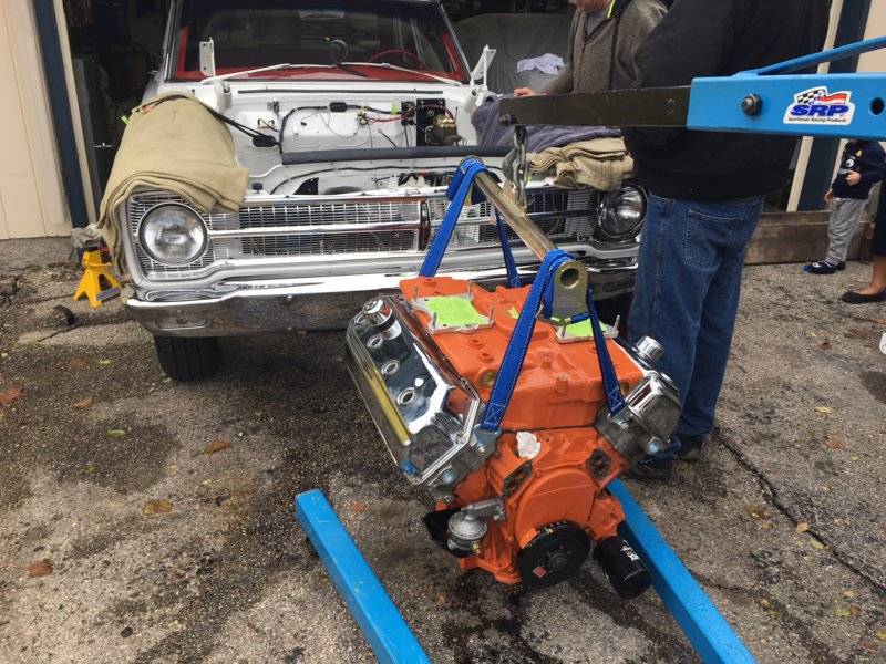

Took the motor out of the 65 to fix some small issues that have been bugging me.
No major issues discovered. Need to renew the crosshatch. Throw in new rings, rod bearings, cam bearings, rear main seal while apart.
Ordered roller cam, solid rollers, springs, button, bronze gear drive from FHO.
Machine work is done and parts are here so start assembly this weekend.
Pulled the trans too. Filled it with A&A parts and a brake for giggles.

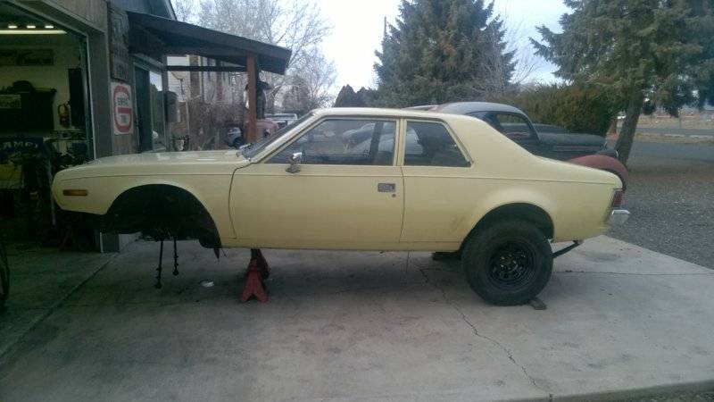

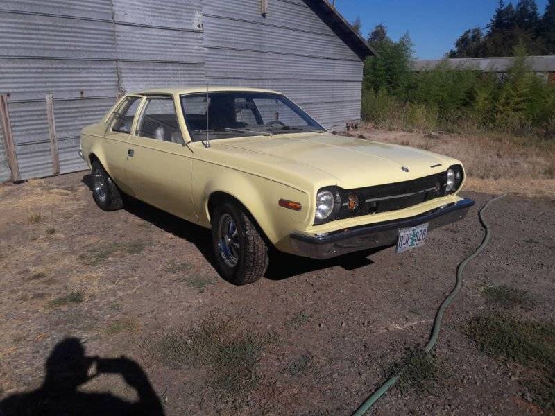

Deviating a little to Mopar's redheaded step brother this winter. I picked this little V8 Hornet up really cheap because the engine was seized. Turning it into a vintage style desert racer for the street. And I thought Mopar parts were getting hard to find! I feel sorry for our AMC brothers.

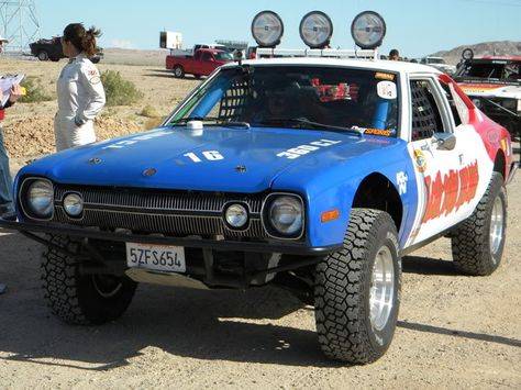

This is the inspiration:
