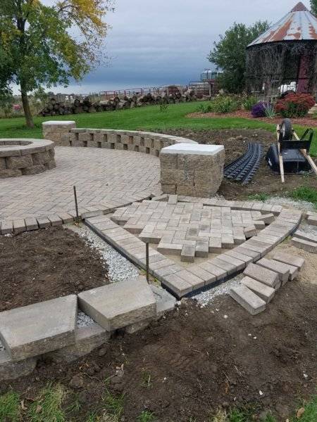

Been working on a patio/firepit in my free time. Gonna be real busy with harvest soon so hopefully can get this nearly done before then.

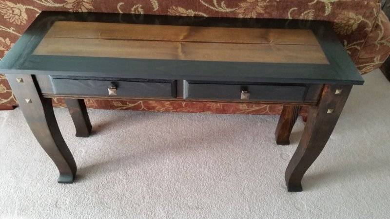

Another project I recently did was this sofa table. Neighbor down the street had it out front with a free sign on it. It was painted tan, and drawers were spray painted black. I took it apart, stripped the paint off, and I made a new top, the original top was particle board with crappy pine veneer on it, and I found this interesting center piece of common board at home depot, and thought I would make an interesting accent surrounded by pine stained black, the drawer fronts also stained black. I also covered up the fake wood pins that were on the legs, used specialty craft nails that were the same size as the square cut outs, and covered them, and just so happen to find matching knobs for the drawers. Now its a one of a kind table!

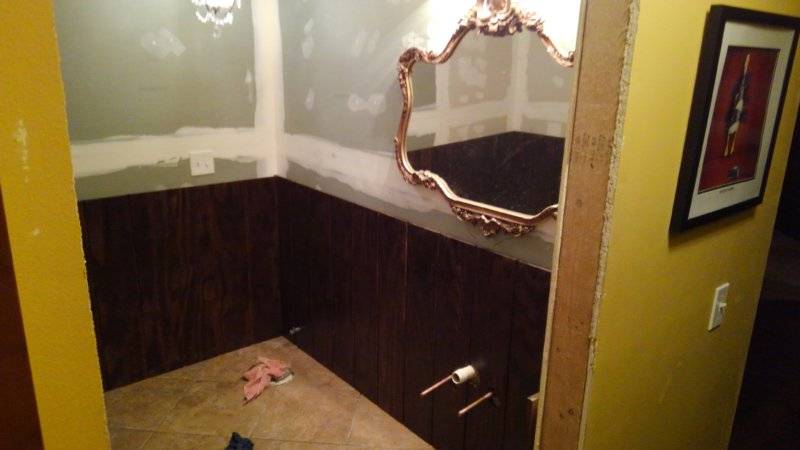

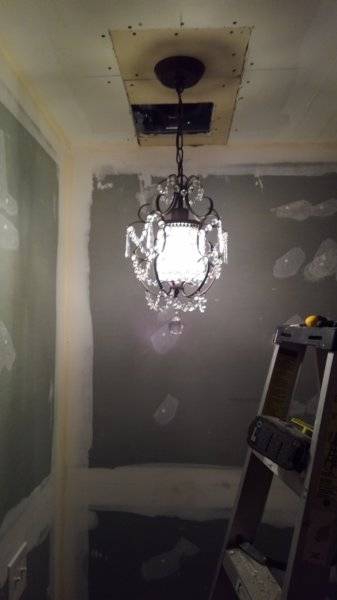

Getting the bathroom finally put back together!!
Next step smooth the walls and hang the wall paper ! Then get the boarder trim stained and installed !

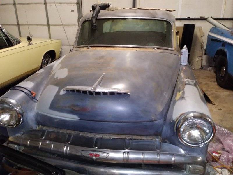

Well, I sold the Shasta trailer a few weeks ago, long story, but it's with an appreciative new owner. I've now redirected my attention toward my '54 Hudson Super Jet, (pictured) which has sat for a year now in the shop. I'm trying my hand at creating new inner door panels from scratch. Bought the plastic backing board and the upholstery material, and now, I'm reconfiguring my workspace to accommodate the work. I've also picked up a few other bits for the car. The goal is to have the car drivable and mostly complete by Spring.
Just found out about a freshly-wrecked Jet in California with a bunch of parts I need, so I'm checking into that for more stuff.

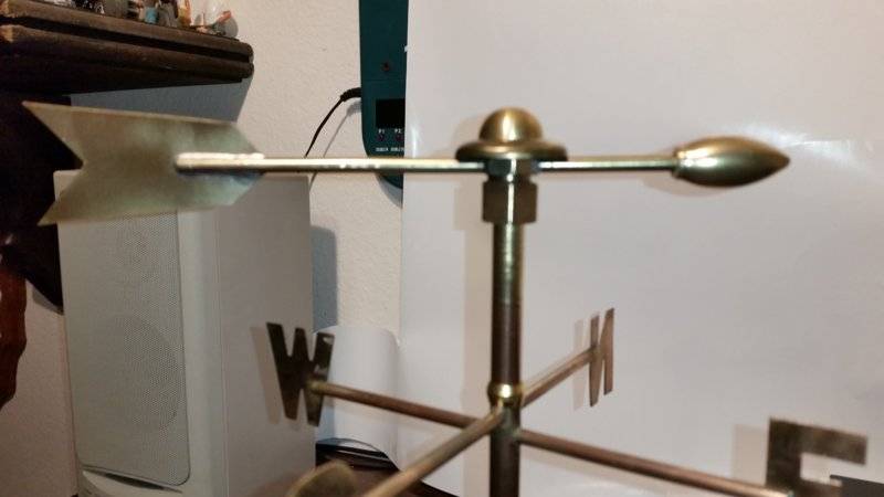

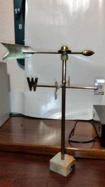

I thought I would get back in the loop with some non car projects. I found this weather vane, well, it was just the directional and it was painted yellow when I got it. It did not have the arrow, so after stripping the paint off of it, I found it was made of solid copper and brass. So, I decided to make a new arrow for it out of solid brass. Here is what it looks like, and I think the arrow looks like it belongs to the weather vane. Now its just art work that sits on a shelf in my office.
Closer view of the arrow.

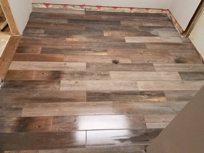

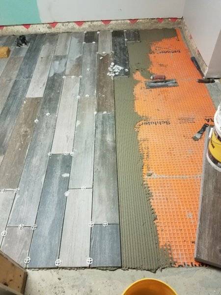

Finishing the basement:(. I don't know if the wife just hates me or if she's just bad with timing because as soon as I started the addition on the garage it's been one thing after the other:screwy:?
This has been a real mess, I poured the floor myself with help of coarse back when I had more energy than brains on one of the hottest days of the year so needless to say although it looked smooth and flat it was anything but FLAT OR LEVEL!! Lots of cutting, chiseling and many buckets of leveling compound fixed it up then the Ditra membrane at bobtile's recommendation.. thanks Bob for your input:thumbsup:.

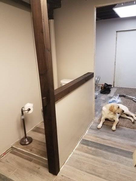

Of coarse since my daughter has a room in the basement now she wants a bathroom where I had never anticipated having a fully finished bath so more obstacles:BangHead:. Needed to raise the floor 3" for a toilet flange which lead to figuring out how to hide the elevation change so a partition was built. Had to hide all of the drainage pipes and plumbing so I'll be building a huge cabinet to make use of the space while hiding the piping:BangHead::BangHead::BangHead::BangHead:.
This is a poured basement using a foam form if anybody questions the exposed 4" of red ties and foam. The best way I could figure for installing baseboards was to glue and screw 1/2" plywood along the bottom, it worked out nice seeing how the plastic ties are thick and take screws very well:thumbsup:.

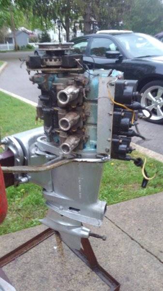

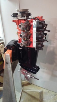

My none car projects mostly consist of antique/racing outboard restorations. Below is one of my more recent projects. This a Swedish racing outboard known as a Crescent 500cs. These were imported in the USA in the late 60's to run in the super C class. There where roughly 50-60 of these imported.
