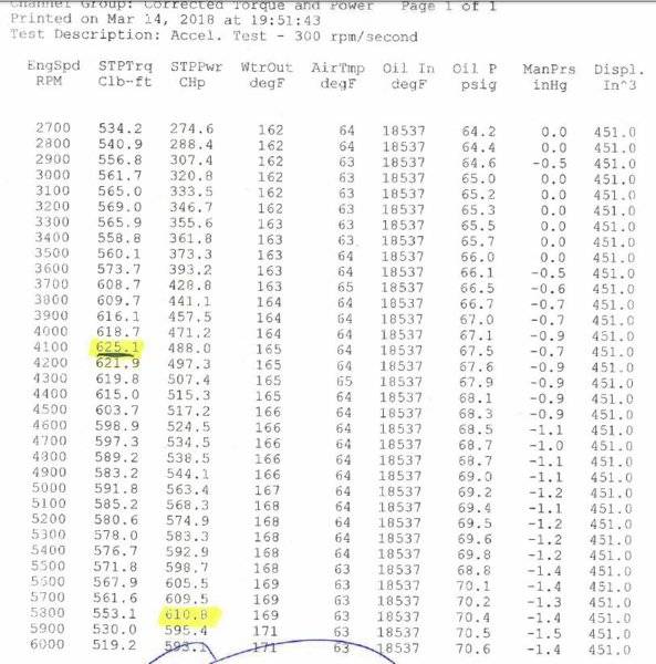

Another stock stroke 440...bottom end is stock stroke 440 with Icon forged pistons and a Lunati hydraulic roller cam.
And I was "sure" I was going to build a stroker motor...
I'm going to have to reach out to my friend @IQ52 before I put my money down for a build so I can be confident in my decision.
I still have to have the money for a build. LOL.
Mentor70-Why 270s vs 240s??
The 240s are a better match for my dual plane Edelbrock/Chrysler 6bbl intake, but it seems like you have a medium build? Hydraulic cam is why I'm assuming that.

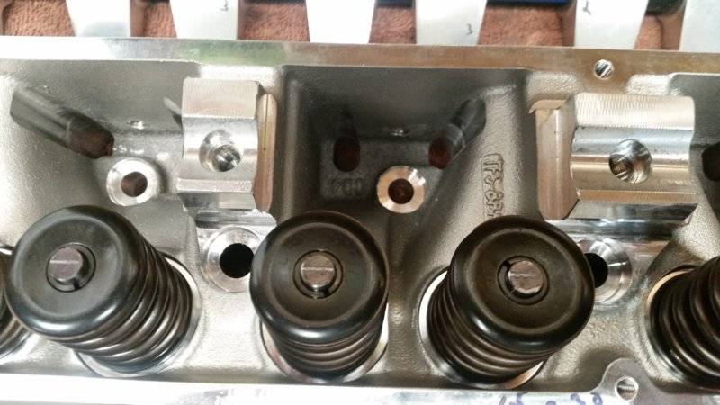

Wagonman, AFAIK that looks PERFECT to me, but I don't know much.Here you go Wrmryder. This is on the bench, checking the rockers centered on valve.
