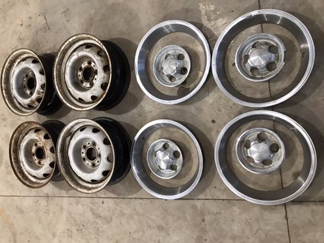

I think they are Rallyes? 14” rims
They were on my ‘67 Charger when I got it. Just wondering what years/models they would have came on originally.
1CECB053-A254-455F-B58C-454A00987AA1.jpeg 725A8B02-E299-498F-8859-31335E6A9298.jpeg
They are 72 and newer center caps.
72-74 RR, Challengers, Barracudas, some A bodies. Widely used throughout the Mopar world.
What's the bolt pattern? 4" or 4.5"?
Based on the center caps my guess is 4.5 but since they were on a "67" it's worth asking.
I would switch these rims that had "okay" tires with the Magnum 500s that had "good" Eagle STs on my '70 Road Runner depending on which one I would be driving more. I would say the 4.5 bolt pattern.
Anything from a 1970 A, B, E body through Aspens and Volare's.

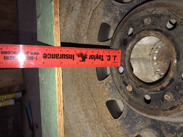

I was measuring my Rallye wheels last night to determine what size mine are. Mine are 14x6, with an overall rim width of 7”.
Your overall width is 6.5”, so your rims are 14x5.5. If they were mounted on your Charger they must be big bolt 4.5” pattern. And yeah 72 and later center caps.

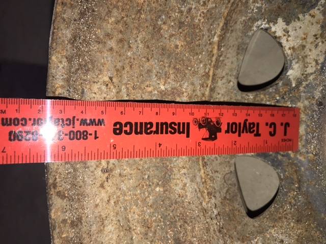

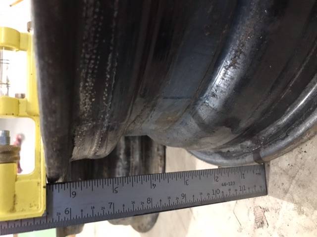

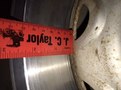

I’m curious, what is the overall width of your trim rings? And wheel backspacing?
These pictures should give you the answer.
1CB1788B-83E9-49F4-B63B-04C8EEC1244A.jpeg 153A0B89-D3C8-43E8-ACCC-058AF5E1BE93.jpeg 9F099E83-C4DB-4957-98DA-864060138337.jpeg
