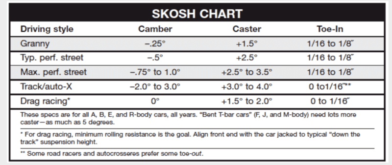

These are the specs I will try to achieve:

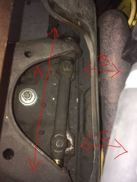

Thanks for all your help. I studied all the Manuals, but on my 73/74 Charger it looks slightly different and in the Manual for my Build-Year there are not pictures.
So just to be sure. With the screws A, B and C on the picture I can aligne what exactly?
Sorry for so many maybe stupid questions and thanks in advance....
A are shaft bearing for the upper control arm. Nothing needs to be done there unless there is other movement other than rotational.
B & C will be used to set caster and camber.
Set caster first and camber last.

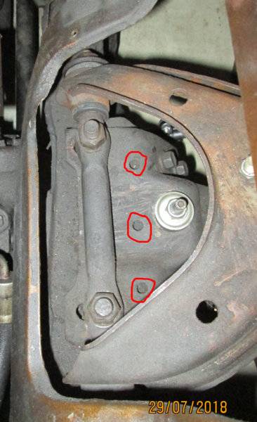

I have last question. What are these three holes for? Is there a tool or something that I can jam in there? Because when I try to caster and camber, it takes me a lot of force an I have to use a crowbar to move the alignment. Shouldn´t it go a little bit easier?
The holes are for the tool. I've done plenty of them. You can do it without the tool. The tool hooks over the upper control arm shaft so you can pull on the shaft. This will pull the arm outward. Tips and tricks; NEVER loosen the bolts with the car setting on the tires. Jack the front end anywhere but the outer control arms. This will let the suspension drop taking the load off from the upper arms. Now crack the bolt loose 1/4-1/2 turn on the end (front or rear) that you do NOT want to adjust. Loosen the opposite bolt and move the arm. When jacked up correctly, it moves easily with a pry bar. Now tighten it all up. Lower and take a caster/camber reading. If it's not correct, repeat the procedure. If you loosen the the bolts with the car setting on the wheels, the control will pop inward to the end of its travel. If you loosen both bolts the arm will slide around and you will loose any idea of where your current specs were. These can be difficult to master. However someone that knows them, it's piece of cake. I've reset many where somebody "lost it" on the adjustment.

Thanks. That already helps me a lot. What I still could´t find is a picture that tool or even better a way to get it? Is there a store where I can purchase it? Ebay? Or is it possible to build it myself? If yes I would need to know how it looks. Or maybe someone here in the forum has one to sell....
I have the tools. When it's jacked up they are unnecesary. More trouble than they're worth. It's a hook that goes over the shaft. This is connected to a long handle with a pivot pin. At the bottom of the handle there is a pin. The pin. goes into the hole in the frame behind the shaft. When it's installed the pin in the hole gives you leverage to pull/push on the control arm shaft.
Doug
Good thing someone has them. Should not be to difficult to make if memory hasn't failed me.
