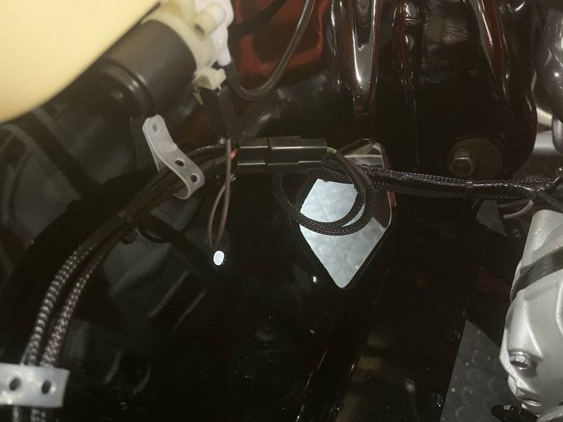

Under hood wiring is all done, now I need to find battery cables. I’ll probably have to make the positive cable, unless someone can recommend a factory cable that will work on a mini starter.

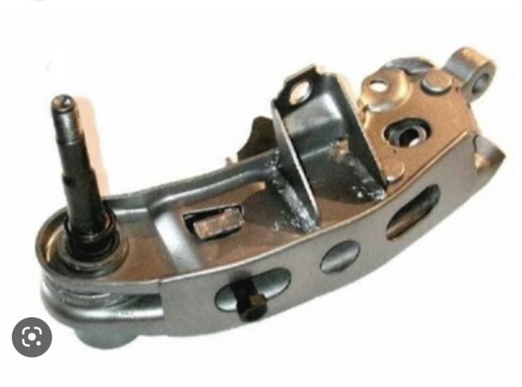

Between meetings I snuck out to the shop and used the press to install the LCA bushings and shafts, hopefully the Cosmoline I ordered a week ago shows up soon…

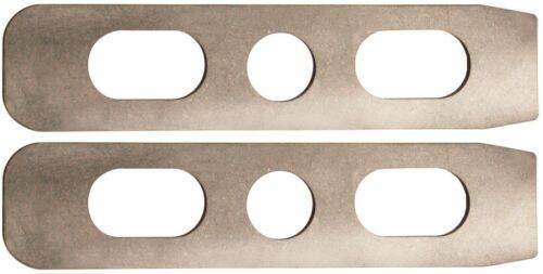

Are you going to weld stiffening plates to the lower control arms?
I bought a set, but I never welded them on. But I’ve seen a lot of people add them.

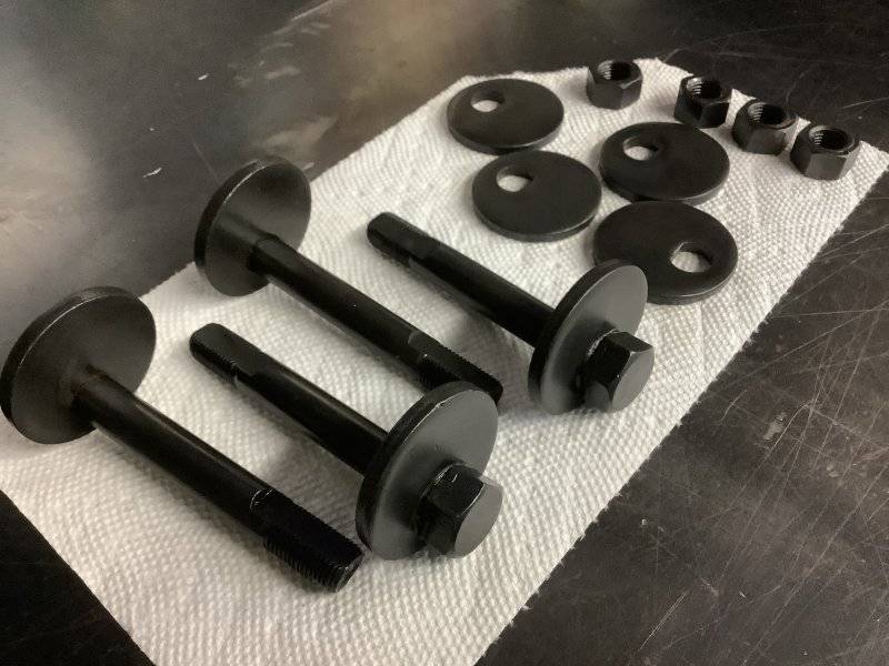

Tonight I’m removing the factory UCA’s and getting the eccentrics in black oxide. Before putting the front suspension back together I’ll clean up the inner fender wells a bit…

That is super sweet looking and the coating should last a long time.
They will probably outlast me with minimal care.
I still have to do a batch of hardware, most of it is small stuff that would take forever to wire wheel. I'm going to try some Black Diamond sandblast media in a vibratory tumbler. I tried crushed walnut shells but it didn't do much...
