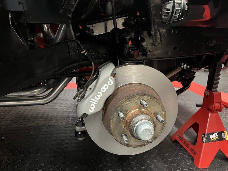

Trans mount is done. After installing some new Timken bearings I put the rotors on. I set the bearings @ .001 end play with a dial indicator and buttoned up the wheel ends.
I bolted the calipers on and the wheel ends are finished.

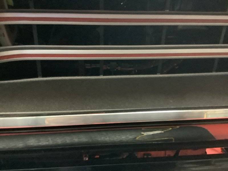

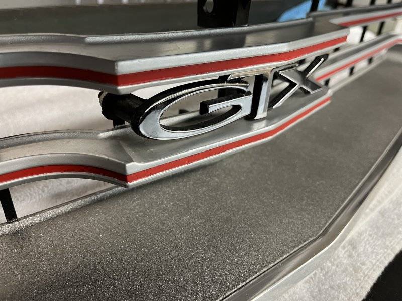

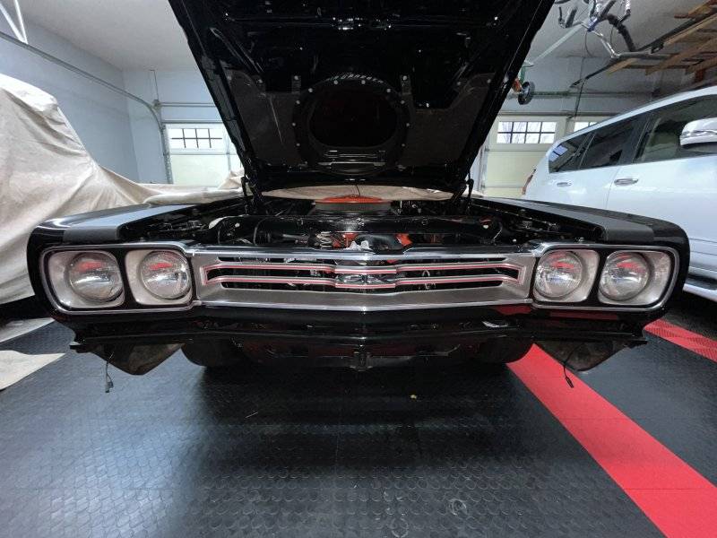

The red stripe on the grille is getting thin in spots, before bolting it back on the car it’s going to be repainted.

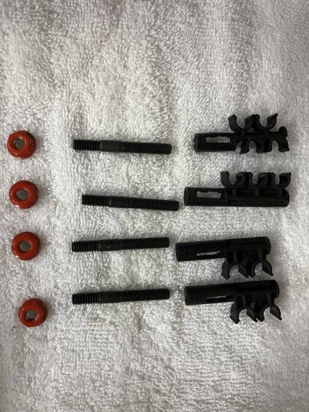

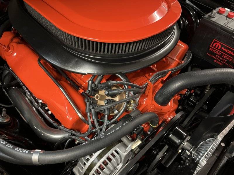

Plug wires should be pretty easy, although I may have to replace a couple now that I have the factory plug wire retainer on the thermostat housing.

The plug wire retainers are from a mid ‘90’s Ram 360 engine. I ended up making new studs out of 1/4-20 ready rod to get the length I needEd.
The studs replaced standard valve cover bolts along the bottom.
The retainers are ribbed inside so they grip the stud

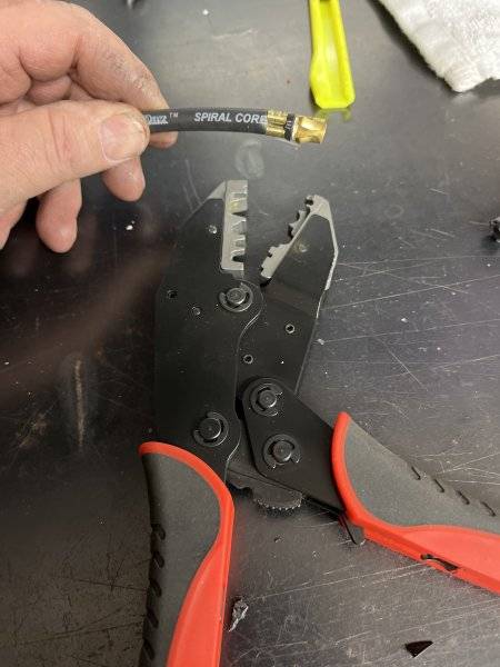

If you don’t have a ratcheting crisper, you should. Easy to use and makes a perfect crimp every time.

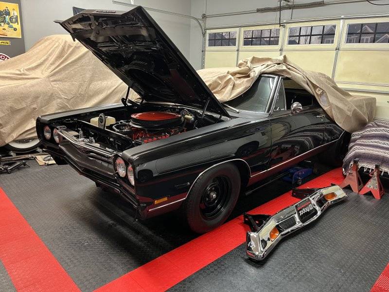

I’m nearing the finish line so I started a list of things I need to do in order to get there. It consists of 27 tasks, some will take a few minutes and others are going to take several hours. There’s probably 20-30 hours worth of work left, working at a relaxed pace.
There is light at the end of the tunnel…

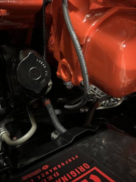

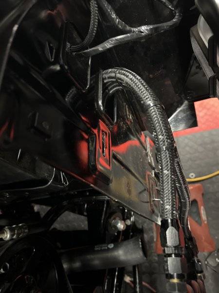

Got a few more things scratched off my list. I’m ashamed to admit it, but the converter bolts kicked my ***. I couldn’t get one bolt started and started to panic because I thought one of the lugs on the converter was messed up. I eventually got it, but I had visions of pulling the trans again. Late afternoon UPS showed up with my Summit order so I was able to get a good start on the trans cooler lines. I called it a day after fabricating some simple brackets to support the lines and keep them away from the steering and exhaust. I'll get back on it tomorrow when the paint on the brackets has dried. I used black AN hose and fittings so they should kind of blend in with the surroundings.

Cooler lines are done…
The plumbing is a lot less noticeable through the grille compared to the previous stainless hoses and red/blue AN fittings.
Looks like a clean install and those flexible lines are easier to blend into the surroundings than solid ones. I have the same plan for my Charger at some point but other things are first on the list. It is looking like you will be cruising down the road and laughing very soon and I am looking forward to that time.
