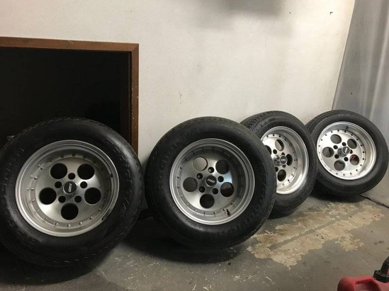

Pardon my ignorance I am new to car restoration my thing has always been motorcycles.
This is my first build and it is as stated a 73 satellite, stock.
Tires are rotted so I want to roll it around.
Someone on FB has a set of 4 wheels/tires for sale and there is a lot of information but I only know about 1/2 of it works for fitment.
Here is his text:
ENKEI 15 inch wheels 5x4.5 bolt pattern. I had them on a 1970 amx years ago. Exellent condition.
Tires 265/50/15 on the rear, Front 205/60/15 .
They will fit AMC, Ford, Chrysler. $ 750 .00 obo. wheels were made in Japan.
The boar in the back of the wheel is 3 inches in diameter
The measurement for front wheels are 7“ x 15. The rear wheels are 8 1/2 x 15.
Will these work and would they look decent? (haha, i know)
Thank you so much for any replies, see attached for a photo.
The wheels will fit but check the date code on the tires. If they are over 10 years old they are ok for the garage/driveway but I wouldn’t drive on them.

They will fit if they are indeed 4.5” bolt pattern, but the price is quite high for those rims, unless those are your dream rims. You can get some steel wheels and roller tires for about $100 just to roll it around.

The bolt pattern is correct for the aftermarket wheels I have. But the backspacing on the rears is -26 and the fronts are -7. Most of the Internet site show 4 1/2 inch backspacing.
My wheels have a negative backspace. Which will push the wheel and tire out closer to the fender lip. The wheels will my wheels have a deep dish to them.
You will need to know the backspace, especially for the rear. You will need about 4.5" on the back.

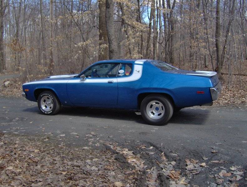

is that the care in your avatar? if so do you have a good sideview of high resolution you can post. that one is too tiny to get a good look.

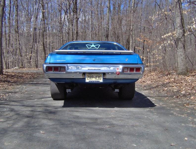

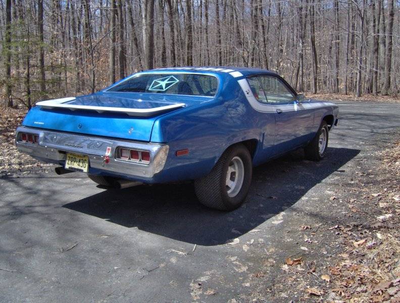

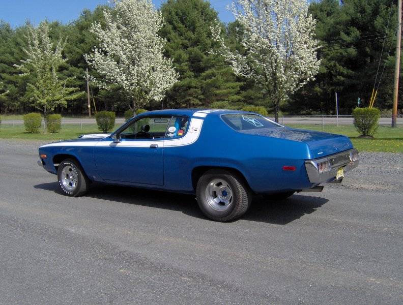

Yes sir it is! There are or were pictures in my photo garage. I can no longer find it since the software upgrade a few months back. However, any pictures of mine will not be of much help as my car has a narrower rear and offset spring hangers from it's drag racing days. The wheels on the rear are American Racing slots that I have had for 50 years. They are 8 1/2" wide & have a 3 1/2" back spacing if I remember correctly. The fronts are the newer style of the same wheel from same company. I think the fronts are 7" & have a 4" back spacing. Front tires are F-60 x 15" & rears are N-50 15". Aluminum slots are my favorite wheel & I found out recently, that American Racing just stopped making them. However, US Mags still makes them called the Indy Series, Thank God; as I want 10" wheels for the rear & 8"' in front. I will try to find a few pics of my car on the computer here, I am at work currently, lol!
fantastic! that is a fantastic looking setup. thank you.
