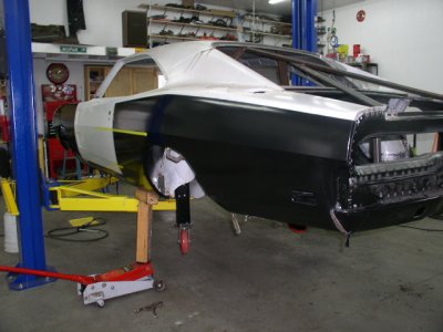

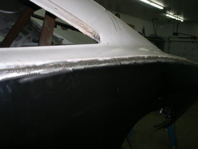

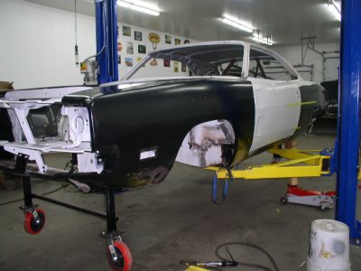

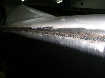

This sucker is actually starting to look like a car again. Put on both front fenders, doors, front valance, and grill support to make sure everything would be in adjustment range and that the body lines of the door matches the quarter. The pie shaped piece near the rear corner turned out great. 7' feet 3 inches of stitch weld later the top of the quarter is rough welded on. Just have to finish the wheelwell area and this side is done.

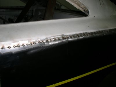

Looks great! Good work, you have way more energy than me. It appears you butt welded the quarter skin at the top seem. I thought flangeing was the way to go there. How did you hold each of the edges straight preweld? What are the pros and cons to each way of attachment? Anyone?
We did butt weld it about 1 inch down from the top corner. I think the flange method would be easier, but I did'nt want to take the chance of moisture getting between the metal and rusting. Also I thought it would not be possible to hide the seam in the trunk if a lap joint was used. We started at the door jamb area and worked back. First with a spot every 8 inches cutting the gap as we went and using one of those butt weld spacers farther down the seam to hold it even. We did have to go back and recut a couple of the welds to compensate for the metal movement on such a long seam. I can't say enough good things about the kid helping me. Very meticulus and precise. I could never weld as well as him.

Looking really good! Butt welding is the hardest to do, but, yields the best results, and the easiest to F up too!
Exactly what the kid said. He would tell me exactly what the metal would do after just one tack and he was right. I think this is quite important - to know what is going to happen as the tack process continues. I was surprised how much the metal moved from even minimal heat. It would be very easy to ruin a new quarter if you are not extemely careful. I am more than happy with the results though.
that is how i hang my quarters. it is the only way to do partials and blend the right.
