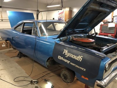

Well, I’ve had much progress since I last posted here. Let’s see...
Frame stub repair...DONE
New floor pan...DONE
All brake and fuel lines...DONE
All new brakes....Done
New Clutch...DONE
Trans inspected and reinstalled...DONE
Rear end opened, cleaned, inspected, new fluid and buttoned up...DONE
Heater box dropped, cleaned, pressure test core, reinstalled...DONE
Next up....new plug wires, positive cable, headliner, carpet, radiator flush, exhaust...soon!

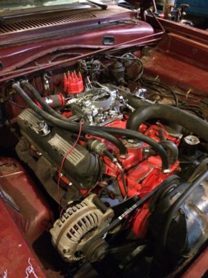

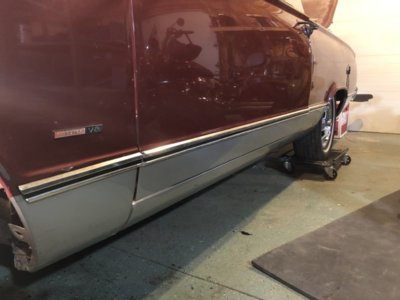

I’m also working on the little Signet today, trying to get it back together and off to its new home. Side trim back on, wheel lips next. Tomorrow will be the carb and the rest of the ignition system. Hoping to have it running by Sunday night.

Is that a factory 4 barrel Signet?
I've only ever seen a few of those.

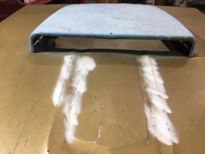

I decided to put a screen/grill on my hood scoop, I've had enough debris fly at my windshield to want to protect what's under my hood as the opening is large enough to let something in.
https://www.customcargrills.com/Diamond-Grill-Mesh.asp
6"x36" sheet, cut to size. That gives me enough for a second attempt if I need it.
Even though I made a cardboard template there was still a fair amount of cutting to size as the inside of the scoop is not all that uniform in shape and the mesh will need to be altered all around on each opening.
It was my plan to use rare earth magnets to hold it in place as they have a strong connection but they don't stick, so I may use a 2-part epoxy even though I wanted to be able to remove it.. I'll figure it out.
I like the way it looks though.
Well the magnets won't stick because it's aluminum but before you epoxy the mesh into place, consider using that epoxy to stick the magnets to the edges of both the mesh and the scoop opening.
It does look nice.
It does look nice.
The original material I was going to use would've worked with the magnets, when I came across this I liked it more as it was a more finished product. I think I'll use the epoxy and shape it on the sides and bottom so it can be pushed into place and "lock" in, then bent slightly and lifted if I want to get it back out. If that proves to be to difficult then I may just do it in key spots so that I can cut it out if I need/want to.
