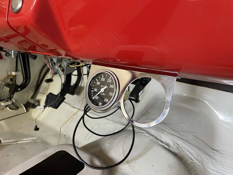

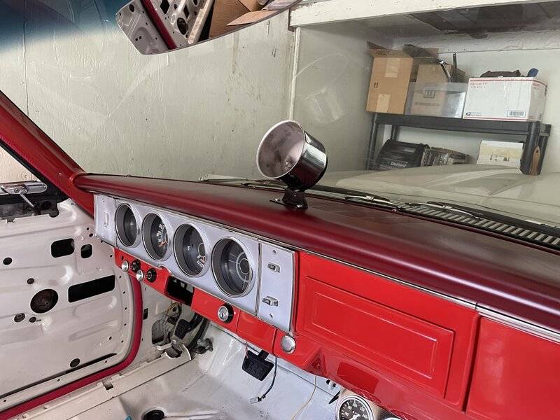

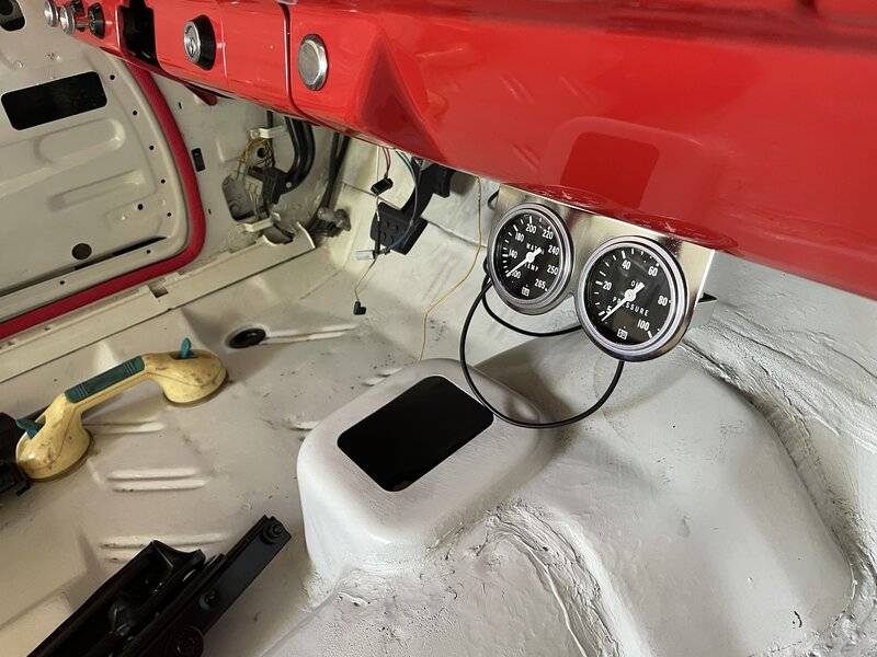

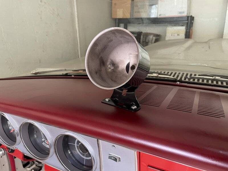

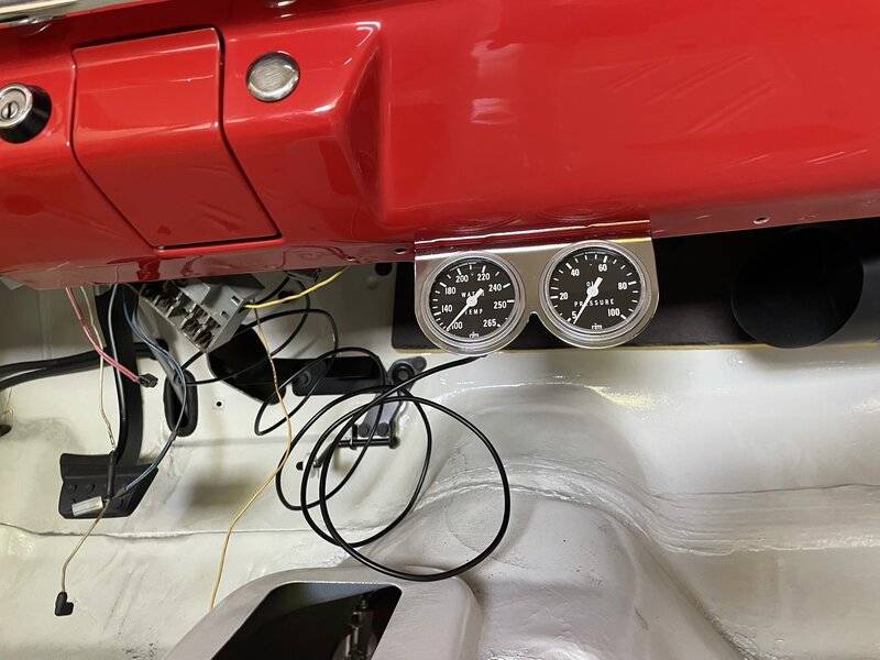

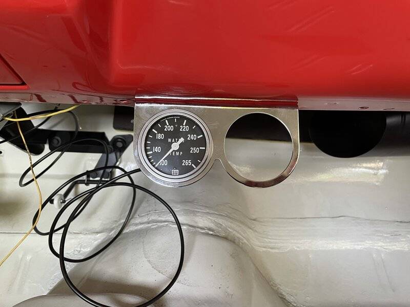

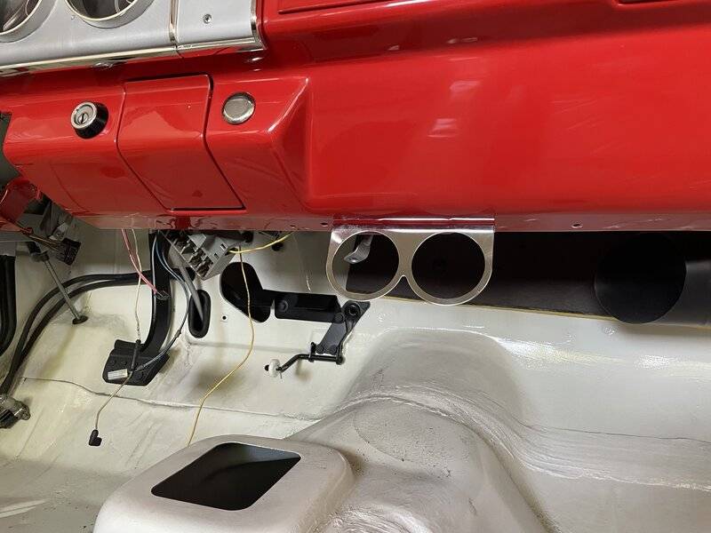

Got the Tachometer Cup mounted on the dash. Also mounted the Stewart Warner gauges on the lower part of the dash.

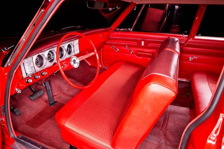

Chuck Marshall...Here is a picture of where the choke cable goes on the lower left hand side of the dash. Last chrome knob on the far lower left side in this picture.
I hope that this will help you.

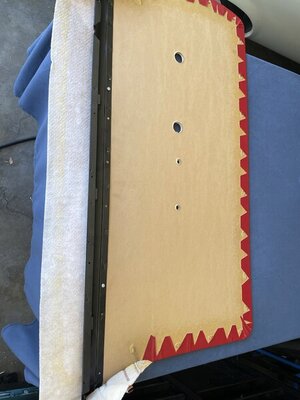

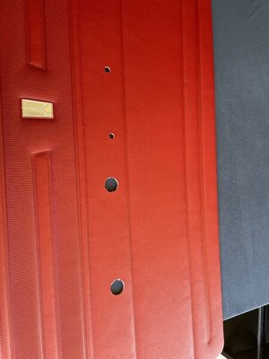

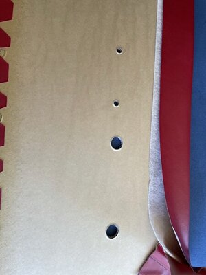

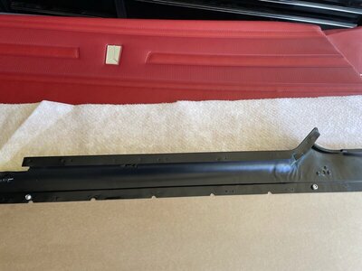

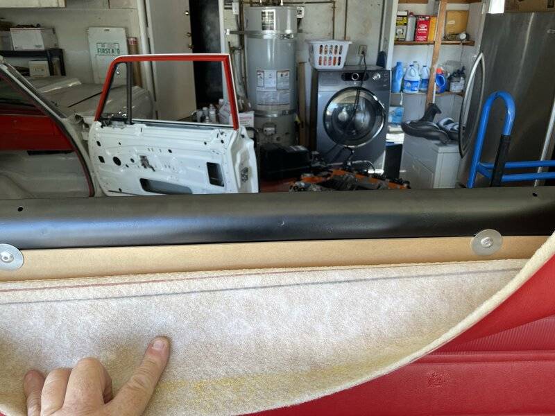

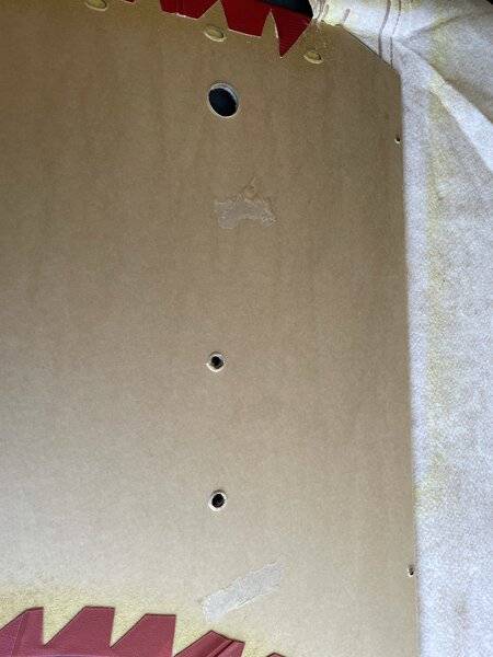

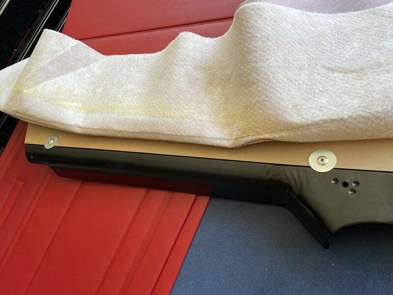

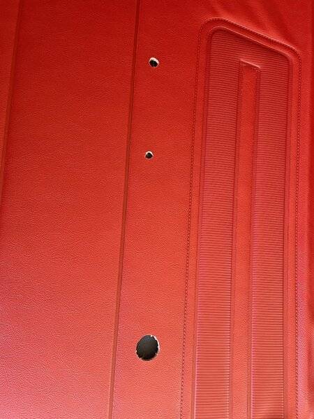

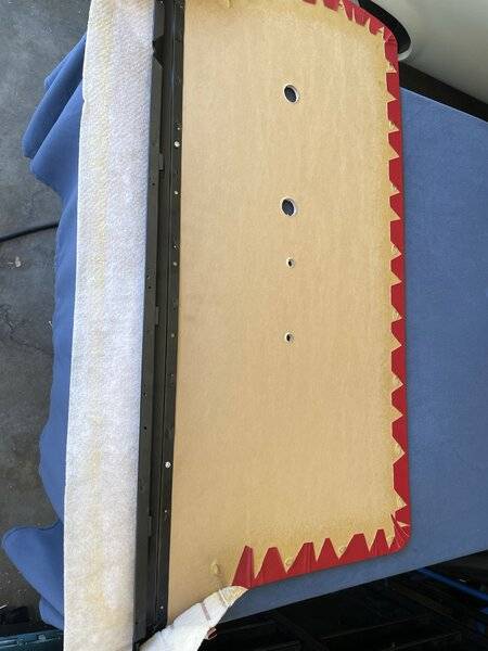

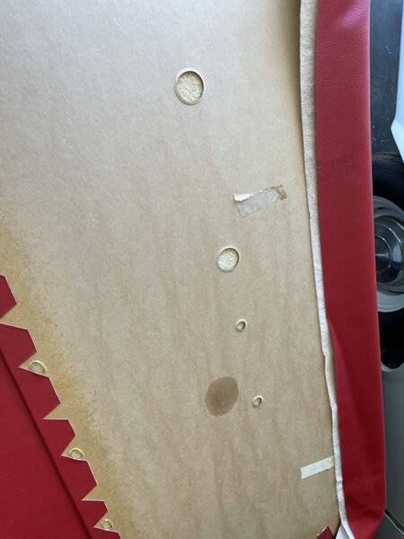

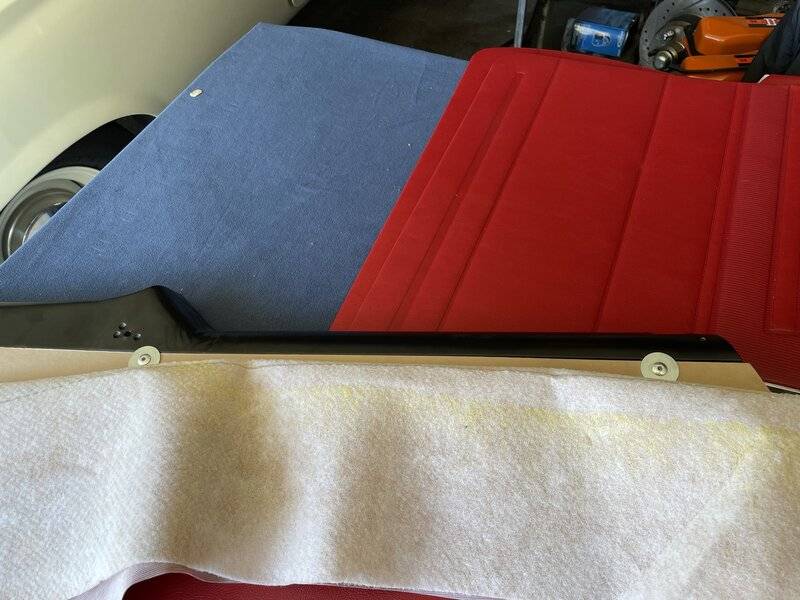

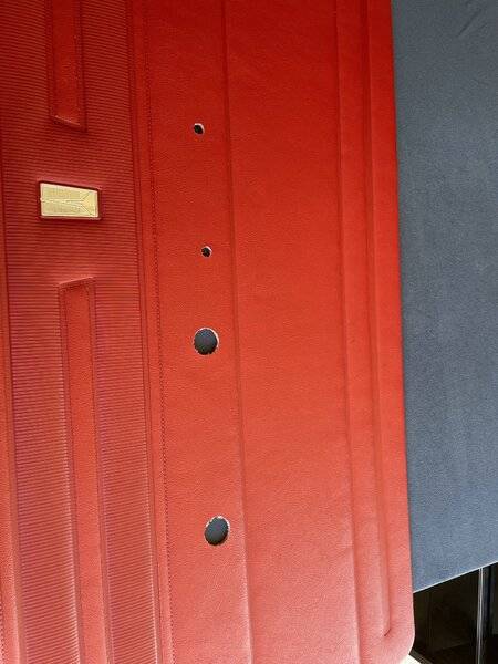

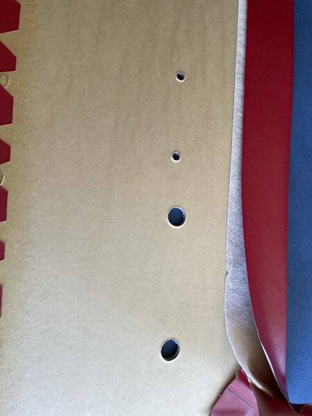

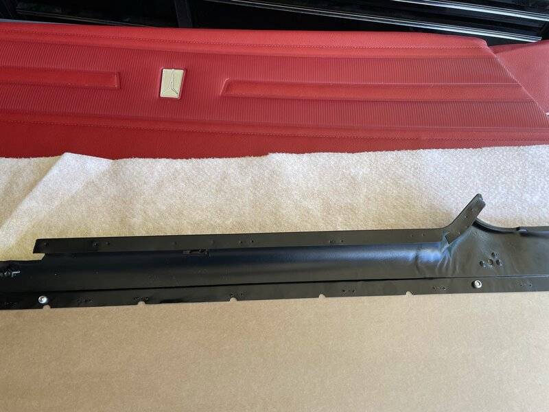

Working on getting the door and rear quarter panels mounted on the top frames, cut the holes for the arm rests and handles. Ordered fabric as well from SMS for the seat covers, want to do the rear seat first.

Super Stocks were arm rest delete, I made the same mistake.
Hi Steve, The information I'm finding is Factory installed Equipment was Savoy Only Arm Rests with ashtray code 418 with the Maximum Performace Engine Package. Do you know of the information regarding a Arm Rest Delete option? I do know Max Wedge Cars had stock interior arrangements where as the Hemi Engine Cars had the rear seat delete and A100 front seats. Unless I'm wrong?
I have the Jim Schild, 64 Authenticity Guide and the Jim Schild Larry Griffith Guide also. I'll do some looking and let you know what I find.
Turns out per their books, only SS 64 Hemis had arm rest delete. 62-64s were stock interiors per model.
Chuck Marshall...on the arm rest issue...both of my 426 Max Wedges, 1963 Plymouth Savoy and my 1964 Plymouth Belvedere came with arm rests from the factory.
I hope that that helps.

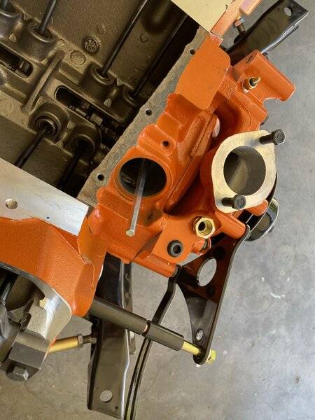

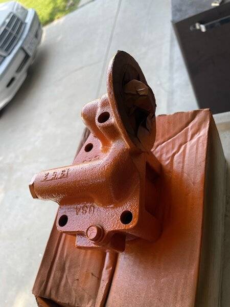

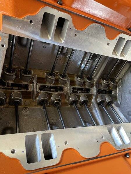

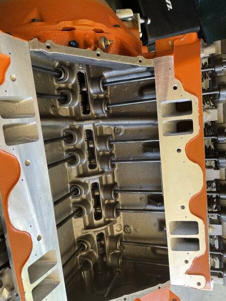

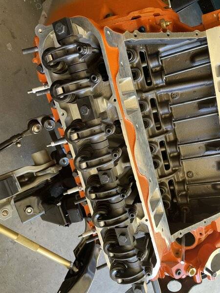

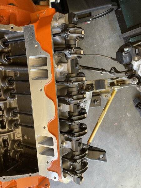

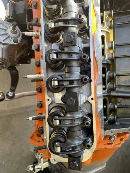

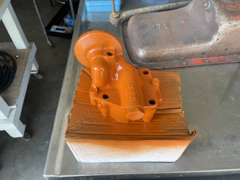

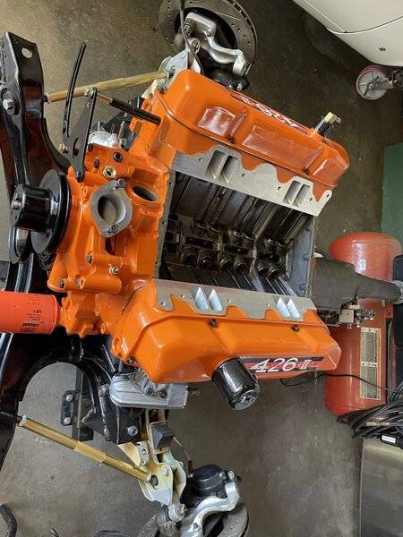

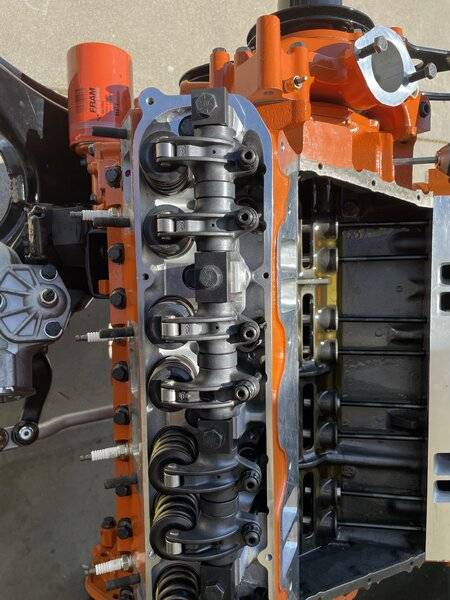

Went with Comp Cam Magnum 1.5 Roller tip Rockers. The engine has a Flat Tappet Solid lifters also by Comp Cam. Had to go with Comp Cam Magnum pushrods with a 9.130 length to get the right rocker arm geometry. Painted the oil pump(High Volumn) melling and mounted. Got a 5/16 hex stock to prime system and check rocker arm oiling. Will do that when I get the oil and filter. Going to run Comp Cam break in oil 15/50 with a Fram racing HP filter.
IMG_1997.jpg IMG_1998.jpg IMG_1999.jpg IMG_2001.jpg IMG_1972.jpg IMG_1973.jpg

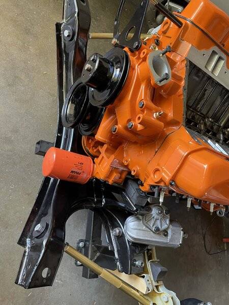

Mounted the oil pump, filled the filter with oil. Got the Comp Cam Break in oil 15/50. Went to the hardware store and got a paint mixer for a drill(it's 5/16 Allen which is what the size is for the oil pump drive) removed the mixing blade and had a long Allen stock. Wrapped electrical tape around the stock where it would ride at the distributor bushing to keep from hitting it. And ran it with a drill tell oil feed the rocker arms and ran down the valley. Worked out good so torqued the valve covers down and now waiting on the intake bolts to torque that down. I'll keep you posted
IMG_2002.jpg IMG_2003.jpg IMG_2004.jpg IMG_2005.jpg IMG_2006.jpg IMG_2007.jpg
Did you rotate the crank slowly while spinning the pump?
