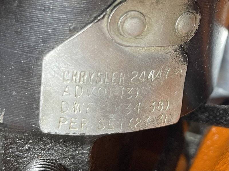

Chuck do you have a good legible photo of your distributor tag?
Here you go

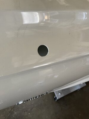

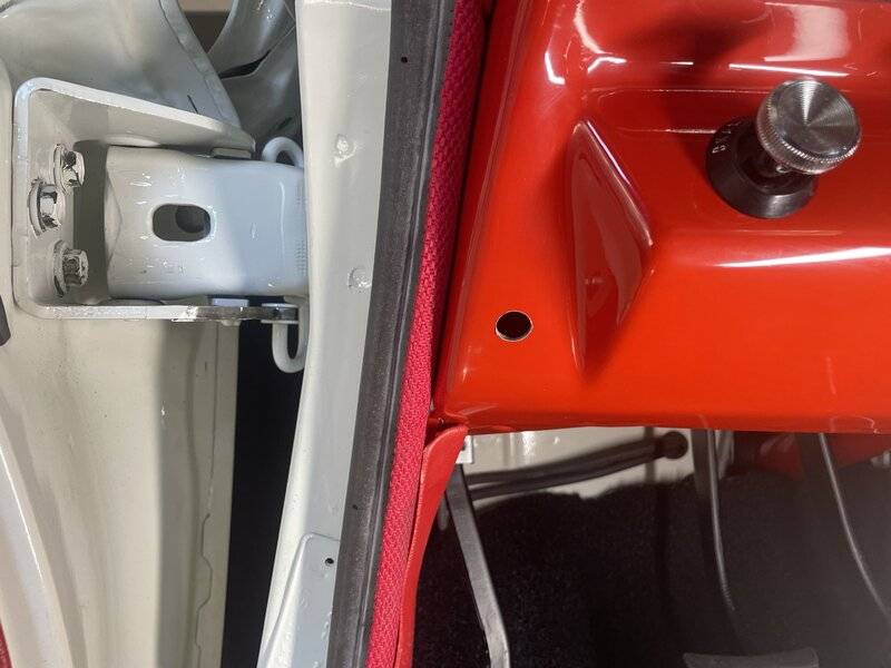

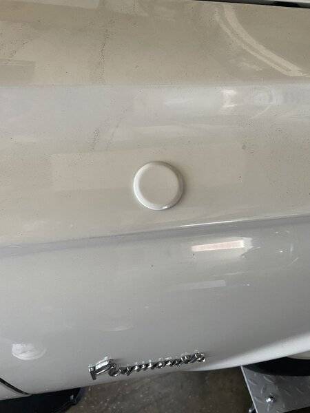

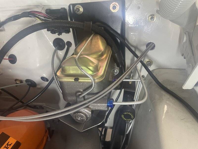

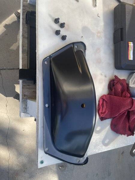

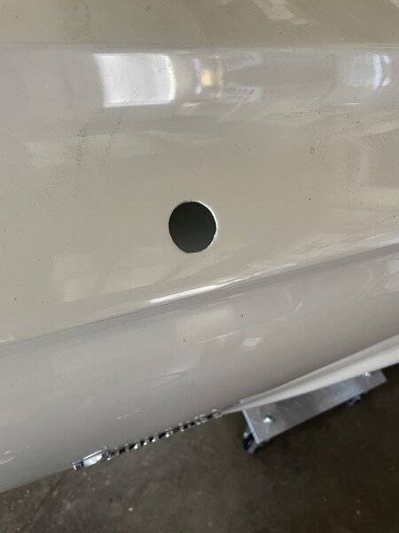

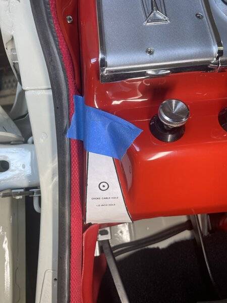

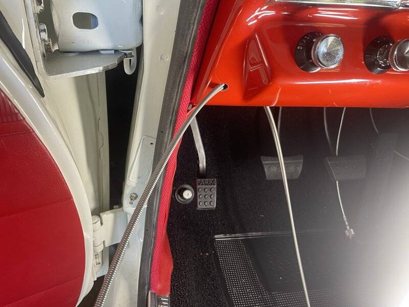

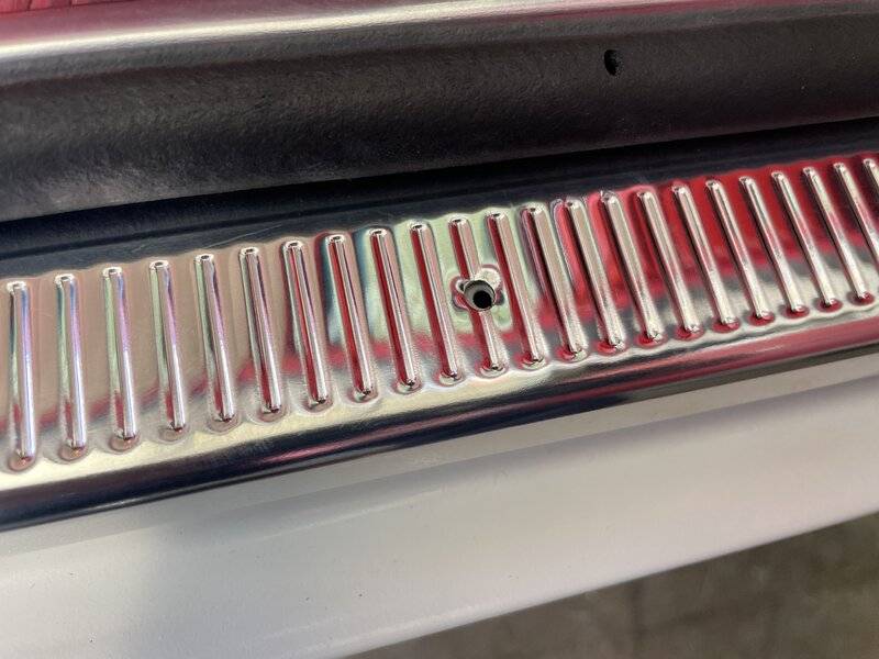

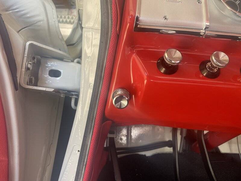

I went to a electrical supply store (not Home Depot or Lowes lol!) and got a oil tight hole seal for a conduit box. It came with primer. I scuffed it and painted it with my left over body paint and clear. Fits nicely over the antenna hole. I also plumped the vacuum line from the engine to the push button switch and the to the opening and closing of the fresh air door on the passenger side. Works great. I’m going to run a vacuum check valve on the vacuum feed line and a small inline fuel filter to act as a vacuum reservoir so it can open or close with the engine not running. At least once or twice any way. I’ll see.

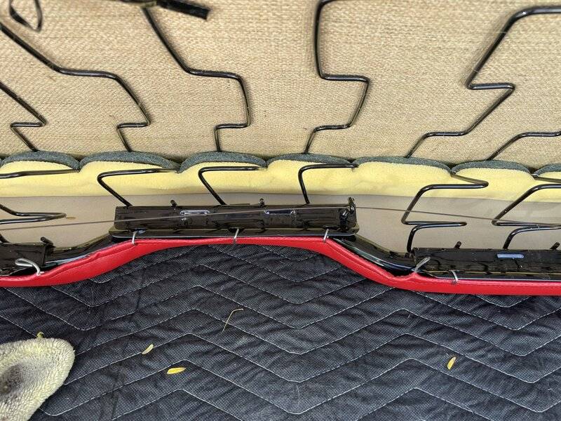

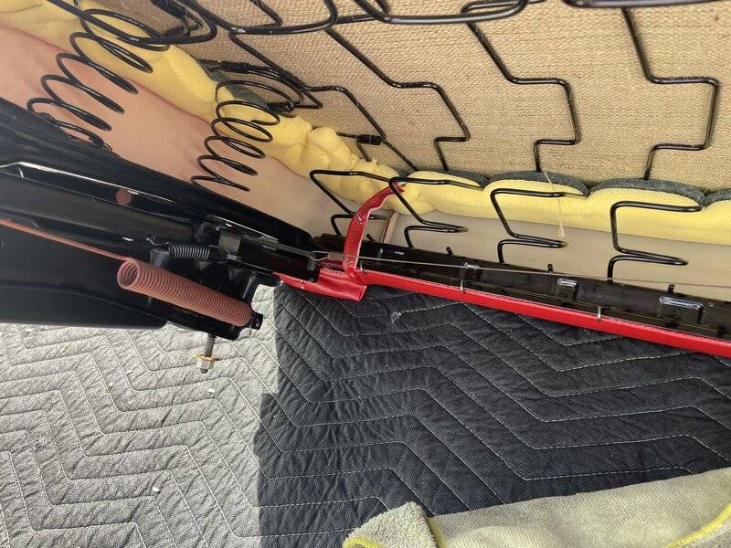

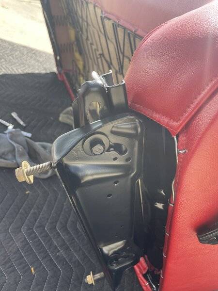

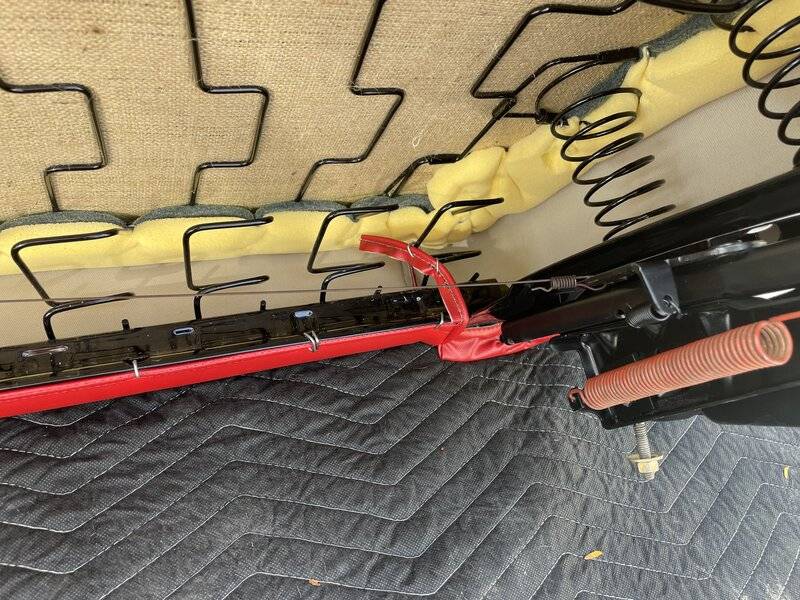

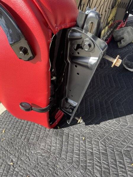

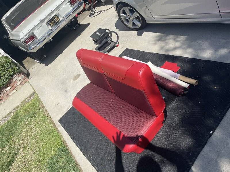

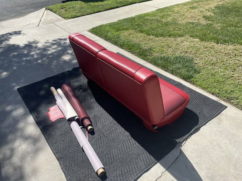

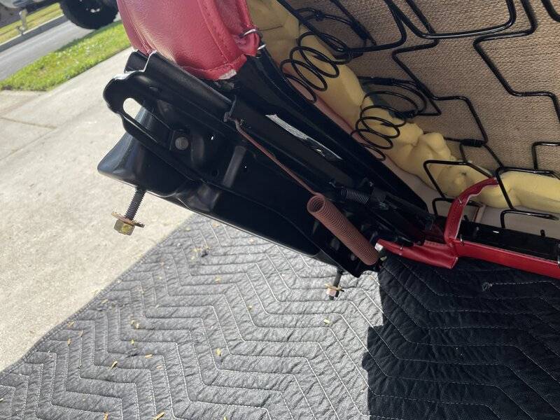

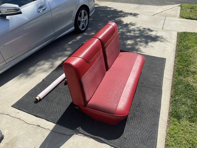

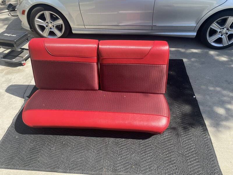

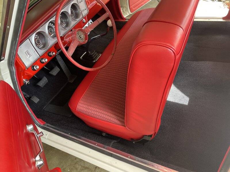

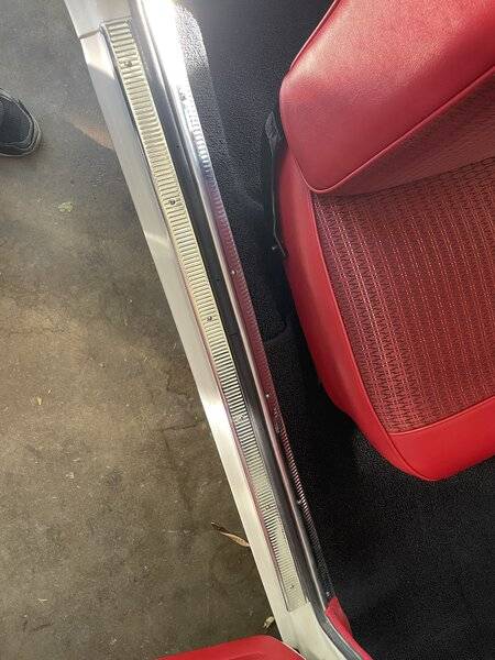

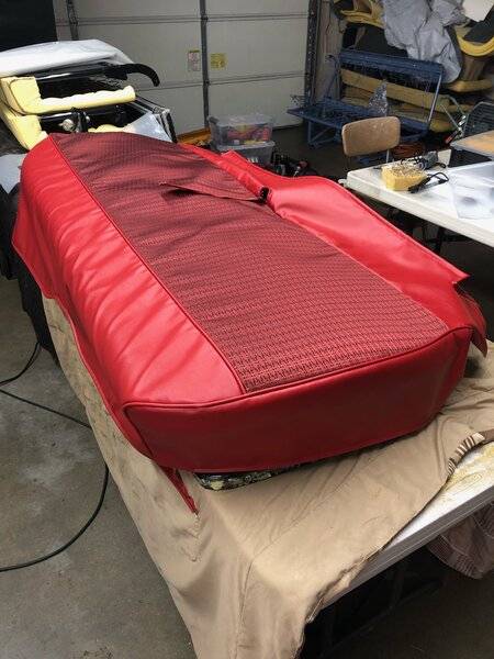

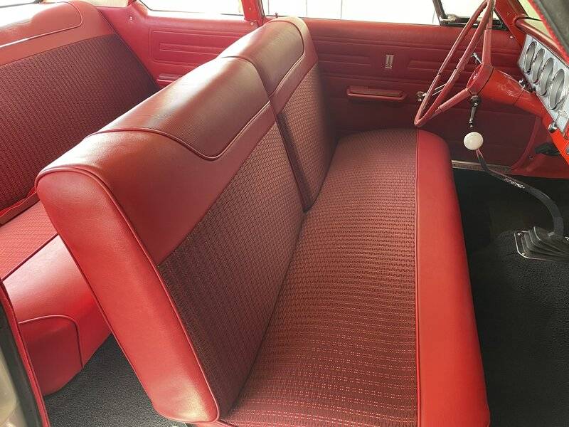

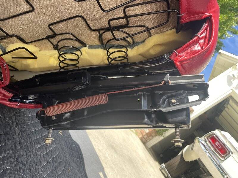

The rails have 3 positions to adjust the seat for I guess people of different heights. It was the best with the front of the rail in the middle position and the back in the lower position.

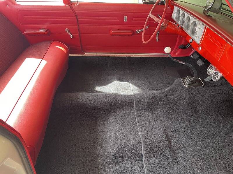

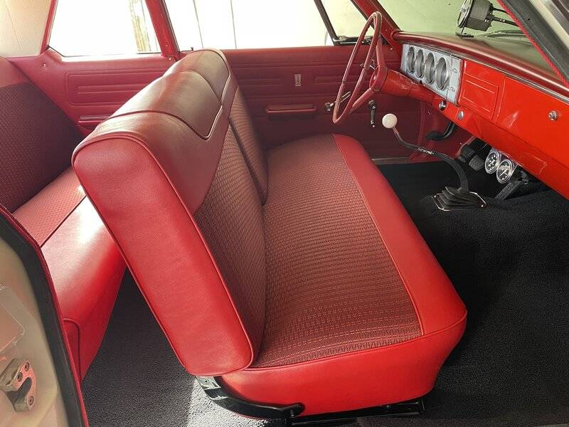

27CBB012-193A-4882-B1B3-E2D6A83B3E25.jpeg 7C2A5CB7-64E0-43A6-B68E-031C825B554C.jpeg 13848352-2D0F-4DFB-ABE9-07A00743383C.jpeg 9C8C3F56-CCD5-4F5F-827D-3DD284F1826D.jpeg C427C7B6-7BCC-4AA6-A97F-A1E6F3EB275D.jpeg 117C1A13-EFB0-4D39-88CE-D7F8D33FA4BD.jpeg

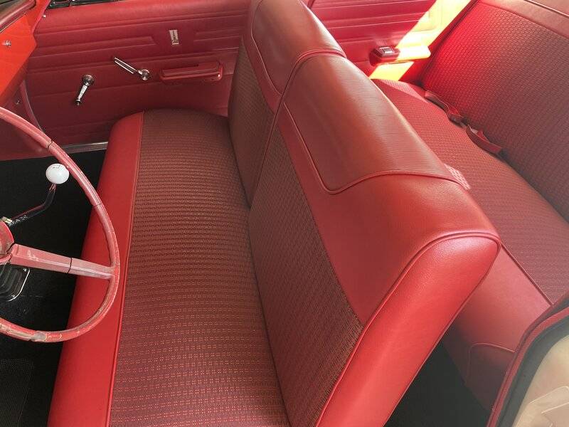

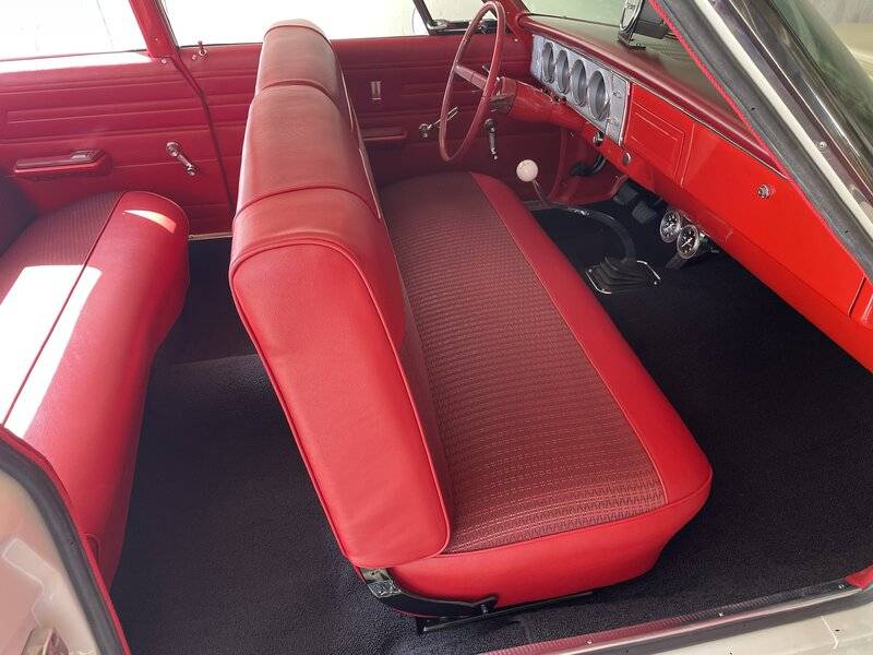

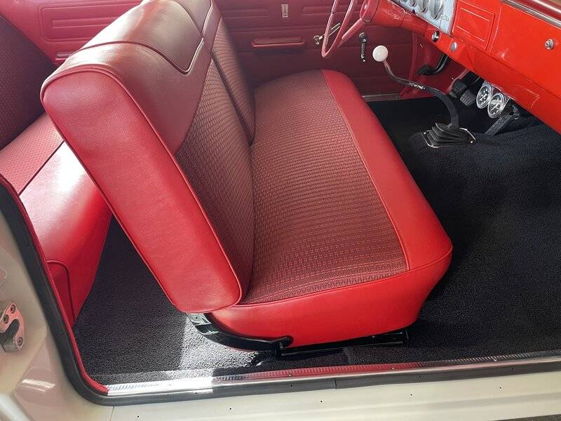

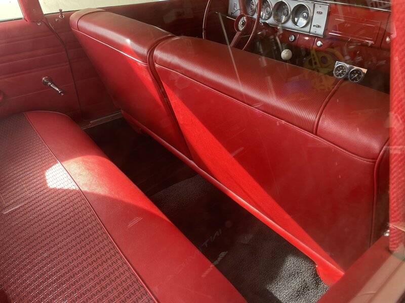

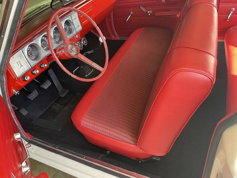

a white car with red interior or a red car with white interior both look like they belong together
I went to look at a guy's cuda back in the day, and turned out it was a black 6pack car with red interior. Just an absolutely beautiful car. Wish I'd have bought it and held on to it.
