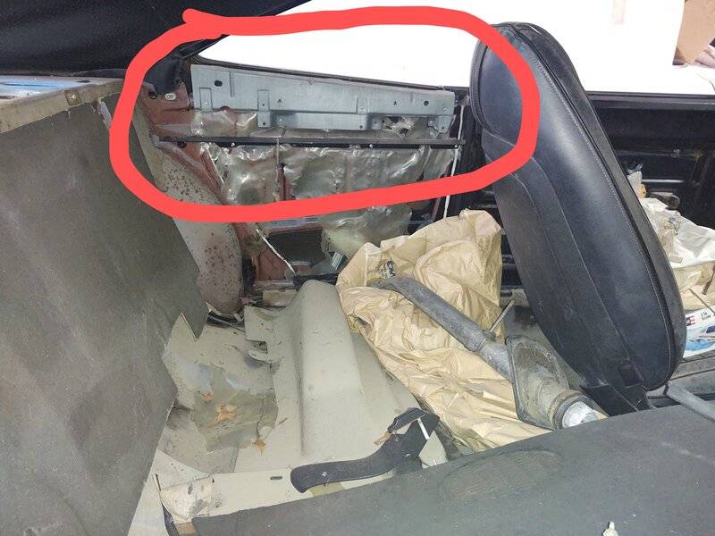

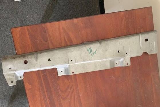

I just purchased a 70 Charger that was in pieces and not bagged and tagged. I'll have a million questions, and for no good reason, lets start with this one. Left and Rt hand piece, where in the interior does this go?
Looks like the interior window sill for the rear, side windows.
My rear window sill on driver's side:

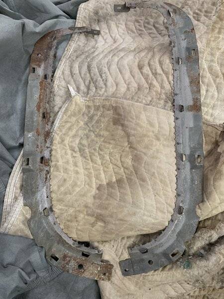

Thanks for that info, I got that put aside. Now, how does that plastic back window interior trim attach? It looks like it uses the pinch weld, but it seems back wards. Pics? Thanks
Mine are out (i.e., no pictures), but going from memory the lower corner pieces are held in by small screws. The upper corner pieces are probably held in place by screws too, but I don't remember.

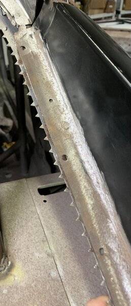

I got it figured out. The trim goes on these headliner cleats after headliner install. They were in one of the many boxes. Plus the rail that runs behind the package tray
